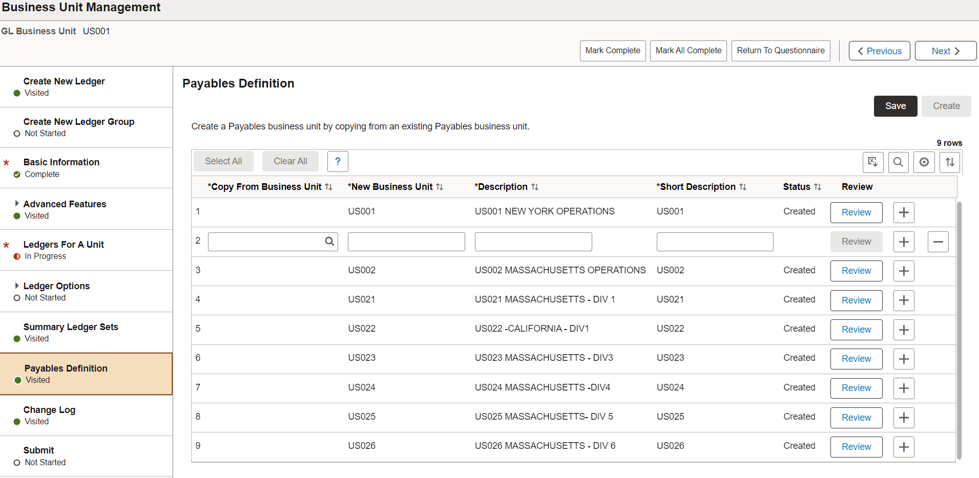

Payables Definition Page
Use the Payables Definition page (AP_BU_COPY_FL) to search, modify, add, and copy Payables business units.
Navigation
PeopleSoft Home, and then Finance & Accounting, and then Business Unit Management tile, and then Create New Ledger, and then Basic Information, and then Payables Definition
This example illustrates the fields and controls on the Business Unit Management - Payables Definition page.
Payables Definition
Field or Control Description
Copy From Business Unit
Enter an AP business unit from which the new business unit will be copied.
New Business Unit
Enter a name for the new AP business unit.
Description and Short Description
Enter a description and a short description for the new AP business unit. These are mandatory fields.
Status
Displays the status of the AP business unit. The available options are:
  • Initiated
  • Created
Create
Click to create a new AP business unit.
Review
Click to update the Payables Definition and Procurement Control options. Review button is available only after the AP business unit is created.
For more information on Payables Definition page, see Defining PeopleSoft Payables Business Units. See Defining Procurement Controls for General Ledger Business Units for additional information on Procurement Control page.

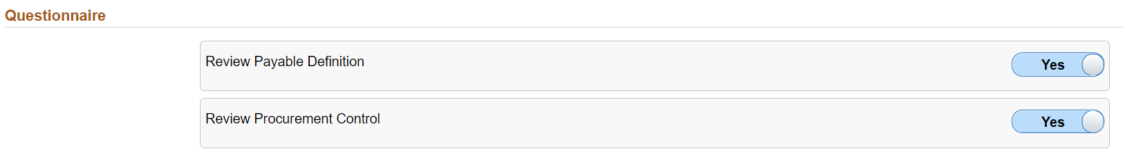

You can use the Questionnaire page to answer the first set of questions that determine which steps are displayed in the activity guide.
This example illustrates the fields and controls on the Questionnaire page.
Questionnaire page
For more information see, PeopleSoft General Ledger: Questionnaire Page

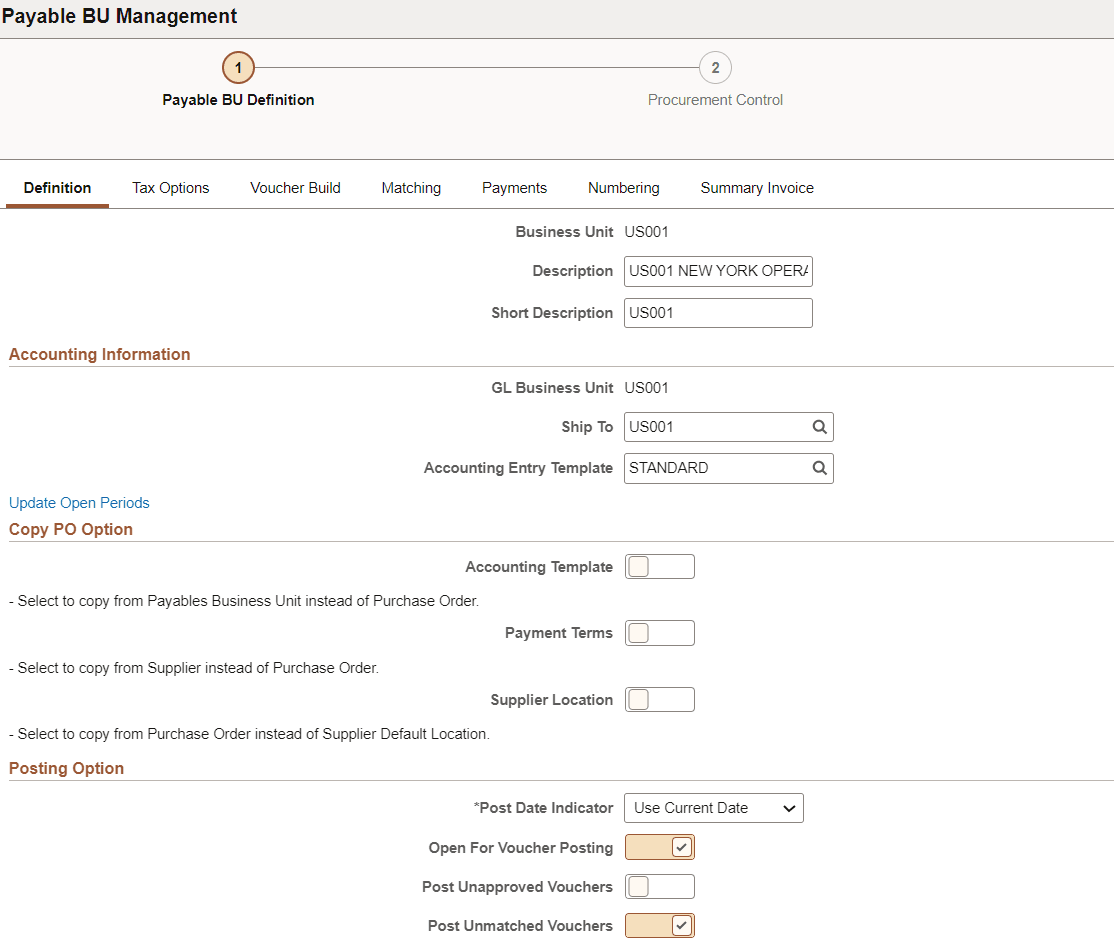

Business Unit Definition Page
Use the Business Unit Definition page (BUS_UNT_TBL_AP1_FL) to create a Payables business unit.
Navigation:
Click Review button to update the Payable Definition.
This example illustrates the Business Unit Definition page.
Payable BU Definition
See the Payables Definition - Definition Page for field definitions.

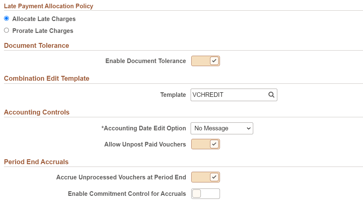

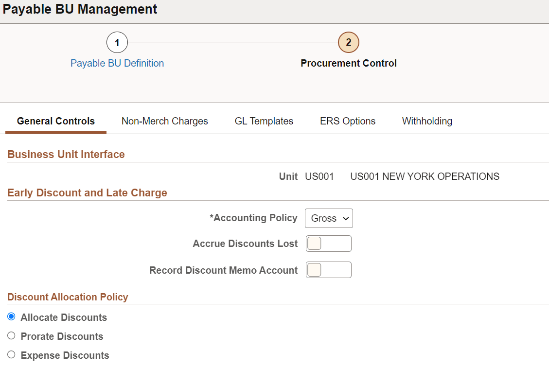

Procurement Control Page
Use the Procurement Control page (BUS_UNIT_INFC1_FL) to define the procurement controls.
Navigation:
Click Review button to update the Procurement Controls.
This example illustrates the Procurement Control page (1 of 2).
Payable Procurement Control (1 of 2)
This example illustrates the Procurement Control page (2 of 2).
Payable Procurement Control (2 of 2)
See the Procurement Control - General Controls Page for field definitions.
For field definitions of the other tabs, see the following:
