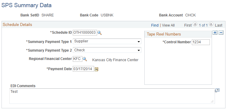

This example illustrates the fields and controls on the SPS Summary Totals page. You can find definitions for the fields and controls later on this page.
After you receive data from the Department of Treasury, use the SPS Summary Totals page to enter the payment information that you will use to create the SF1166 Summary Certification file for each payment schedule. Only exceptions are discussed in this section.
Schedule Details
Field or Control Description
Schedule ID
Select the schedule ID from the list that contains all SF1166 and PAM file layout codes.
Note: The field values for Summary Payment Type 1, Summary Payment Type 2, Regional Financial Center, and Payment Date are all displayed based on the schedule ID selected.
Enter a regional financial center. The default is Kansas City Finance Center (KFC).
Tape Reel Numbers
Control Number
Enter the control number provided by the U.S. Treasury.
