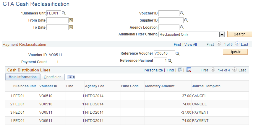

CTA Cash Reclassification Page
Use the CTA Cash Reclassification page (AP_PARTIAL224_PG) to review the payment reclassification and cash distribution detail information.
Navigation:
Accounts Payable, and then Review Accounts Payable Info, and then Vouchers, and then CTA Cash Reclassification
This example illustrates the fields and controls on the CTA Cash Reclassification page. You can find the definitions for the fields and controls later on this page.

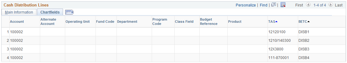

This example illustrates the fields and controls on the CTA Cash Reclassification page — Cash Distribution Lines tab. You can find the definitions for the fields and controls later on this page.
CTA Cash Reclassification page Chartfields tab
Search Criteria
Field or Control Description
Business Unit
Enter the PeopleSoft Payables business unit of the voucher. This is a required field.
From Date and To Date
Enter a single date or a range of dates. If you select Reclassified Only from the Additional Filter Criteria, the system compares against the accounting date of the payment and if you select To Be Reclassified Only, the system compares against the accounting date of the voucher.
Voucher ID
Enter a voucher ID. If you enter a supplier ID, only vouchers for that supplier are available for selection. You can select only vouchers with a voucher reference associated with it.
Agency Location Code
Enter the numeric symbol of the U.S. Federal agency.
Select Reclassified Only or To Be Reclassified Only.
Reclassified Only: The system retrieves vouchers that have reference vouchers associated with them.
To Be Reclassified Only: The system retrieves vouchers that have no reference vouchers associated with them.
Payment Reclassification
Voucher ID
Displays the voucher ID of the cash reclassification transaction.
Payment Count
Displays the payment schedule count of the voucher selected.
Reference Voucher
Displays the reference voucher ID, if applicable. You can enter a reference voucher ID to retrieve cash accounting lines for the source voucher and the reference voucher. You can only enter a voucher with a canceled payment and the voucher is in a closed status.
If you select Reclassified Only as the Additional Filter Criteria you can clear the reference voucher and reference payment. When you click the Update button, and the system removes the link between the source voucher and the reference voucher. When you save, the records from the reference voucher and cash reclassification tables (AP_VCH_ACCTG_LN and PYMNT_VCHR_REF) are deleted.
If you select To Be Reclassified Only as the Additional Filter Criteria you can enter a reference voucher and a reference payment. When you click the Update button, and the system the system displays cash distribution lines for the source voucher and the reference voucher.
Reference Payment
Displays the payment schedule count, if applicable. You can enter a payment schedule count to retrieve cash accounting lines for the source voucher and the reference voucher.
Update
Click to update the cash distribution lines.
The system displays the cash distribution lines for both the source voucher and the referenced voucher.
Fund Code
Displays the Treasury Symbol, or Fund ChartField, of the cash transaction.
Monetary Amount
Displays the amount of the cash transaction. The cash amounts for the distribution lines should net to zero.
ChartFields
TAS (Treasury Account Symbol)
Displays the TAS for the distribution line.
BETC (Business Event Type Code)
Displays the BETC for the distribution line.
