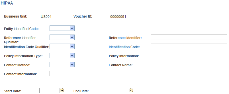

HIPAA Page
VCHR_HIPAA_SEC
(USA) Enter information for Health Insurance Portability and Accountability Act of 1996 (HIPAA) compliance. The link and page appear only if the payment method for the voucher has an EFT layout of HIPAA.

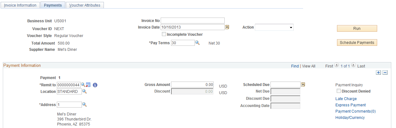

Voucher - Payments Page
Use the Voucher - Payments page (VCHR_PAYMENT_PNL) to view the payment schedule for a voucher and override payment settings.
On this page, you can change the payment schedule, schedule multiple payments, schedule direct payments to an alternate supplier or supplier location, record a manual payment, and create an express payment.
Navigation:
Accounts Payable, and then Vouchers, and then Add/Update, and then Regular Entry, and then Payments
This example illustrates the fields and controls on the Voucher - Payments page, add mode (1 of 2). You can find definitions for the fields and controls later on this page.
Voucher - Payments page (Add mode) 1 of 2
This example illustrates the fields and controls on the Voucher - Payments page, add mode (2 of 2). You can find definitions for the fields and controls later on this page.
Voucher - Payments page (Add mode) 2 of 2
PeopleSoft Payables schedules payments for a voucher when you save the voucher. At that time, the system processes the voucher fields against the Payment Terms table to determine the net due, discount due, and scheduled due dates for the payment.
Remember that if the supplier is on hold, the system does not select the voucher for payment until you remove the payment hold status for the supplier.
If a payment has been reconciled, the fields on this page are unavailable.

HIPAA
Click to access the HIPAA page, where you can enter HIPAA information for the voucher.
This link appears only if the payment method for the voucher has an EFT layout of HIPAA.

Payment Information
Field or Control Description
Scheduled Payment
Displays the scheduled payment number.
Remit to, Location, and Address
Displays the appropriate remit to supplier for the payment based on the remit to supplier that is established for the supplier on the Invoice Information page. This value is supplied by default from values that are established at the supplier location level. Whereas in most cases you remit directly to the supplier that sent you the voucher, the system enables you to override the default choices for remit to supplier, location, and address.
For example, if a supplier requires that payments be sent to its company corporate office rather than to a local office address, you can select the location to which the payment should be sent. You can also change the remit to supplier to pay one supplier for the vouchers of another, as is the case with factoring relationships, for example.
Note: The system updates the Remit to and Location fields appropriately if there are any changes to Supplier ID, ShortName, or Location fields on the Invoice Information page.
Alternate Names
Click the Alternate Names icon to view the alternate names for the remit-to supplier.
Supplier has been placed on Payment Hold in Supplier Profile
The Information icon appears if the supplier’s payment is placed on Hold Payment for the remit to supplier selected. It prompts you that the particular supplier’s payment is on hold in the Supplier Profile.
(USF) Schedule ID
U.S. Federal payment schedule ID. This field is populated only after you have run the Pay Cycle Application Engine (AP_APY2015) process for the payment.
See Understanding Federal Payment Processing.
Gross Amount
Enter the payment amount for the scheduled payment if you do not take a discount. If you have multiple payments scheduled for the voucher, the sum of the gross amounts for each of these payments must equal the gross amount of the voucher on the Invoice Information page.
Discount
Enter the amount of the discount that can be taken on the scheduled payment. If you have multiple payments scheduled for the voucher, the sum of all the discount amounts must equal the total discount amount that is available for the voucher. If you miss the discount due date and elect not always to take the discount, you cannot take advantage of this discount amount unless you reschedule the payment with new dates.
Scheduled Due
Determines when to pay the scheduled payment. During the payment selection step of the Pay Cycle process, the system compares the pay through date (entered as part of your payment selection criteria) to the scheduled pay date. If the scheduled pay date is less than or equal to the pay through date, the scheduled payment is a candidate for payment.
When PeopleSoft Payables automatically schedules payments, the scheduled due date is set to one of these values:
  • Discount due date: When a discount is available and the discount due date is later than the current date.
  • Net due date: When no discount is available or the discount due date has passed.
  • Current date: If the net due date has passed.
Users who are authorized to schedule payments manually can manipulate these dates and amounts to tailor the voucher's scheduled payments to meet your organization's cash flow requirements.
Note: When bank holiday processing is enabled, the system adjusts the scheduled due date forward or backward according to whether the due date falls on a work day, weekend, or holiday, depending on the parameters that are in effect. When the scheduled due date has been populated for a payment (either by calculation or by direct user entry), that payment is considered scheduled. The payment schedule is not updated for any subsequent changes in payment terms or basis date or amount data. You must first remove the date from the Scheduled Due field if you want to reschedule an already scheduled payment.
Net Due
Displays the net due date. When PeopleSoft Payables automatically schedules payments, the system calculates the net due date by applying the appropriate net payment terms timing calculation for the payment terms on the Invoice Information page. If you have specified net delay days for the supplier or for the PeopleSoft Payables business unit, the system adds that number of days to the date that is calculated from the payment terms to determine the net due date when the gross amount for the scheduled payment is due.
Discount Due
The system calculates the discount due date by applying the appropriate discount payment terms timing calculation for the payment terms on the Invoice Information page. If you have specified discount delay days for the supplier or for the PeopleSoft Payables business unit, the system adds that number of days to the date that is calculated from the payment terms to determine the latest date that you can legitimately retain the discount amount for the scheduled payment.
Accounting Date
The accounting date is based on the settings that are defined in the PeopleSoft Payables default hierarchy.
Payment Inquiry
Click to access the Payment Inquiry page to view payment information. This link is active only if the voucher has been paid.
See Payment Inquiry Page.
Holiday/Currency Options
Click to access the Holiday/Currency Options page, where you can change the default bank holiday processing and currency options for the payment.
Discount Denied
This check box is display-only and is set by the Pay Cycle process. When the Evaluate Discount Rate feature is enabled at the Installation Options level, the Pay Cycle process determines whether the discount should be taken. If the discount is not taken, the Discount Denied check box is selected.
Late Charge
Click to access the Late Charge Information page, where you can review and override the system-assigned payment reason code and the late charge information that appears by default through the PeopleSoft Payables control hierarchy.
You can override the payment reason code after you have paid the voucher, but you cannot change the Late Charge Option or the Late Charge Code fields after payment. Only user-defined codes appear.
Note: This page is available only if you have enabled late charge calculation on the Installation Options - Payables page.
Express Payment
Click to access the Express Payment page, where you can create an express payment. The system copies all relevant information on the voucher to the payment fields for creating an express payment.
Note: You cannot create an express payment if the supplier has a financial sanctions status of Review or Blocked. The Express Payment link is not available.
See Using Express Payments.
Prepayment
Click to search for and apply eligible regular vouchers to a prepaid voucher. This link is active only if you are entering a prepaid voucher.
See Understanding Prepayment Processing.

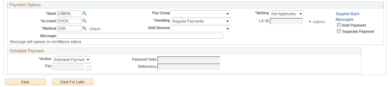

Payment Options
Bank and Account
Select the bank and bank account from which the payment is issued. This appears by default from the control hierarchy, but you can override these settings.
Note: Select a netting bank account from the Voucher payment page if the remit to supplier value is an interunit supplier and the source value is Billing.
Method
Select a payment method. Values are:
ACH: Automated Clearing House.
BEF: Customer-initiated EFT draft.
BOO: Customer-initiated draft.
CHK: System check.
DD: Direct debit.
DFT: Supplier-initiated draft.
EFT: Electronic Funds Transfer.
GE: Giro EFT.
GM: Manual giro.
LC: Letter of credit.
MAN: Manual check.
WIR: Wire report.
Drafts
Click to access the Draft Maturity Dates page, where you can specify the draft maturity date options for the payment. This link is active only if you select a draft payment method.
See Understanding Draft Processing.
Pay Group
Select the pay group for this payment, where applicable. Pay groups are used as part of the pay cycle selection criteria. You can use them to better control which payment schedules are selected. You define supplier pay groups on the Supplier Pay Group Codes page.
Handling
Displays the payment handling code, which appears by default from the PeopleSoft Payables control hierarchy. Each payment handling code has a sort sequence related to it that determines the order in which it prints. Checks are printed according to the sort sequence in ascending order: the lower the sort sequence number, the higher the sort priority. You must always have a payment handling code on a scheduled payment. You define payment handling codes on the Payment Handling Codes page.
See PeopleSoft Source to Settle Common Information: Defining Payment Handling Codes.
Netting
Displays the status for the Automatic Netting Selection Application Engine (TR_NET_ASEL) process:
H (hold): Net payment is on hold for the Automatic Netting Selection process in Treasury. This payment schedule is available for the netting selection process to select it.
N (not applicable): Netting does not apply to this payment. This supplier is not a netting supplier
S (selected): Net payment is selected for payment. Payment has been processed by the Automatic Netting Selection process and is now ready to be processed by the Netting Closing Application Engine (TR_NET_CLOSE and TR_NET_ARCLS) processes in pay cycle processing.
Hold Reason
Select a code to explain the payment hold. Values are:
  • ACC: Accounting in Dispute.
  • AMT: Amount in Dispute.
  • CRT: Contract Retention.
    Note: Retention from a recurring voucher contract is automatically placed on hold.
  • EFT: EFT Incomplete or Not Prenoted.
  • FNS: Financial Sanctions.
  • GDS: Goods in Dispute.
  • IPC: Inbound IPAC Required.
  • OTH: Other.
  • QTY: Quantity in Dispute.
  • WTH: Withhold Hold.
    Note: A payment can be automatically placed on Withhold Hold, depending on the withholding setup.
The reason codes are stored in a translate table. You can add more codes to the translate table using PeopleTools.
Messages
Enter a payment message of up to 70 characters to appear on the remittance advice (check stub). You can also click the Messages link to access the Payment Message page, where you can select message codes for predefined messages to appear on the remittance advice and specify the order in which they appear. You can repeat this for each scheduled payment.
You define message codes on the Payment Messages page which you access from the Procurement Options menu.
See PeopleSoft Source to Settle Common Information: Payment Message Page.
Supplier Offset TOP(supplier offset Treasury Offset Program)
The value entered for the supplier provides the default for TOP eligibility at the voucher payment level. When using the SPSMISC EFT file format, the system will automatically populate this field based on settings at the supplier level.
Supplier Bank Account
Click to access the Supplier Bank Account page, where you can select the bank account sequence number.
Letter of Credit
Displays the ID for the letter of credit. This field is active only for a payment method of LC.
Click the View Related Links icon to view the Letter of Credit Details page and the Letter of Credit document page.
See Letters of Credit.
Hold Payment
Select this option to place a payment on hold. The system stores the scheduled payment but the Pay Cycle process does not pay it.
When you are ready to take the payment off hold, deselect the check box.
Separate Payment
Select this check box if you do not want this payment to be grouped with other payments for the remit to supplier.
(USF) Inbound IPAC (inbound intra-governmental payment and collection transaction)
Select to indicate that this voucher is to be applied to an inbound IPAC transaction. This places the voucher payment on hold with a hold reason of IPC, IPAC hold, until the inbound IPAC data has been staged and is ready for you to associate with the voucher.
This field is available only if you have enabled federal payments on the Installation Options - Payables page.
See Processing Inbound IPAC Transactions.
(USF) Select IPAC (select intra-governmental payment and collection transaction)
Click to access the Inbound IPAC Stage Selection page, where you can search for and select staged inbound IPAC transactions to associate with the voucher.
(USF) IPAC (intra-governmental payment and collection transaction)
Click to access the IPAC page, where you can enter and review IPAC information for the voucher. This link is active only if you have enabled federal payments on the Installation Options - Payables page and the payment method that you selected is defined as an IPAC EFT layout for the bank that you have selected.
See Processing Outbound IPAC Transactions.
Schedule Payment
Action
Select the payment action. Values are:
  • Cancelled: Indicates that this payment has been canceled. This value is display-only; you cannot select it.
  • Escheated: Indicates that this payment has been escheated. This value is display-only; you cannot select it.
  • Prepaid: Indicates that this payment schedule was paid by a prepayment. This value is display-only; you cannot select it.
  • Record: Select to record a manual payment.
    Today's date is populated in the Payment Date field. You can also create manual payments using the Manual Payment Creation page.
    Note: You cannot record a manual payment if the supplier has a financial sanctions status of Review or Blocked. The system does not allow you to select this option.
  • Schedule: This is the default value for scheduled payments.
See Understanding Additional Payment Processing Options.
Pay
This field is enabled only if you have set the payment action to Record. This field enables you to indicate that either the Full amount or the Discounted amount is being paid.
(USF) Reference Voucher and Reference Payment

HIPAA Page
Use the HIPAA page (VCHR_HIPAA_SEC) to (USA) Enter information for Health Insurance Portability and Accountability Act of 1996 (HIPAA) compliance.
Navigation:
Click the HIPAA link on the Voucher - Payments page.
This example illustrates the fields and controls on the HIPAA page. You can find definitions for the fields and controls later on this page.
HIPAA page
Entity Identified Code
Enter a code to identify the organizational entity, physical location, property, or individual: 3rd Party or Payer.
Reference Identifier Qualifier and Reference Identifier
Enter a qualifier against which to indicate that the payment is to be applied —Invoice, Master, or Plan— and a corresponding identifier number from the agency that is authorizing the payment.
Identification Code Qualifier and Identification Code
Enter a qualifier to indicate the code structure method of the identification code—D&B (Dun and Bradstreet), D&B + Sfx (Dun and Bradstreet plus 4-character suffix), Insurance, Plan ID, or Tax ID—and enter the corresponding code.
Policy Information Type and Policy Information
Enter Account, Contract, Invoice, or Policy to define the policy type, and enter additional information, such as the policy number.
Contact Method and Contact Name
Enter the preferred contact method: Email, Fax, or Telephone. Also enter the contact person's name.
Contact Information
Enter specific contact information, such as email address.
Start Date and End Date
Enter the dates to define the duration of the policy.
