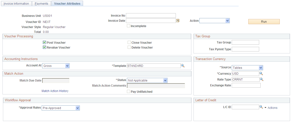

This example illustrates the fields and controls on the Voucher Attributes page, add mode (1 of 2). You can find definitions for the fields and controls later on this page.

This example illustrates the fields and controls on the Voucher Attributes page, add mode (2 of 2). You can find definitions for the fields and controls later on this page.

Voucher Processing
The fields in the Voucher Processing group box enable you to select various voucher processing options. Depending on the status of the voucher and its stage in the voucher life cycle, not all of these options may be available.
Field or Control Description
Post Voucher
Select to allow the voucher to post. The default value is set to “Y”. If this check box is selected, the voucher is available to the Voucher Posting process, assuming that all other edit, approval, and control group criteria are met.
To prevent the voucher from posting during the next Voucher Posting process, deselect this check box.
If the voucher has been posted, this check box is selected and display-only.

Accounting Instructions
The values appear by default based on the PeopleSoft Payables control hierarchy. You can override them.
Account At
Determines how you view discounts. Select from:
Gross: If you account at gross, the discount is earned when you are able to take it.
Net: Accounting at net assumes that you will always take a discount. If you do not, the discount is lost.
Template
Identifies the Accounting Entry Template that is associated with this voucher. The Accounting Entry Template controls the offset accounts, for example, the sales tax, freight, and discount accounts.
Match Action
Status
Displays the current matching status of the voucher. You can change the match status, but what you can change varies depending on where the voucher is in the Matching process.
For example, before running the Matching process, you can change the matching status to No Match on a line-by-line basis; that is, you can indicate which lines require matching and which lines do not.
The user ID does not require match override authority to switch between a matching status of Ready and a status of No Match.
The match status values are:
CreditNote: Marks the voucher as being matched with a credit memo adjustment voucher.
Dispute: Indicates that the voucher is on hold from further matching processing.
Exceptions: A voucher that fails the Matching process initially has a status of Exceptions. In this case, you can select the Exceptions link on the Voucher - Summary page to transfer to the Match Exception Workbench Details page. Or you can override the match status here, provided that your user ID has match override authority.
Matched: Indicates that the voucher has successfully passed the Matching process.
No Match: Indicates that all voucher lines are flagged as Do Not Match.
If no lines are flagged for matching, the system sets voucher matching to No Match. The system sets this value automatically when it copies voucher information from a purchase order or receiver.
You can set this value manually as well.
Overridden: Enables the voucher to pass matching by setting the match status to Matched, even though the voucher does not match specified purchase orders or receivers.
If you had previously set the status to Overridden, you can change it back to Exceptions.
Ready: Marks the voucher as ready for matching so that it can be processed the next time the Matching process is run.
If voucher lines exist that have been flagged as full match, the system sets the voucher matching status to Ready before the voucher can be saved. The system sets this value automatically when it copies voucher information from a purchase order or receiver.
You can set this value manually as well. The user ID does not require match override authority to switch between a matching status of Ready and a status of No Match.
Match Due Date
Edit the match due date for this specific voucher. The Matching process selects only the vouchers that are ready to be matched as of that date.
Match Action Comments
Enter comments for the voucher match action.
Match Action History
Click Match Action History link to review match action history on the Match Action History page.
Pay UnMatched
Select to pay an unmatched voucher. You must have authority, defined in user preferences, to do this.
See Understanding the Matching Process.
Transaction Currency
The fields in the Transaction Currency group box enable you to view and override the default voucher transaction currency and the rate type (or user-defined exchange rate) that is used to convert the voucher transaction currency into the business unit's base currency when you post the voucher. You can override the default settings before posting the voucher.
The exchange rate that you view or enter here has no effect on the payment currency. To convert the invoice currency to a different payment currency, use the Holiday/Currency Options page, accessed from the Voucher - Payments page.
Source
Select the source of the currency exchange rate:
Tables: The system determines the currency exchange rate automatically using the PeopleSoft Financials exchange rate table.
If the system is assigning the exchange rate using the PeopleSoft Financials exchange rate tables, then the voucher transaction currency, rate type, and invoice date determine which rate the system uses to convert amounts to the business unit's base currency.
User: Enter your own exchange rate (independent of the tables) in the Exchange Rate field.
Currency, Rate Type, and Exchange Rate
The currency and rate type appear by default from the control hierarchy of business unit, origin, control group, and supplier. You can override these settings here on the voucher.
Tax Group
Tax Group and Tax Pmnt Type (tax payment type)
PeopleSoft Payables uses these fields to create payments, for example garnishment payments, for PeopleSoft Payroll.
Workflow Approval
Approval
Set the approval status of the voucher:
Approval Framework: Select to use the Approval Framework for voucher approval routing.
Pre-Approved: The voucher's approval status is set to approved. The voucher is not routed for approval and is immediately available for payment.
Virtual Approver: Specify the business process and approval rule set to use for approving the voucher using the Virtual Approver.
Bus Proc(business process)
If you select Virtual Approver for the approval type, you must enter a business process for the approval process.
Appr Rule(approval rule)
If you select Virtual Approver for the approval type, you must enter an approval rule for the approval process.
A voucher must be approved before it can be paid.
See Approving Vouchers.
Letter of Credit
L/C ID (letter of credit ID)
Select the letter of credit ID for the payment. This field is populated during voucher save based on the value in the L/C ID field on the Payments page.
View Related Links
Click the View Related Links icon to view the Letter of Credit Details page and the Letter of Credit Doc (letter of credit document) page.
See Letters of Credit.

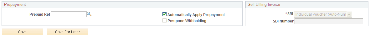

Prepayment
Enter prepayment information.
Prepaid Ref
Search for the prepaid voucher reference code created for the same supplier.
See Understanding Prepayment Processing.
