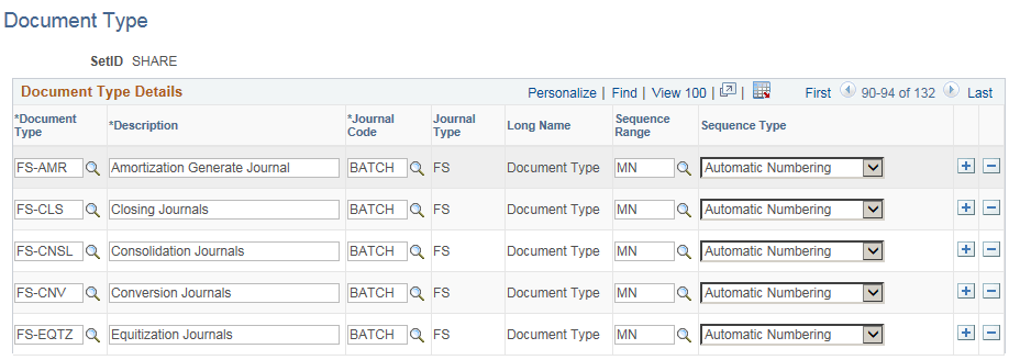

Document Type Page
Use the Document Type page (DOC_TYPE) to use this page to define your Payables document types.
Navigation:
Set Up Financials/Supply Chain, and then Common Definitions, and then Document Sequencing, and then Define Document Type
This example illustrates the fields and controls on the Document Type page
Document Type page
Once you set up your system for document sequencing, you can use this page to define your payables document types.
