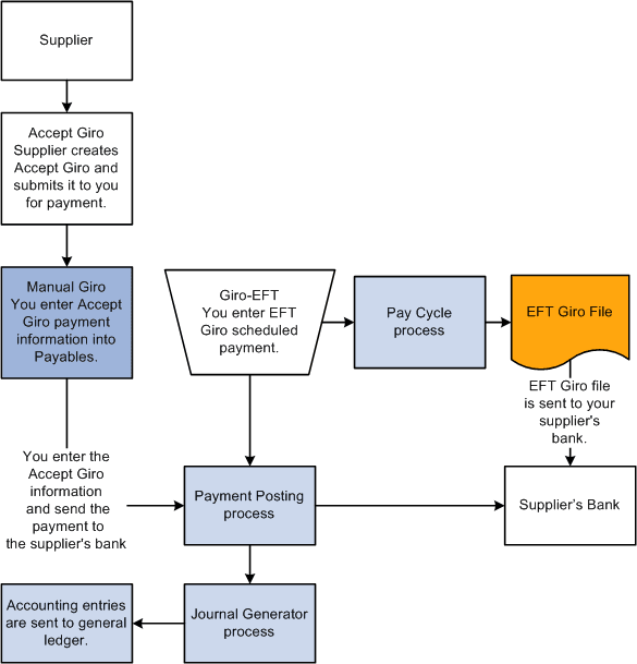

This diagram shows the process flow for giro payments.
Giro Payment process flow
