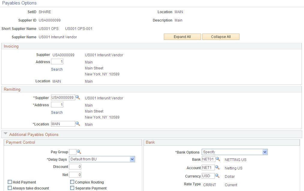

Select a netting bank account from the Supplier - Payables Options page. Click the location tab on the Supplier page and then the Payables link to view the Payables Options page. The netting bank is displayed in the prompt only if the remit to supplier value is an interunit supplier. Similar to the Supplier page, the netting bank is displayed on the Voucher - Payments page. For more information, see Voucher - Payments Page
You can select or change the netting bank account for the schedule payments for any voucher that has an interunit supplier and Billing as source.
This example illustrates the fields and controls on the Payables Options - Netting Bank.
Payables Options Netting Bank
