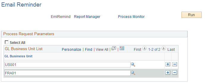

Email Reminder page
Use the Email Reminder page (RUN_CNTL_FC) to send email reminders to resources who have not submitted a required forecast.
Navigation:
Program Management, and then Forecasting, and then Forecasting Email Reminder
This example illustrates the fields and controls on the Email Reminder page. You can find definitions for the fields and controls later on this page.
Email Reminder page
On this page, you can schedule the Email Reminder Application Engine process (FC_REMINDER) to send an email reminder to each resource in the specified GL business units who has not submitted a forecast for the current forecast iteration as of the current Run Date and Run Time on the Process Scheduler Request page.
Select all GL business units or specify them individually. Click Run to initiate or schedule the process by using the PeopleSoft Process Scheduler.
