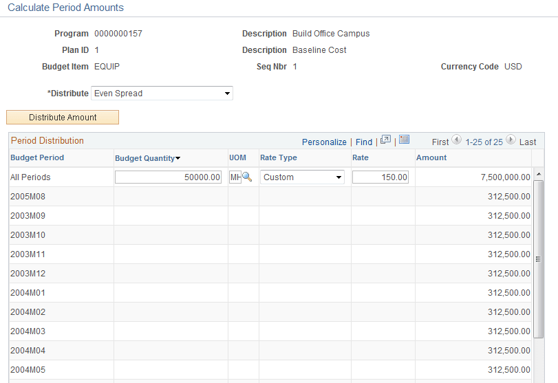

Program Budget Detail - Calculate Period Amounts Page
Use the Program Budget Detail - Calculate Period Amounts page (PGM_BUD_PER_SEC) to calculate period budget amounts for budget items with a labor resource class.
Navigation:
Click the Calculate link on the Budget Detail page.
This example illustrates the fields and controls on the Program Budget Detail - Calculate Period Amounts page. You can find definitions for the fields and controls later on this page.
When you first access this page, you can enter information only in the All Periods row. Use this row to calculate a budget amount for all periods. Then, use a distribution method to distribute the amount across periods.

Distribute
Select the method you want to use to distribute the calculated amount to the budget periods. Options are:
Even Spread: Select to automatically divide the amount in the All Periods row evenly across all budget periods.
Repeat Amount: Select to apply the full amount in the All Periods row to each budget period.
Percentage Spread: Select to display the Percentage column in the Period Distribution grid. Enter the percentage of the amount in the All Periods row you want to allocate to each budget period. The total percentage amount must equal 100.
Manual Entry: Select to open up the Quantity, Rate, and Amount fields for each budget period in the Period Distribution grid. You can then enter individual budget amounts manually for each budget period or perform quantity times rate calculations for individual periods. The All Periods row is hidden when this option is selected.
Distribute Amount
Click to populate the amount column based on the distribution method chosen.
Period Distribution
Use this grid to define the amounts to distribute by using the Distribute Amount button or to manually calculate budget amounts for each period.
Field or Control Description
Budget Period
Displays the budget periods. The system automatically calculates all budget periods for the program and displays them here.
Budget Quantity
Displays the number of hours or days budgeted. This number is not stored in the budget rows. It is used only to calculate the period amount.
UOM (unit of measure)
Select a unit of measure:
MDY (Person Day)
MHR (Work Hour)
Available unit of measure values are specified on the Project Costing Options page.
Rate Type
Select a rate type from these options:
Custom: Select to manually enter the rate.
Project Role: Select to use the rate associated with a project role.
Job Code: Select to use the rate associated with a job code.
Rate
Enter or select a rate. Available values are based on the rate type:
For a Custom rate type, enter a free form rate.
For a Project Role rate type, select from the prompt that shows all rates by project role.
For a Job Code rate type, select from the prompt that shows all rates by job code.
