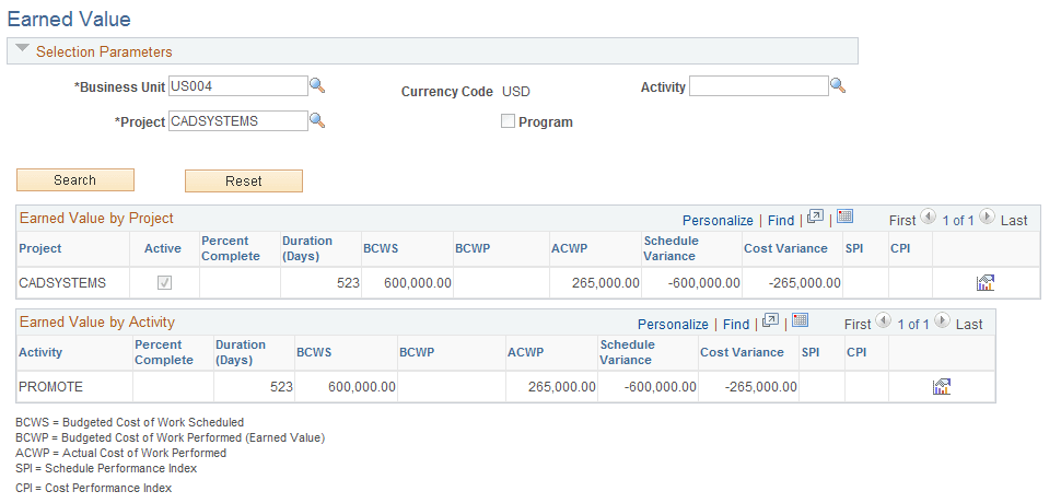

Earned Value Page
Use the Earned Value page (PC_EA_EARNED_VALUE) to view earned value and other data that is related to time factors, budget, and actual cost of a project and its activities.
Navigation:
Program Management, and then Interactive Reports, and then Earned Value Rpt
This example illustrates the fields and controls on the Earned Value page. You can find definitions for the fields and controls later on this page.
Earned Value page
Enter the necessary search criteria to filter the projects or activities that require earned value analysis. Click the Search button to retrieve and display a list of projects and activities that meet the specified parameters. Click the Reset button to reinstate the default search settings.
If a detail project is entered in the Project field, the page displays earned value data for the entire project and for each activity that is within the project.
If a program is entered in the Project field, the page displays earned value data for all projects that are under the specified program. The Max Level field limits the selection of child projects to the first, second, or third level under the program as it is defined on the enterprise program tree.
Field or Control Description
Percent Complete
Displays the percentage complete value that the system calculates based on the method that is selected on the Project Costing Definition page.
Duration (Days)
Displays the number of days that are allotted for the completion of the project or activity.
BCWS (budgeted cost of work scheduled)
Displays the budget amount that is allocated for the time period starting from the beginning of the project or activity to the current date.
BCWP (budgeted cost of the work performed)
Displays the budgeted cost based on the percentage of the project or activity that is completed and the corresponding duration date. For example, if the project is 50 percent complete, this field summarizes and displays all budget rows in the Project Transactions summary table (PC_SUMMARY_TBL) that have an accounting date that occurs on or before the halfway date of the project's duration. This is also known as the earned value.
ACWP (actual cost of work performed)
Displays the actual cost of the project or activity as of the current date.
Schedule Variance
Displays the cost difference between the baseline plan and the current progress of the activity at the current date. Calculated as: (Budgeted Cost of Work Performed)(Budgeted Cost of Work Scheduled) .
Cost Variance
Displays the difference between how much it should cost to achieve the current level of completion for the activity and how much it actually costs to a achieve the level of completion as of the current date. Cost variance is calculated as (Budgeted Cost of Work Performed)(Actual Cost of Work Performed) .
SPI (schedule performance index)
Displays the ratio of the work that is performed to the work that is scheduled, which is calculated as (Budgeted Cost of Work Performed) ÷ (Budgeted Cost of Work Scheduled) .
CPI (cost performance index)
Displays the ratio of the budgeted cost of work that is performed to actual cost, which is calculated as (Budgeted Cost of Work Performed) ÷ (Actual Cost of Work Performed) .

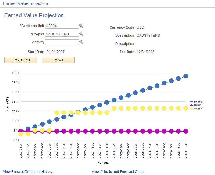

View Earned Value Projection
Click to access the Earned Value Projection page where you can view earned value history and future projection. If you click the icon on an activity row, the system draws the chart for that activity. If you click the icon on a project row, the system draws the chart for that project.
Earned Value Projection Page
Use the Earned Value Projection page (PC_EARNED_VAL_PRJN) to view earned value history and future projection for projects or activities in an S-Curve chart.
Navigation:
  • Program Management, and then Interactive Reports, and then Earned Value Projection, and then Earned Value Projection.
  • Program Management, and then Interactive Reports, and then Earned Value Rpt. Click the View Earned Value Projection icon.
  • Program Management, and then Project Management, and then Manager Workbench. Select Go To: Earned Value Projection.
  • Program Management, and then Project Management, and then Manager Workbench, and then Activity. Select Go To: Earned Value Projection.
  • Program Management, and then My Projects. Click the View Earned Value Projection icon.
Because earned value reporting is a comparison of the performance of a project against its budget, if a project does not have an active budget, earned value cannot be determined. The system can draw the earned value projection chart only for projects with active budgets.
This example illustrates the fields and controls on the Earned Value Projection page. You can find definitions for the fields and controls later on this page.
Business Unit
Enter the business unit that contains the project or activity for which you want to draw the chart.
Project
Enter the project ID for which you want to draw a chart. If you want to draw a chart for a project, you should leave the Activity field blank.
Activity
Enter the activity for which you want to draw a chart. If you leave this field blank, the system draws a chart at the project level.
Currency Code
Displays the currency code in which the amounts are displayed. This is the project business unit currency code.
Start Date and End Date
Displays the start date and end date of either the project or the activity depending on whether the chart is being drawn for a project or for an activity.
Draw Chart
Click to render the chart based on the parameters that you entered for Business Unit, Project, and Activity.
Reset
Click to reset the chart to the original chart from when you entered this page.
Periods
Displays the periods that are based on the active project cost budget calendar. Each plot point represents the ending date of each budget period. The last plot point is based on the budget period end date of the greatest accounting date of actuals, cost estimates to complete, and budget for the project. If the project does not have an active budget, then the system cannot determine earned value and an error message appears.
Represents the budgeted cost of work scheduled. This is the finalized budget. The system uses the Cost Budget analysis group defined for the project and sums all amounts with accounting dates less than or equal to each plot point date.
BCWP (budgeted cost of work performed)
Represents the budget cost of work performed. The system charts the BCWP values based on these rules:
  • BCWP is zero until the project or activity starts. If the percent complete is zero, then BCWP is zero.
  • For plot points less than or equal to current date: For each plot point the system determines the effective percent complete for the project or activity and calculates the budget date for the plot point based on the schedule percent complete. It uses the Cost Budget analysis group defined for the project and sums all amounts with an accounting date less than or equal to the calculated budget date.
  • For plot points in the future: Since percent complete is not available for the future, the system uses the schedule performance index (SPI) to project BCWP amounts in the future. For each plot point, the system multiplies the BCWS by the current SPI.
Represents the actual cost of work performed. The system charts the ACWP values based on these rules:
  • For plot points prior to the current date: The system uses the Actual Cost analysis group defined for the project and sums all of the amounts with the accounting date that is less than or equal to each plot point date.
  • For plot points that occur after the current date: The system uses the Forecast analysis group that is defined for the project and sums all of the amounts with accounting dates less than or equal to each plot point date.

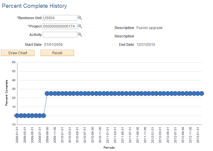

Percent Complete History Page
Use the Percent Complete History page (PC_PRCNT_COMP_HIST) to view a chart of the percent complete progression over time for projects and activities.
Navigation:
  • Program Management, and then Interactive Reports, and then Percent Complete History Rpt.
  • Program Management, and then Interactive Reports, and then Earned Value Projection Rpt. Click the View Percent Complete History link.
This example illustrates the fields and controls on the Percent Complete History page. You can find definitions for the fields and controls later on this page.
If you access this page by clicking on the View Percent Complete History link from the Earned Value Projection page, the system opens this page in a new window and displays the chart with the criteria that you entered on the Earned Value Projection page. If you access this page from menu navigation, you can enter the search criteria and click the Draw Chart button to generate the chart.
The system draws the chart from the project or activity start date to the current date. The x-axis is based on the project's active budget calendar. If the project has no active budget, then the installation level default budget calendar will be used. The plot points are the budget period end dates. The y-axis is the percent complete.

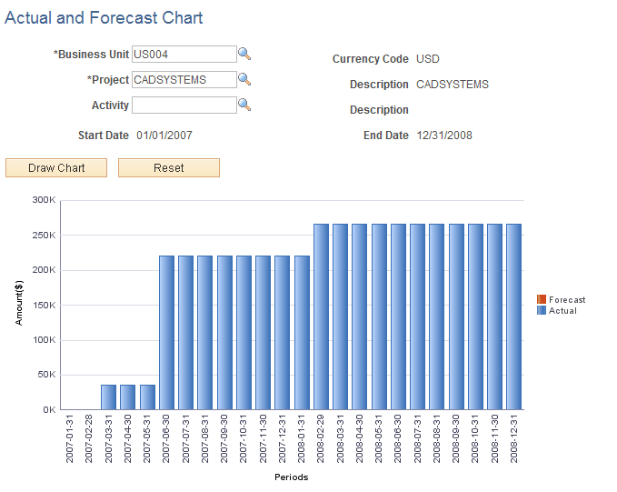

Actual and Forecast Chart Page
Use the Actual and Forecast Chart page ( PC_ACT_FCAST_CHART ) to view a bar chart of the actual cost of work performed values and the forecast values for projects and activities.
Navigation:
  • Program Management, and then Interactive Reports, and then Actuals and Forecast Rpt.
  • Program Management, and then Interactive Reports, and then Earned Value Projection Rpt. Click the View Actuals and Forecast Chart link.
This example illustrates the fields and controls on the Actual and Forecast Chart page. You can find definitions for the fields and controls later on this page.
This page displays a bar chart of the ACWP for each period. If you access this page by clicking on the View Actuals and Forecast Chart link from the Earned Value Projection page, the system opens this page in a new window and displays the chart with the criteria that you entered on the Earned Value Projection page. If you access this page from menu navigation, you can enter the search criteria and click the Draw Chart button to generate the chart.
