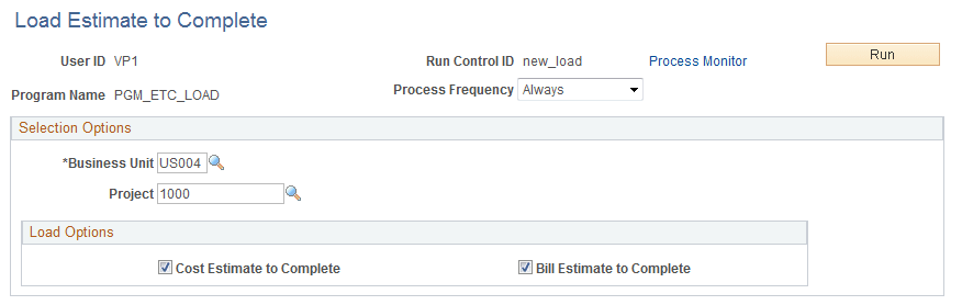

Load Estimate to Complete Page
Use the Load Estimate to Complete page ( RUN_PGM_ETC_LOAD) to run the Load Estimate to Complete application engine to load the estimate to complete transactions into the Project Transactions table.
Navigation:
Program Management, and then Program Tools, and then Load Estimate To Complete, and then Load Estimate to Complete
This example illustrates the fields and controls on the Load Estimate to Complete page. You can find definitions for the fields and controls later on this page.
Field or Control Description
Business Unit
Enter the business unit for which to calculate the estimated remaining cost or billing amounts.
Project
Enter the project ID to run this process for only one project. You can only choose from active projects.
Cost Estimate to Complete
Select to enable the process to reload the rows with the analysis type of ETC in the Project Transaction table.
Bill Estimate to Complete
Select to enable the process to reload the rows with the analysis type of ETB in the Project Transaction table.
