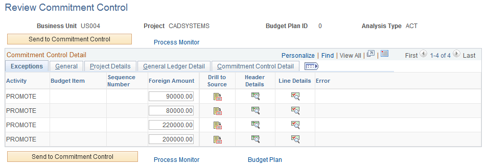

This example illustrates the fields and controls on the Review Commitment Control page. You can find definitions for the fields and controls later on this page.
Review the Commitment Control error messages and make corrections as required.
If you change any ChartField, ledger, ledger group, or budget item value on this page for transactions that originate in Projects Budgeting (system source of PCB), the system updates the corresponding fields on this page with the new value on rows that contain the same value of project business unit, project, activity, budget item, and sequence number. For example, if you change the Category ChartField value on the first row from blank to Cost, the Category value changes to Cost for other rows in the grid that contain the same project business unit, project, activity, budget item, and sequence number.
Field or Control Description
Send to Commitment Control
Click to initiate the PC_WRAPPER Application Engine process for the corresponding interface ID. The PC_WRAPPER process contains the Load Third-Party Transactions process, Project Costing to Commitment Control process, and the Budget Processor. Prior to sending the transactions back through the Security and Budget Processor, the system resets the Commitment Control distribution status, Project Costing distribution status, and budget header status to N (new).
Exceptions
The Exceptions tab displays the activity, budget item, sequence number, amount, and error that are associated with the budget row. Modify the Foreign Amount field as required.
Drill to Source
Click to access the Budget Detail page for the budget plan if the entry originated in Projects Budgeting. Click Drill to Source to access the Transaction List page if the transaction originated from Grants Budgeting or the Add Transactions page. Click Return to Review Commitment Control to return to the Review Commitment Control page.
Header Details
Click to access the Commitment Control PC Budget Exceptions page in a new browser window. Close the new browser window to return to the Review Commitment Control page.
Line Details
Click to access the Commitment Control PC Line Exceptions page in a new browser window. Close the new browser window to return to the Review Commitment Control page.
Budget Plan
Click to access the Budget Plan page for the project.
