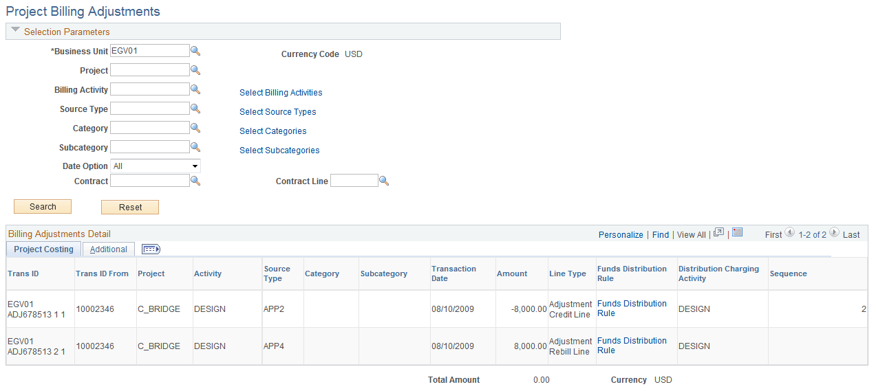

Project Billing Adjustments Page
Use the Project Billing Adjustments page (PC_FND_UNAPPL_BAJ) to view Billing adjustments.
Navigation:
Project Costing, and then Funds Distribution, and then Funds Distrib Bill Adjustments
This example illustrates the fields and controls on the Project Billing Adjustments page. You can find definitions for the fields and controls later on this page.
Use this page to view credits, credit and rebills, net adjustments, and ChartField changes that are made from the PeopleSoft Billing - Invoice Maintenance component.
In the Selection Parameters section, you can enter up to 20 selections for the Billing Activity,Source Type,Category, and Subcategory fields.
Field or Control Description
Line Type
Displays the adjustment type from PeopleSoft Billing.
Funds Distribution Rule
Click this link to access the Funds Distribution - Target page.
Distribution Charging Activity
Displays the activity ID of the source transaction that resulted in the adjustment of the original invoice if it differs from the billing activity of the original invoice. This difference can occur if a funds distribution rule distributes costs to a target activity.
Distribution Sequence Number
Displays the funds distribution sequence number of the original invoice that is being adjusted. This sequence number is shown for only adjustment and adjustment credit line types.
