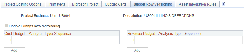

Budget Row Versioning Page
PC_BUD_VER_HST_CFG
Enable budget row versioning for the business unit, and define the sequence of analysis types that the system uses to distinguish historical cost and revenue budget plan versions.

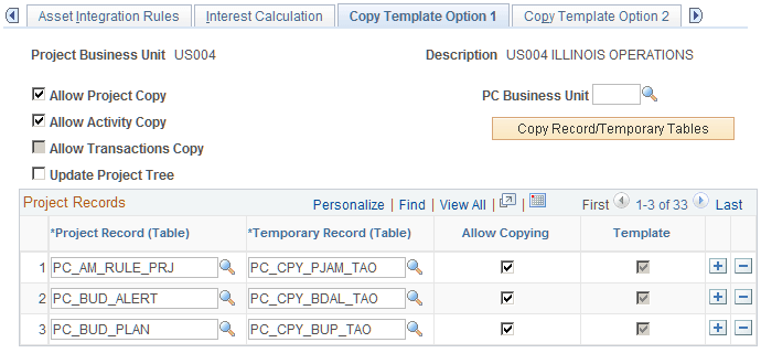

Copy Template Option 1 Page
PC_CPY_TMPL_PNL1
Specify the project tables that the system copies into a new project from a template.

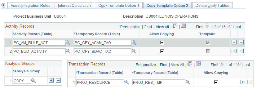

Copy Template Option 2 Page
PC_CPY_TMPL_PNL2
Specify the activity and transaction tables that the system copies into a new project from a template, and define parameters analysis groups.

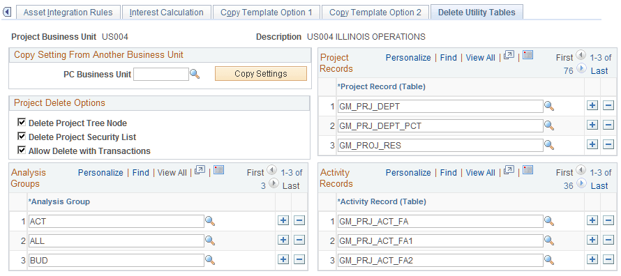

Delete Utility Tables Page
PC_DEL_PROJ_REC_PG
Define the parameters for deleting projects, activities, and transactions for a specified business unit.

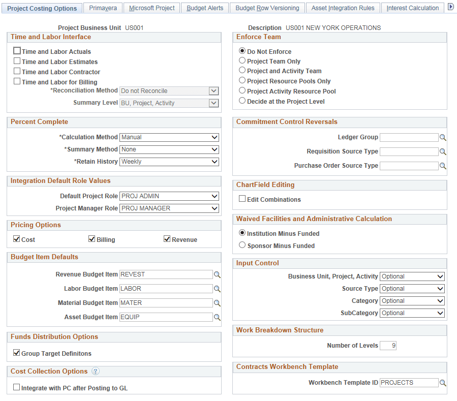

Project Costing Options Page
Use the Project Costing Options page (BUS_UNIT_OPT_PC) to establish project-related transaction fields that are required for importing transactions from other PeopleSoft applications.
Establish the method for calculating the percent complete value for all projects and activities in the business unit.
Navigation:
Set Up Financials/Supply Chain, and then Business Unit Related, and then Project Costing, and then Setup PC BU Options
This example illustrates the fields and controls on the Project Costing Options page. You can find definitions for the fields and controls later on this page.
Use the Project Costing Options page to define required criteria relating to transactions that enter Project Costing from other PeopleSoft applications.
If you modify the settings on the Project Costing Options page, the system does not modify existing project settings. The system applies the modified settings only to new projects.

The initial value of this field defaults from the Installation Options - Project Costing Integration page. You can override the value set at the installation level for individual Project Costing business units on this page. The saved value of this field defaults to the Project Costing Definition page.
Select to indicate that the funding source rules can be grouped manually. Each target definition can be associated to a set of rules.
Deselect to indicate that each funding source rule will be associated with separate target definition.
See Also, Understanding Projects and Understanding Funds Distribution.
Cost Collection Options
Field or Control Description
Integrate with PC after Posting to GL
Select this check box as an indication for the system to integrate with Project Costing only after posting the transactions in General Ledger. The transactions here refer only to the voucher accounting entries from Payables and expense reports from Expenses.
Contracts Workbench Template
Workbench Template ID
Enter the template ID that the system uses when a user views Project Costing data in the Contracts Workbench for this business unit. The only templates that are available to choose from are those where Project Costing was selected in the Workbench Type field. PeopleSoft delivers the PROJECTS template, which is the default template for all Project Costing business units.
Use the Budget Row Versioning page (PC_BUD_VER_HST_CFG) to enable budget row versioning for the business unit, and define the sequence of analysis types that the system uses to distinguish historical cost and revenue budget plan versions.
Navigation:
Set Up Financials/Supply Chain, and then Business Unit Related, and then Project Costing, and then Setup PC BU Options, and then Budget Row Versioning
This example illustrates the fields and controls on the Budget Row Versioning page. You can find definitions for the fields and controls later on this page.
Before you can define the analysis types and sequences to use to create budget plan versions, you must set up analysis types in the Analysis Types component (PROJ_ANALYSIS_TYPE) to use to distinguish budget rows for particular budget plan versions.
See Analysis Types Page.
This PeopleSoft application delivers a series of analysis types and groups that you can use to distinguish historical cost and revenue budget versions.
See Budget Plan Versions.
The system uses two different analysis type sequences to distinguish budget plan versions—one sequence for cost budget plan versions and one for revenue budget plan versions.
Enable Budget Row Versioning
Select to activate budget row versioning for the business unit. When this option is active, historical versions of finalized cost and revenue budget plans are stored in the Project Transaction table for analysis or reporting.
You cannot enable budget row versioning if Commitment Control is enabled for Project Costing on the Application Fundamentals: Installation Options - Products Page.
Cost Budget Analysis Type Sequence and Revenue Budget Analysis Type Sequence
Enter a series of analysis types to represent historical cost and revenue budget versions. You can use the analysis types that are delivered with the system for this purpose, or create your own sequences. Enter as many analysis types as needed for each sequence.
You must enter analysis types in the order that you want them to be assigned by the system to historical budget versions. When budget row versioning is enabled, the first time that you finalize a project budget for the business unit, the system assigns the first analysis type in the cost or revenue budget sequence on this page to a copy of the budget plan rows. Each subsequent time that you finalize the budget for this project, the system updates a copy of the new finalized budget rows with the next available analysis type from the sequence. The budget version is assigned on a project-by-project basis.
You cannot enter an analysis type that is associated with an analysis group that you specify for Cost Budget, Revenue Budget, Actual Cost, or Actual Revenue in the Analysis Group Defaults group box on the Installation Options - Project Costing page.
Add
Click to append analysis types to the sequence.
After you enter analysis types and save the page, you can append analysis types to the sequence, but you cannot change an existing analysis type or change the sequence order.
You are not required to create an analysis type sequence in ascending alphanumeric order. The system maintains a separate sequence number for each analysis type on this page. Each time that you add an analysis type, the system increments the Sequence Number field (SEQ_NBR) for the budget type (cost or revenue). The Sequence Number field is not visible on the user interface. The system uses the field to determine the next available budget version analysis type when you finalize a project budget plan.
Use the Copy Template Option 1 page (PC_CPY_TMPL_PNL1) to specify the project tables that the system copies into a new project from a template.
Navigation:
Set Up Financials/Supply Chain, and then Business Unit Related, and then Project Costing, and then Setup PC BU Options, and then Copy Template Option 1
This example illustrates the fields and controls on the Copy Template Option 1 page. You can find definitions for the fields and controls later on this page.
Use this page to configure both the Project Copy and Project Templating features. Also use this page to specify the tables that contain field values that the system copies into a new project that you create from a template.
For Project Copy, you can select the Allow Project Copy, Allow Activity Copy, and Allow Transaction Copy check boxes to enable this feature at the project business unit level. Then, you indicate at the project business unit level which records are eligible for copying field values from one project to another.
The Project Templating feature does not use the Allow Project Copy, Allow Activity Copy, or Allow Transaction Copy check boxes to determine if you can create a project from a template. The system makes that determination based on security for project creation. The eligible records that the system uses to create projects and field values from templates are based on the selected records in the Template column.
Allow Project Copy
Select to include project definitions in a project that you copy from an existing project. The system copies the field values from the tables that are listed in the Project Records grid from the existing project to the new project.
Allow Activity Copy
Select to include activity definitions in a new project that you create from an existing project. The system copies the field values from the tables that are listed in the Activity Records grid on the Copy Template 2 page from the existing project to the new project.
Allow Transactions Copy
Select to include transactions in a new project that you create from an existing project. The system copies the transactions from the tables that are listed in the Transaction Records grid on the Copy Template 2 page from the existing project to the new project.
You cannot copy transactions from one project to another if you use Commitment Control or Projects Budgeting. Therefore, the Allow Transactions Copy check box is not available for selection if Commitment Control is enabled for Project Costing on the Installation Options - Products page.
Update Project Tree
Select to insert the new project into a project tree.
PC Business Unit (project business unit)
Enter a business unit to use with Copy Record/Temporary Tables function.
Click to copy record settings of the business unit that is selected in the PC Business Unit field to this template.
Note: Project Costing delivers standard and temporary Project Records in Business Unit US003, which you can use as a guideline for all Project Records that can be used in the Project Copy and Project Templating features.
Allow Copying
Select the check box corresponding to the project-level records from which you want to copy field values for an existing project into a new project.
Note: You must also select the Allow Project Copy option for the system to copy the selected records and their field values.
Template
When you select the Allow Copying check box for a row, the system automatically selects the Template check box if the record is eligible to be copied to create projects from templates. This check box is not editable.
This column does not restrict data that is saved in the database tables for a project template.
This table lists the records and temporary records that are available for performing the project copy and project templating process:
Project Record (Table) Temporary Record (Table) Used for Project Copy, Project Templating, or Both
Use the Copy Template Option 2 page (PC_CPY_TMPL_PNL2) to specify the activity and transaction tables that the system copies into a new project from a template, and define parameters analysis groups. This page enables you to define parameters for copying activities, transactions, and analysis groups as well.
Navigation:
Set Up Financials/Supply Chain, and then Business Unit Related, and then Project Costing, and then Setup PC BU Options, and then Copy Template Option 2
This example illustrates the fields and controls on the Copy Template Option 2 page. You can find definitions for the fields and controls later on this page.
Allow Copying
Select the check box corresponding to the activity-level records from which you want to copy field values for an existing project into a new project. The system copies the selected records and their field values only if you select the Allow Activity Copy option on the Copy Template 1 page.
Template
Analysis Group
Enter the analysis group that the system uses for mapping analysis types from the template project or activity to the new project or activity.
When you copy transaction rows from one project to another, the analysis group indicates which transaction rows to copy. The system copies only those rows with an analysis type that is in the selected analysis group. The Template Copy analysis group (COPY) selects actual cost rows (with an analysis type of ACT) and maps them to total cost budget rows (with an analysis type of BUD). Thus, the system selects ACT rows from the template project and copies them to the new project as BUD rows. The COPY analysis group is delivered as system data; however, you can use any analysis group.
See Analysis Groups Page.
Activity Records
This table lists the activity record and temporary records that are necessary for performing the copy process:
Activity Record (Table) Temporary Record (Table) Used for Project Copy, Project Templating, or Both
PC_AM_RULE_ACT
PC_CPY_ACAM_TAO
Both
PC_BUD_ACTIVITY
PC_CPY_BDAC_TAO
Copy
PC_BUD_ALERT
PC_CPY_BDAL_TAO
Both
PC_BUD_DETAIL
PC_CPY_BDTL_TAO
Both
PC_BUD_ITEM
PC_CPY_BDIT_TAO
Both
PC_DELIVERABLES
PC_CPY_DELV_TAO
Both
PC_PRICE_R_PLAN
PC_CPY_PRCP_TAO
Both
PC_PRICE_RATES
PC_CPY_ARAT_TAO
Both
PGM_ACT_DEP
PGM_CPY_ATD_TAO
Both
PROJ_ACT_DESCR
PC_CPY_ADES_TAO
Copy
PROJ_ACT_LOC
PC_CPY_ALOC_TAO
Both
PROJ_ACT_STATUS
PC_CPY_ASTA_TAO
Both
PROJ_ACT_TEAM
PC_CPY_ACTM_TAO
Both
PROJ_ACTIVITY
PC_CPY_ACTY_TAO
Both
PROJ_QUALITY
PC_CPY_QUAL_TAO
Both
PSA_ORGPRJ_ACT
PC_CPY_OGAC_TAO
Copy
Transaction Records
Transaction Record (Table) and Temporary Record (Table)
The only transaction record that is necessary for performing the copy process is PROJ_RESOURCE. The corresponding temporary record is PROJ_RES_TMP.
The system copies the selected records and field values only if you select the Allow Transactions Copy option on the Copy Template 1 page.
Use the Delete Utility Tables page (PC_DEL_PROJ_REC_PG) to define the parameters for deleting projects, activities, and transactions for a specified business unit.
The Project Delete utility provides an effective means of removing projects, activities, and transactions from the database. Before you can use the utility, you must set up utility tables for each business unit that is on the Delete Utility Tables page, which is accessible to managers or power users who have permission to implement the Project Delete utility.
Navigation:
Setup Financials/Supply Chain, and then Business Unit Related, and then Project Costing, and then Setup PC BU Options, and then Delete Utility Tables
This example illustrates the fields and controls on the Delete Utility Tables page. You can find definitions for the fields and controls later on this page.
Use this page to set up the system to allow the deletion of:
  • All or selected transactions based on the project, activity, and analysis group.
  • All or selected activities based on the project.
  • A project and all associated project data.
  • A project node from a specified project tree.
The Project Delete utility does not purge project-related data from feeder systems or modules that interface with Project Costing.
WARNING:
Give thoughtful consideration to the process of setting up the Project Delete utility. Project deletions are permanent and irreversible.
Project Business Unit
To copy the settings of the Analysis Groups, Project Records, and Activity Records group boxes from another project business unit to the business unit that is listed at the top of the page, enter the business unit that is to be copied and click Copy Settings.
Delete Project Tree Node
Select to delete the corresponding project node from the business unit's project tree structure when the project is deleted.
Delete Project Security List
Select to delete the corresponding rows from the Project Security table (SEC_PROJLST_CLS). When you delete a project, the system also removes project team members from the Project Security table who are associated with the project.
Allow Delete with Transactions
Select to delete projects and activities even if transaction rows exist. When you attempt to delete a project or activity, a warning appears indicating that transaction rows are present and are deleted along with the project or activity.
deselect the Allow Delete with Transactions option to restrict users from deleting a project or activity if a transaction row is present.
Analysis Group
Enter the type of transactions, by analysis group, that you can delete at the transaction level. At this level, project and activity tables remain unchanged.
Project Records
Enter the project records from which data is purged when you delete a project and its activities at the project level.
To prevent data fragmentation, include these records in the Project Records group box:
  • GM_PRJ_DEPT
  • GM_PRJ_DEPT_PCT
  • GM_PROJ_RES
  • GM_PROJ_RES_DT
  • PC_AM_ASSET
  • PC_AM_ASSET_SUM
  • PC_AM_RULE_PRJ
  • PC_BUD_PLAN
  • PC_BUD_PLAN_LNG
  • PC_BUD_PLN_HIST
  • PC_BUDPLHST_LNG
  • PC_CHC_INFO
  • PC_GNT_PROJ
  • PC_IM_ATTCH_LNG
  • PC_IM_ATTCH_TBL
  • PC_IM_HIST_LNG
  • PC_IM_HIST_TBL
  • PC_IM_ISSUE_LNG
  • PC_IM_ISSUE_TBL
  • PC_IM_NOTE_LNG
  • PC_IM_NOTE_TBL
  • PC_IM_RSLTN_LNG
  • PC_IM_RSLTN_TBL
  • PC_PIC_ADD_LNG
  • PC_PIC_ADD_TBL
  • PC_PIC_NOTE_LNG
  • PC_PIC_NOTE_TBL
  • PC_PIC_STUS_TBL
  • PC_PROJHEALTH
  • PC_SR_DATES
  • PC_SR_FRQS
  • PC_TEAM_IP_SCHD
  • PC_TEAM_IPSC_LG
  • PC_TEAM_SC_LANG
  • PGM_ACTION_PLAN
  • PGM_BUDANALFACT
  • PGM_BUD_AUDIT
  • PGM_BUD_AUDT_LG
  • PGM_BUD_DETAIL
  • PGM_BUD_DOC
  • PGM_BUD_DOC_LG
  • PGM_BUD_PERIOD
  • PGM_BUD_PLAN
  • PGM_BUD_PLAN_LG
  • PGM_CHC_BUD_LG
  • PGM_CHC_HDR_LG
  • PGM_CHC_PRD_LG
  • PGM_CHC_REQ_BUD
  • PGM_CHC_REQ_HDR
  • PGM_CHC_REQ_PRD
  • PGM_CHC_REQ_RES
  • PGM_CHC_RES_LG
  • PGM_PRJ_RISK_LG
  • PGM_PROJ_RISK
  • PGM_RISK_ATTACH
  • PGM_RISK_ATT_LG
  • PGM_RISK_NOTES
  • PGM_RSK_NOTE_LG
  • PGM_RISK_TRIGGR
  • PGM_RSK_TRIG_LG
  • PROJECT
  • PROJECT_DESCR
  • PROJECT_LANG
  • PROJECT_MGR
  • PROJECT_SCHED
  • PROJECT_STATUS
  • PROJECT_TEAM
  • PROJ_APPROVAL
  • PROJ_DOCUMENT
  • PROJ_EV_APPROVE
  • PROJ_FUNDING
  • PROJ_JUSTIFY
  • PROJ_LOCATION
  • PROJ_TEAM_LANG
  • PROJ_TEAM_SCHED
  • PSA_ORGPRJ_DEFN
You can copy project record settings from the sample database that this PeopleSoft application delivers.
Activity Records
Enter the activity records from which rows are purged when you delete data at the activity level.
To prevent data fragmentation, include these records in the Activity Records group box:
  • GM_PRJ_ACT_FA
  • GM_PRJ_ACT_FA1
  • GM_PRJ_ACT_FA2
  • GM_PRJ_ACT_FA3
  • PC_AM_PROJ_DEFN
  • PC_AM_RULE_ACT
  • PC_BUD_ACTIVITY
  • PC_BUD_ALERT
  • PC_BUD_ALRT_LNG
  • PC_BUD_DETAIL
  • PC_BUD_DTL_HIST
  • PC_BUD_ITEM
  • PC_BUD_SUMMARY
  • PC_PRICE_R_PLAN
  • PC_DELIVERABLES
  • PC_DELIVER_LANG
  • PC_DELV_DOC
  • PC_DELV_DOC_LNG
  • PC_PRICE_RATES
  • PC_RES_FUND
  • PC_SR_SUM_DTL
  • PC_SR_SUMDTL_AF
  • PGM_ACT_DEP
  • PGM_CHC_ACT_LG
  • PGM_CHC_ARL_LG
  • PGM_CHC_REQ_ACT
  • PGM_CHC_REQ_ARL
  • PGM_CHC_REQ_ETC
  • PROJ_ACTIVITY
  • PROJ_ACTIVTY_LG
  • PROJ_ACT_DESCR
  • PROJ_ACT_LOC
  • PROJ_ACT_STATUS
  • PROJ_ACT_TEAM
  • PROJ_QUALITY
  • PSA_ORGPRJ_ACT
Activity record settings can be copied from the sample database that this PeopleSoft application delivers.
