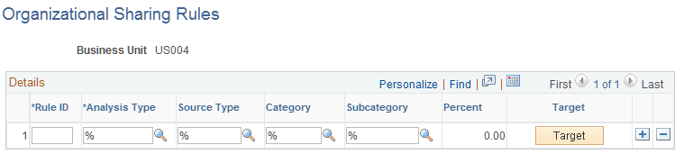

Organizational Sharing Rules Page
Use the Organizational Sharing Rules page (PSA_SHARE_RULES) to create or view the organizational sharing rules source criteria.
Navigation:
Setup Financials/Supply Chain, and then Product Related, and then Project Costing, and then Sharing Structure, and then Setup PC Sharing Rules
This example illustrates the fields and controls on the Organizational Sharing Rules page. You can find definitions for the fields and controls later on this page.
Field or Control Description
Analysis Type
Select the analysis type for transactions that the system uses to determine source criteria.
Source Type
Select the broadest category of transaction source definitions.
Category
Select a category to further define the source type.
SubCategory
Select a subcategory to further define the category.
Percent
Displays the percentage being shared according to this rule. You define this field on the Organizational Sharing Rules - Target Definition page.
Target
Click to access the Organizational Sharing Rules - Target Definition page to define the percentage and target rows for this rule.

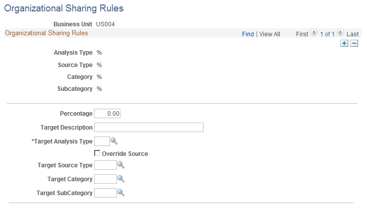

Organizational Sharing Rules - Target Page
Use the Organizational Sharing Rules - Target page (PSA_SHARE_RULES_LN) to define percentage and target rows for the selected sharing rule.
Navigation:
Click Target on the Organizational Sharing Rules page.
This example illustrates the fields and controls on the Organizational Sharing Rules - Target page. You can find definitions for the fields and controls later on this page.
Percentage
Enter the percentage of the transaction amount to be shared.
Target Analysis Type
Enter the analysis type for the new transaction row being created.
Override Source
Select the check box to override the values for the source type, category, and subcategory on the target row with the values in the Source Type, Category, and SubCategory ChartFields on this page. Select the check box and leave the Source Type, Category, and SubCategory ChartFields blank for the fields to appear blank in the target row.
Deselect the check box for the target row to inherit the field values from the original transaction.
If you selected Copy original/create discount on the Organizational Sharing Options page, a second section appears on this page. Specify the description, analysis type, resource type, category, and subcategory for the discount row.
