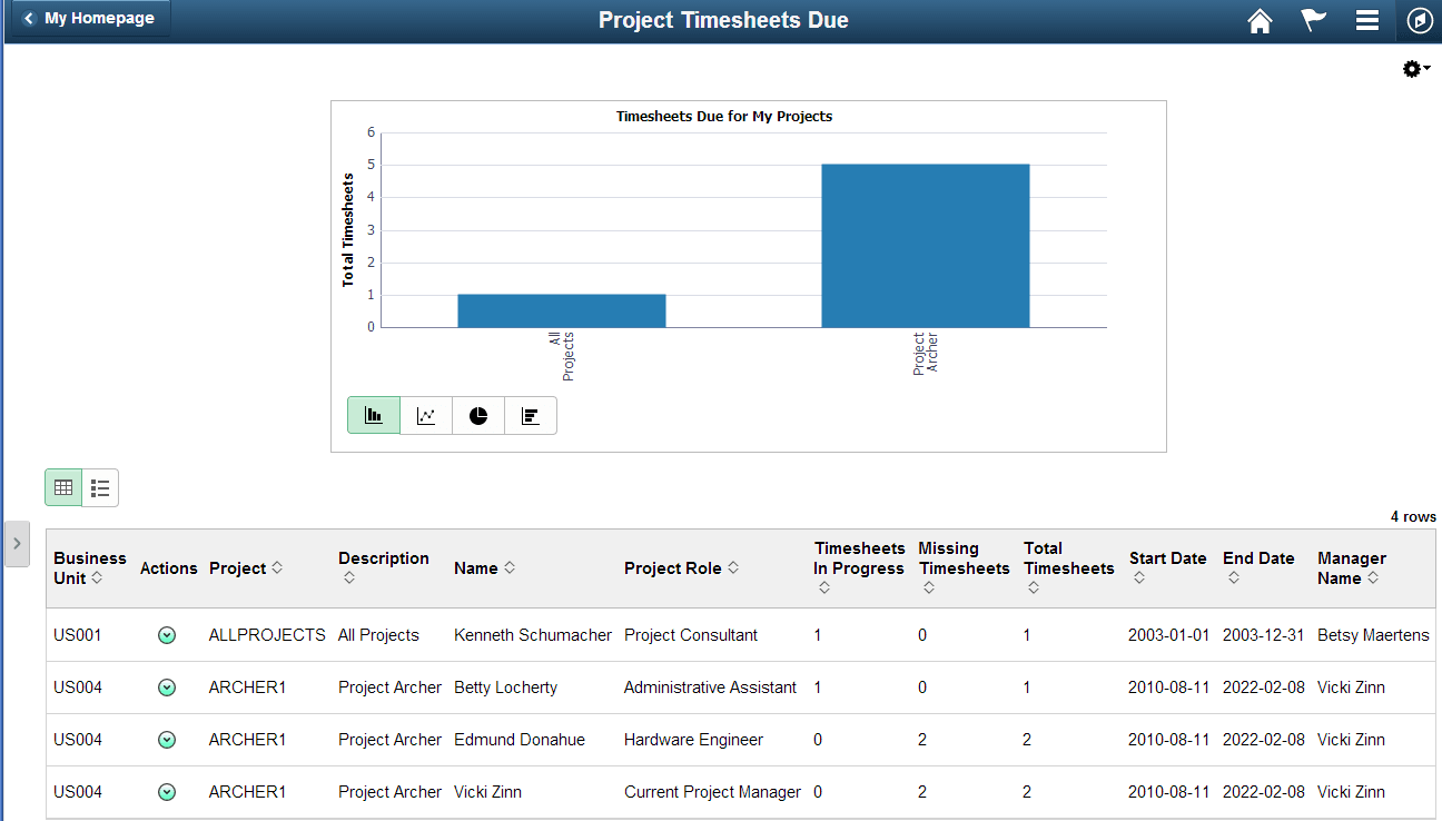

Project Timesheets Due (pivot) Page
Use the Project Timesheets Due (pivot) page to view timesheets that are in progress and missing for all projects or a specific project.
Navigation:
Fluid Home, and then Project Management, and then Project Timesheet Due
This example illustrates the fields and controls on the Project Timesheets Due (pivot) page.
The Project Timesheets Due chart and page displays timesheets that are in-progress and missing for the resources on the projects from your Projects List Page.
Field or Control Description
Options Menu icon (options menu)
Select the Options Menu icon to access these options:
  • View Pivot Grid
  • Update Filters
  • Export Data
  • Chart Options
  • Save
(item on chart)
Select a project on the chart to access these options:
  • Detailed View: Select to view the grid below the chart for only the resources associated with the selected project.
  • Drill down To: Name: Select to view the chart by resource name for the selected project.
Related Actions icon (actions)
Select the Actions icon to access these options:
  • View Timesheet Details: Select to access the Project Timesheets Due (detail) Page.
  • View Resource Details: Select to access the View Resource Details page.
  • Notify Resource: Select to access the Notify Resource page.
  • Notify Manager: Select to access the Notify Manager page.
Timesheets In Progress
Displays the number of timesheets that are in progress.
Missing Timesheets
Displays the number of missing timesheets that are from projects that have an end date that is equal to the current date or a date in the future. Projects that have end dates that are in the past are excluded.
In addition, at least one person on the team must have created a timesheet for the same project, same PeopleSoft Expenses business unit, and where their timesheet period end date is between the other resource’s start and end date on the project team.

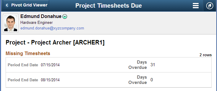

Use the Project Timesheets Due (detail) page (PC_LATETIMESH_FL) to view timesheets that are in progress and missing for a specific resource.
Navigation:
Fluid Home, and then Project Management, and then Project Timesheet Due. Select View Timesheet Details from the Actions icon.
This example illustrates the fields and controls on the Project Timesheets Due (detail) Page.
Project Timesheets Due page (detail)
Use this page to view missing timesheets and timesheets that are in the process of being approved.
The projects that are eligible for this page are those that are on your Projects List Page.
Related Actions icon (related actions icon)
Select the related actions icon to access these options:
  • View Business Card: Select to access the View Business Card window.
