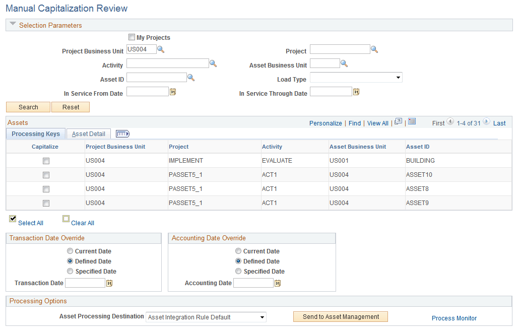

This example illustrates the fields and controls on the Manual Capitalization Review page. You can find definitions for the fields and controls later on this page.
When the asset creation trigger is Manual Capitalization Review on the Asset Integration Rules page, assets that are created from project transactions must be reviewed before they are sent to PeopleSoft Asset Management. When the asset adjustment trigger is Manual Capitalization Review, asset adjustments must be reviewed before they are sent to PeopleSoft Asset Management.
On this page you can retrieve the list of assets either by selecting the My Projects option or by entering a project business unit. Click Reset to clear the search criteria.
After you select the appropriate selection criteria, click Search to display a list of assets that require a review.
