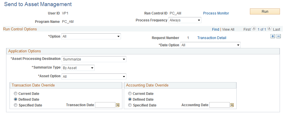

Send to Asset Management Page
Use the Send to Asset Management page (RUN_PC_AM) to run the Send to Asset Management process to send information from PeopleSoft Project Costing to Asset Management and capitalize project assets.
Navigation:
Project Costing, and then Assets, and then Sent Assets to AM
This example illustrates the fields and controls on the Send to Asset Management page. You can find definitions for the fields and controls later on this page.

Field or Control Description
Option
Select an option to run the process for all activities or for specific ones. Available options are:
All: Brings in transactions that are associated with all activities.
Business Unit: Specifies transactions that are for the selected business unit.
Business Unit/Project: Specifies transactions that are for the selected business unit and project.
Business Unit/Project/Activity: Specifies transactions that are for the selected business unit, project, and activity.
Asset Processing Destination
Select the option that determines how far the asset data flows into PeopleSoft Asset Management when you click Send to Asset Management.
If you require asset approval before sending assets to PeopleSoft Asset Management, the available options are:
Run Interface
Run Interface and Load
Summarize
If you do not require asset approval before sending assets to PeopleSoft Asset Management, the available options are:
Run Interface
Sum, Run and Load Transactions
Summarize
Summarize and Run Interface
Asset processing destination options are discussed in the Understanding Asset Capitalization Processes, Common Elements Used to Manage Assets topic.
Summarize Type
Specify a summary type if one of the summarize run options is selected. This determines how the process summarizes transactions.
By Profile: Select to summarize all transactions with the same profile. Transactions with an analysis type that belongs to the PRECL analysis group are eligible for this process.
Note: You do not have to summarize by profile in order to summarize by asset.
By Asset: Select to summarize all transactions with the same asset ID. Transactions with an analysis type that belongs to the CLOSE analysis group are eligible for this process.
You can modify which costs are included in the summarization by adding analysis types to analysis groups.
Asset Option
Select from these options to further define the process:
All: Select to process all transactions that are associated with assets or profiles.
Selected AM Unit: Select to process all transactions that are associated with assets or profiles that belong to a specific asset business unit.
Selected AM Unit / Asset ID: Select to process transactions that are associated with a specific asset ID and asset business unit.
