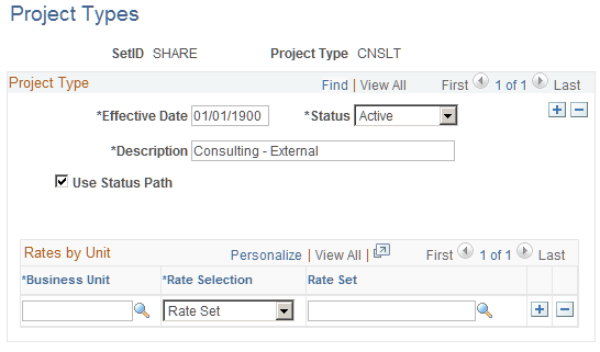

Project Types Page
Use the Project Types page (PROJ_TYPE_DEFN) to create and modify project types.
Assign default rate plans or rate sets to project types.
Navigation:
Set Up Financials/Supply Chain, and then Product Related, and then Project Costing, and then Project Options, and then Setup PC Project Types
This example illustrates the fields and controls on the Project Types page. You can find definitions for the fields and controls later on this page.
Project Types page
Use this page to set up project types that are used to group projects into clusters. Project types enable you to easily analyze all projects of a certain type. For example, you can assign construction projects, maintenance projects, and capital projects as project types.
Field or Control Description
Use Status Path
Select to use a project type status path for the project type. Use the Project Type Status Path page to define status paths.
See Project Type Status Paths.
Auto Review for Billing
Select to automatically mark all transactions for this project type as reviewed, and bypass the requirement for a project manager review. This option is available only if the Review Required for Billing option is selected on the Installation Options - Project Costing Integration page. When you create a new project and specify a project type, the project inherits the value of the Auto Review for Billing option for the project type, taking into consideration the effective date and status of the option. You can override the Auto Review for Billing option at the project type level and for individual projects.
If you change the option for the project type:
  • The system does not automatically update the auto review option at the project level.
    For example, assume that the auto review option for the project type is enabled on January 1. On January 15, the auto review option is disabled for the project type. The system does not update the auto review option on existing projects. You can, however, manually override the auto review option for individual existing projects.
  • The system does not automatically update existing transactions that reside in the Project Transaction table.
    For example, assume that the auto review option for the project type is disabled on January 1. On January 15, the auto review option is enabled for the project type. Unreviewed transactions may already exist in the Project Transaction table. You can review the existing transactions by using the Project Manager Review component.
Auto Review for Period of Performance
Select to automatically review and approve period of performance exceptions for the particular project type.
Note: This check box is displayed only if Review Required for Period of Performance check box is selected on the Application Fundamentals: Installation Options - Project Costing Integration Page.
Rates by Unit
Business Unit
Enter a business unit for which you will create projects with rates for this project type.
Rate Selection
Select Rate Plan or Rate Set to determine the column heading and available values that appear for selection in the next column on this page.
Enter the default rate plan or rate set for the project type and business unit. Available values are based on rate plans and rate sets that are valid for the business unit and are active on the effective date of the project type.
Add rows as necessary to assign default rate plans or sets to additional business units that use this project type.
Note: If you change the default rate plan or rate set on this page, the system does not automatically update the rate plan or rate set on existing projects and activities.

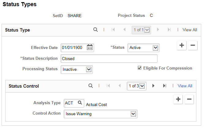

Status Types Page
Use the Status Types page (PROJ_STATUS_DEFN) to create status types and define control actions to limit transactions coming into Project Costing.
Navigation:
Set Up Financials/Supply Chain, and then Product Related, and then Project Costing, and then Project Options, and then Setup PC Project Status Types
This example illustrates the fields and controls on the Status Types page. You can find definitions for the fields and controls later on this page.
Status Types page
Effective Date
Enter the date when the status change goes into effect. Status types are effective dated, so multiple statuses can be defined and applied sequentially to a project or activity over time.
Status
Select the status of the effective-dated row. Available values are:
Active: This is the default value.
Inactive: Select to deactivate the status control options that are associated with the effective date.
Processing Status
Select the processing status to map to this status type. Available values are Active, Inactive, and Pending. When you update a project status type, the system automatically updates the processing status based on this mapping.
Eligible For Compression
Select check box to consider the particular project status type for compression. Although the processing status can be Active or Inactive, Oracle recommends only projects with processing status Inactive for compression. This way current transactions will not be affected by the compression.
Status Control
Use this group box to associate a project control action with an analysis type for a particular status type. To control transactions by using status control on a project or activity, the Enable Status Control option must be activated on the Installation Options - Project Costing Integration page, the project or activity must contain the specified status type, and the incoming transactions must contain the specified analysis type.
Analysis Type
Enter an analysis type to specify the transactions on which to apply status control options. To enter additional analysis types, add new rows in the Status Control group box.
Note: The analysis types that are used by feeder systems are defined on the Installation Options - Project Costing Integration page.
Control Action
Select a control action to associate with the analysis type. Available values are:
Warning: Select for a warning message to appear before Project Costing accepts transactions with the analysis type that you specify in the Analysis Type field.
Reject: Select for Project Costing to reject transactions with the analysis type that you specify in the Analysis Type field.
No project control action occurs if the Control Action field is blank.

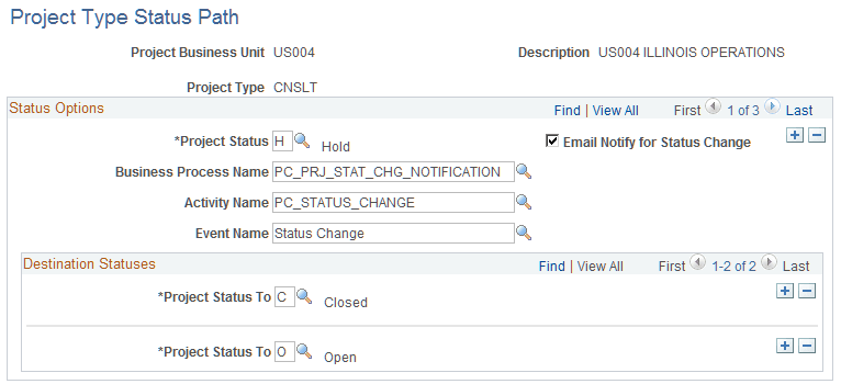

Project Type Status Path Page
Use the Project Type Status Path page (PC_PRJ_STATCTL_PNL) to define status paths for a particular project type.
Navigation:
Set Up Financials/Supply Chain, and then Product Related, and then Project Costing, and then Project Options, and then Setup PC Proj Type Status Path
This example illustrates the fields and controls on the Project Type Status Path page. You can find definitions for the fields and controls later on this page.
Project Status
Enter the status for the path that you are defining. Available values are based on the Project Status table (PROJ_STATUS_TBL).
Email Notify for Status Change
Select to email project members when the project status changes.
Business Process Name, Activity Name, and Event Name
Select the business process, activity, and event to associate with the project type status path.
Project Status To
Select the statuses to which the current status can change. Add rows to add more statuses.

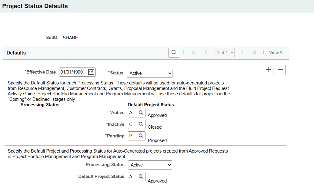

Project Status Defaults Page
Use the Project Status Defaults page (PC_STATUS_DEFAULT) to establish default project statuses for system-defined processing statuses for projects that are programmatically created.
Navigation:
Set Up Financials/Supply Chain, and then Product Related, and then Project Costing, and then Project Options, and then Setup Project Status Defaults
This example illustrates the fields and controls on the Project Status Defaults page. You can find definitions for the fields and controls later on this page.
Status
Enter the status of the project status defaults. Values are Active and Inactive. The default value is Active.
Processing Status - Active, Processing Status - Inactive, and Processing Status - Pending
Enter the default statuses to map to the Active, Inactive, and Pending processing statuses that the system assigns to autogenerated projects from PeopleSoft Resource Management, Contracts, Grants, Proposal Management, and the Fluid Project Request Activity Guide. PeopleSoft Project Portfolio Management and PeopleSoft Program Management use these default statuses only for projects that are created from project requests that are in a Costing or Declined status.
If you use PeopleSoft Project Costing without PeopleSoft Program Management, the system uses the project status that you enter for the Active processing status as the default value for new projects that you create in Project Costing.
If you use PeopleSoft Program Management, the system uses the project status that you enter for the Pending processing status as the default value for new projects that you create in PeopleSoft Project Costing.
Processing Status
Enter the default processing status that the system assigns to autogenerated projects that are created from approved project requests in PeopleSoft Project Portfolio Management and PeopleSoft Program Management.
Default Project Status
Enter the default project status to map to the processing status for projects that are created from approved project requests in PeopleSoft Project Portfolio Management and PeopleSoft Program Management.

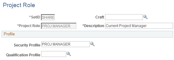

Project Role Page
Use the Project Role page (PROJ_ROLE_PAGE) to create or view project roles.
Associate a project role with a craft in PeopleSoft Maintenance Management.
Navigation:
Set Up Financials/Supply Chain, and then Product Related, and then Project Costing, and then Project Options, and then Setup PC Project Roles
This example illustrates the fields and controls on the Project Role page. You can find definitions for the fields and controls later on this page.
Project Role page
Project roles are defined by two profiles—the security profile and the qualification profile.
Craft
Select a craft from the Maintenance Management Craft table (RS_CRAFT_DETAIL) to associate with this project role. The system uses this association to assign crafts to resources when you create work orders from activities. The value that you enter in this field appears as the default value in the Craft column on the Create Work Order page for resources with this project role.
This field is available only if you use PeopleSoft Maintenance Management.
Security Profile
Enter the security profile that defines the role's access to projects, activities, and transactions. Available values are defined on the Security Profile page (PROJ_SEC_PROFILE).
See Defining Project Security.
Qualification Profile
Enter the qualification profile that the PeopleSoft Resource Management system uses for staffing. Available values are defined on the Qualification Profile page (RS_RESRC_TEMPLT) in PeopleSoft Resource Management.
See PeopleSoft Resource Management: Creating Qualification Profiles.
You must install PeopleSoft Program Management to integrate with PeopleSoft Resource Management for staffing.

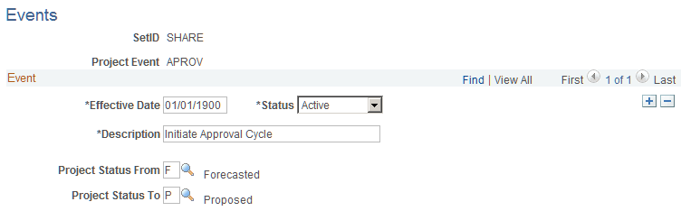

Events Page
Use the Events page (PROJ_EVENT_NAME) to create and modify project events.
Navigation:
Set Up Financials/Supply Chain, and then Product Related, and then Project Costing, and then Project Options, and then Setup Project Events
This example illustrates the fields and controls on the Events page. You can find definitions for the fields and controls later on this page.
Events page
You must define project status types before you define project events.
From Status Type and To Status Type
Enter the From Status Type and To Status Type that mark an event for a project.
Use the Project Definitions - Approval page to define approval sequences for project events.

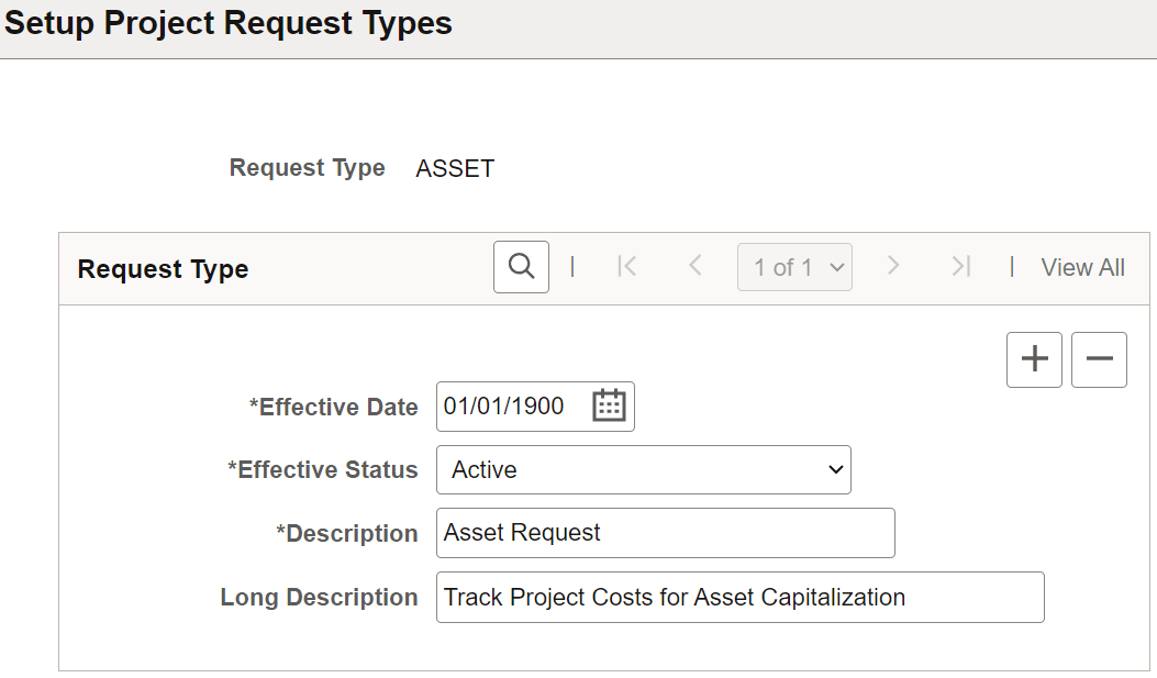

Setup Project Request Types
Use the Setup Project Request Types page (PC_REQUEST_TYPE) to create and modify project request types. The project request type is selected by the Project Requester on the Project Request Page. Customers can use the Request Type as criteria in the Page and Field Configurator to identify the fields displayed to the requester.
Navigation:
Set Up Financials/Supply Chain, and then Product Related, and then Project Costing, and then Project Options, and then Setup Project Request Types
This example illustrates the fields and controls on the Setup Project Request Types page. You can find definitions for the fields and controls later on this page.
Setup Project Request Types Page
Request Type
Select the project request type.
Effective Status
Select Active or Inactive as the effective status.
