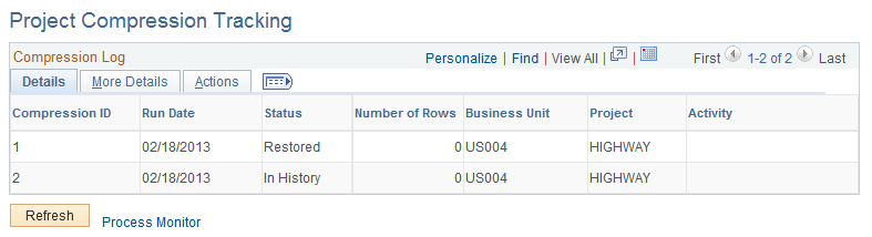

This example illustrates the fields and controls on the Project Compression Tracking . You can find definitions for the fields and controls later on this page.
Project Compression Tracking: Details tab
Use this page to view process details.
Field or Control Description
Compress ID
Displays the system-generated compression ID.
Run Date
Displays the date and time at which the compression run took place.
Status
Displays the current status of the data from a compression run or an action. Valid values are:
  • Archived: The data that was compressed has been removed from history and is located in the archive tables.
  • In History: The data that was compressed is located in the history tables.
  • Purged: The data that was compressed has been deleted from the history tables.
  • Restored: The data that was compressed has been restored to the project transaction table.
