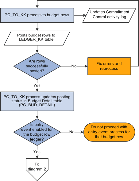

The following diagram shows a high-level process flow of using entry events in project budgeting, which begins after the Project Costing to Commitment Control process successfully posts budget rows to the Commitment Control ledger data table (LEDGER_KK), part 1:
Entry events in project budgeting process flow (1 of 2)

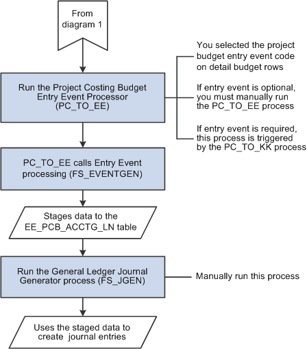

The following diagram shows a high-level process flow of using entry events in project budgeting, which begins after the Project Costing to Commitment Control process successfully posts budget rows to the Commitment Control ledger data table (LEDGER_KK), part 2:
Entry events in project budgeting process flow (2 of 2)

The Project Costing Budget Entry Event Processor uses the Entry Event Generator Application Engine process (FS_EVENTGEN) to process PeopleSoft Project Costing budget transactions and generate supplemental accounting entries. You can run the Project Costing Budget Entry Event Processor by using either of these two methods:
  • Finalize a budget plan, which triggers the Project Costing to Commitment Control budget posting process.
    After budgets are successfully posted to the general ledger, the final step in the Project Costing to Commitment Control process is to call the Project Costing Budget Entry Event Processor.
    Use this method if entry events are specified as either required or optional for General Ledger on the Installation Options - Entry Event page and required for the Commitment Control ledger group on the Ledgers For A Unit - Commitment Control Options page.
  • Manually run the Project Costing Budget Entry Event Processor on the Entry Event Budgets run control page in PeopleSoft Project Costing to reprocess budget entry events.
    Use this method if entry events are specified as either required or optional for General Ledger on the Installation Options - Entry Event page and optional for the Commitment Control ledger group on the Ledgers For A Unit - Commitment Control Options page, or if the system fails to generate the entry event journal entries.
The Project Costing Budget Entry Event Processor applies only to budget transactions, not to actual cost transactions.

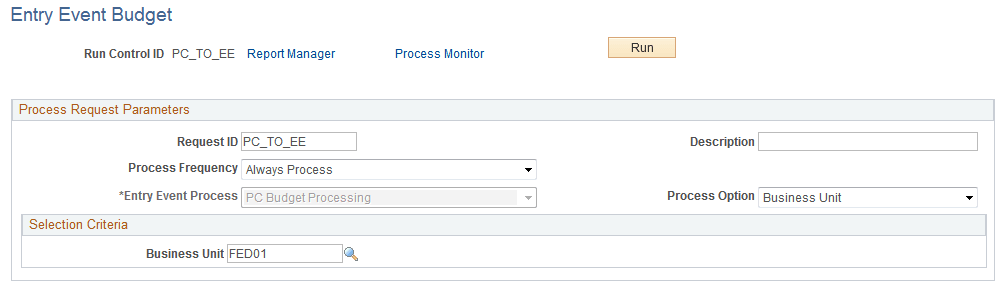

Entry Event Budget Page
Use the Entry Event Budget page (PST_EE_RUN_REQUEST) to run the Project Costing Budget Entry Event Processor to generate standard accounting entries based on the entry event code on the project budget.
Navigation:
Project Costing, and then Budgeting, and then Entry Event Budget, and then Entry Event Budget
This example illustrates the fields and controls on the Entry Event Budget page. You can find definitions for the fields and controls later on this page.
Enter a request ID and description, and select the process frequency.
Select from these process options and enter the criteria that the system uses to select transactions to process:
  • All Business Units
  • BU (business unit)/Project
  • BU/Project/Plan (budget plan)
  • BU/Project/Plan/Activity
  • BU/Project/Plan/Activity/Trans (transaction)
  • Business Unit

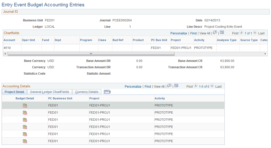

Entry Event Budget Accounting Entries Page
Use the Entry Event Budget Accounting Entries page (EE_PCBUD_DRILL) to drill into PeopleSoft Project Costing source data from a journal entry.
Navigation:
Project Costing, and then Budgeting, and then Entry Event Budget Drill Down, and then Entry Event Budget Accounting Entries
This example illustrates the fields and controls on the Entry Event Budget Accounting Entries page. You can find definitions for the fields and controls later on this page.
Enter the business unit on the Entry Event Budget Drill Down search page and optionally search for a journal by journal ID, date, GL journal line number, and ledger. The Entry Event Budget Accounting Entries page appears for you to view a list of accounting entries for the journal ID. Only transactions that are created by the Project Costing Budget Entry Event Processor appear on this page.
Field or Control Description
Budget Detail icon
Click the Budget Detail icon to drill down to the source transaction on the Budget Detail page.
