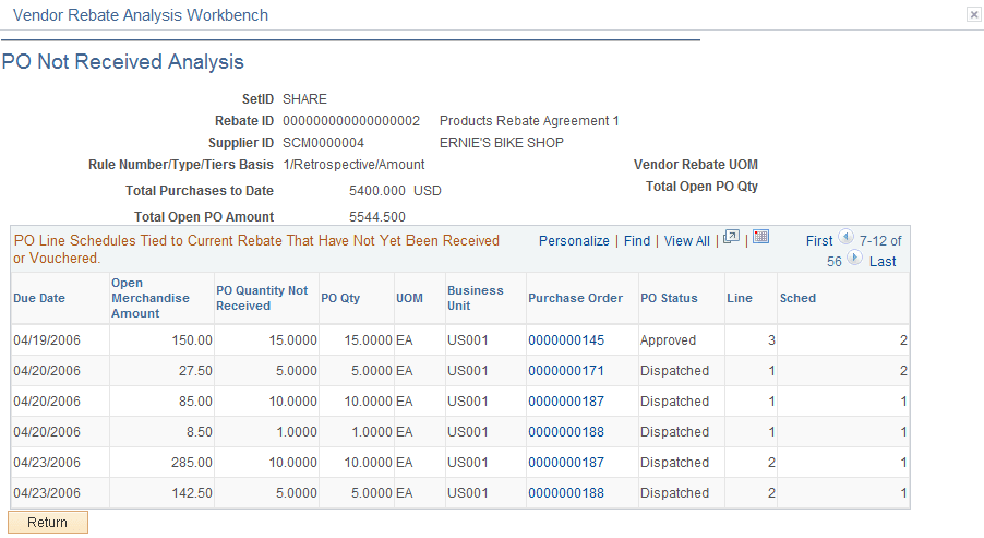

Vendor Rebate Analysis Workbench - PO Not Received Analysis Page
VRBT_PO_NRCVD
View purchase orders that are still open that are associated with the Vendor Rebate agreements.

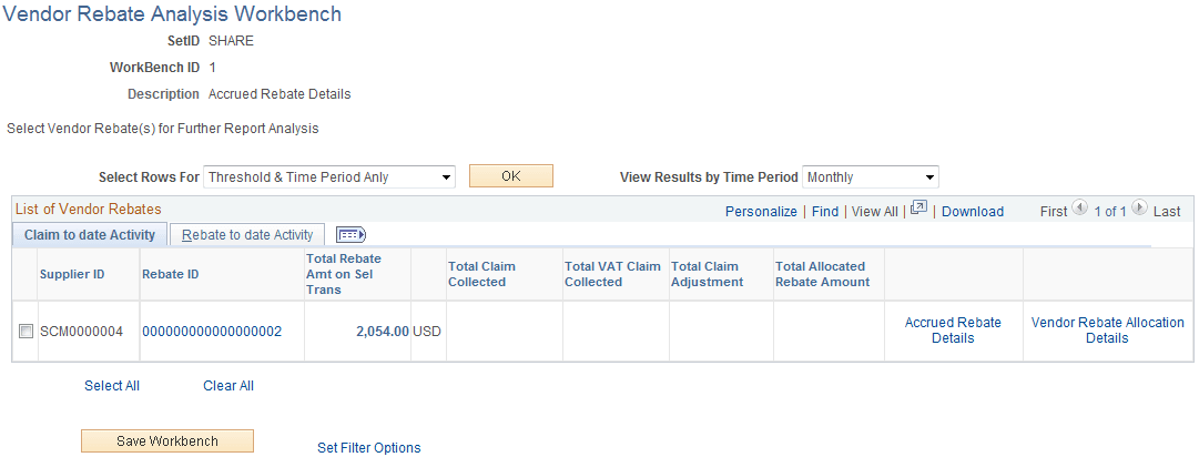

Vendor Rebate Analysis Workbench Page
Use the Vendor Rebate Analysis Workbench page (VRBT_ANLY_WB) to perform analysis on a Vendor Rebate Agreement.
Navigation:
Click the View Workbench button on the Vendor Rebate Analysis Workbench - Workbench Filter Options page.
Field or Control Description
Select Rows For
Select the type of activity that you want to perform for the Supplier rebates that you select. Activities are:
  • Extract Accrued Dtls to File: When you select this activity, the Vendor Rebate Analysis Workbench - Flat File Extraction on Rebate Transactions page appears.
    Use this page to extract the accrued rebate details to a flat file.
    See Vendor Rebate Analysis Workbench - Flat File Extraction on Rebate Transactions Page.
  • PO Not Received Report (purchase order not received report): When you select this activity, the Vendor Rebate Analysis Workbench - PO Not Received Report page appears.
    Use this page to initiate the PO Not Received SQR Report process (POVRB300).
    See PeopleSoft Purchasing Reports.
  • Rebate Threshold Report: When you select this activity, the Vendor Rebate Analysis Workbench - Rebate Threshold Report page appears.
    Use this page to generate the Rebate Threshold Report SQR Report process (POVRB200).
  • Threshold & Time Period Anly (threshold and time period analysis): When you select this activity along with a view results by time period option, the Rebate Threshold and Time Period Analysis page appears populated with the Vendor Rebate information that is associated with the Vendor rebates that you selected.
    Use this page to perform threshold and time period analysis for Vendor rebates.
    See Vendor Rebate Analysis Workbench - Rebate Threshold Analysis Page.
OK
Click this button to have the system perform the process that you requested in the Select Rows For field.
Note: You must select at least one Vendor Rebate agreement in the List of Supplier Rebates group box before any process occurs.
View Results by Time Period
Select the time period that you want to use to view the Vendor Rebate analysis. Time periods are:
  • Monthly.
  • Quarterly.
  • Yearly.
This field is available only if you select Threshold & Time Period Anly in the Select Rows For field.
List of Vendor Rebates
Selection
Select this check box next to the Vendor rebates that you want to analyze. You can analyze one or more rebates at the same time.
Rebate ID
Click a rebate ID link to access the Rebate Agreement - Rebate Agreement page. Use this page to view all the details of this Vendor Rebate agreement.
Total Rebate Amt on Sel Trans (total rebate amount on selected transactions) and Currency
Displays the total rebate amount in the rebate currency for the selected transactions.
The total rebate amount on selected transactions equals the sum of transaction line rebate amounts on the Vendor Rebate Analysis Workbench - Accrued Rebate Details page that match the filter options that you selected.
Total Claim Collected
Displays the total collected amount for a Vendor Rebate in the rebate currency.
The total claim collected equals the sum of total claimed amount for all claims that are associated with the transaction lines on the Vendor Rebate Analysis Workbench - Accrued Rebate Details page that match the filter options that you selected.
Total VAT Claim Collected (total value added tax claim collected)
Displays the total VAT claim collected amount in the rebate currency.
The total VAT claim collected equals the sum of total claimed collected VAT amount for all claims that are associated with the transaction lines on the Vendor Rebate Analysis Workbench - Accrued Rebate Details page that match the filter options that you selected.
Total Claim Adjustment
Displays the total claim adjustment amount.
The total claim adjustment equals the sum of the difference between the total claim amount minus the original total claim amount for each claim that is associated with the transaction lines on the Vendor Rebate Analysis Workbench - Accrued Rebate Details page that match the filter options that you selected.
Total Allocated Rebate Amount
Displays the total allocated rebate amount for the rebate agreement.
Click this link to access the Vendor Rebate Analysis Workbench - Accrued Rebate Details page. Use this page to view the accrued rebate details for this Vendor Rebate agreement.
Vendor Rebate Allocation Details
Click this link to access the Vendor Rebate Allocation page. Use this page to view the rebate allocation details for this vendor rebate and the sales organizations.
See Establishing Vendor Rebate Allocations.
Rebate to Date Activity
Select the Rebate to date Activity tab.
Total Accrued Rebate
Displays the total accrued amount for the vendor rebate agreement.
Total Rebate Payment Received
Displays the total payment received amount for the vendor rebate agreement.
Total Pending Rebate Amount
Displays the total pending amount for the vendor rebate agreement.
Miscellaneous Information
Save Workbench
Click this button to access the Save Workbench page. Use this page to save this vendor rebate analysis workbench and its associated information, including the filter options that you entered. At a later date, you can retrieve the workbench and continue to perform rebate analysis.
Set Filter Options
Click this link to access the Vendor Rebate Analysis Workbench - Workbench Filter Options page. Use this page to maintain the different filter options for this workbench.

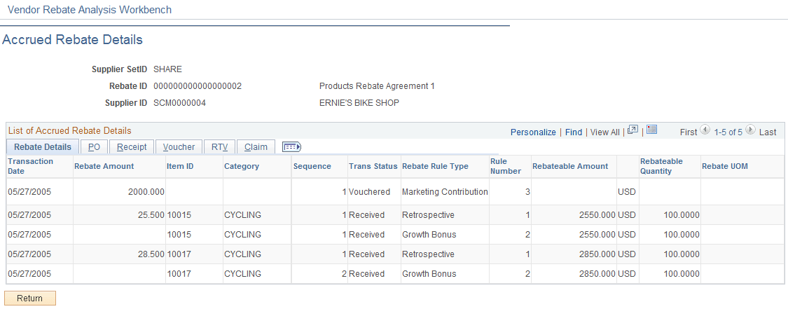

Vendor Rebate Analysis Workbench - Accrued Rebate Details Page
Use the Vendor Rebate Analysis Workbench - Accrued Rebate Details page (VRBT_ACCR_INQ) to view accrued rebate transaction details.
Navigation:
  • Click the Accrued Rebate Details link in the List of Vendor Rebates group box on the Claim to date Activity tab on the supplier Rebate Analysis Workbench page.
  • After selecting transactions, then select Threshold & Time Period Anly in the Select Rows For field and click the OK button on the Vendor Rebate Analysis Workbench page.
    Click the Accrued Rebate Details for Rule link in the List of Vendor Rebates group box on the Rebate Rule Details tab on the Vendor Rebate Analysis Workbench - Rebate Threshold Analysis page.
Rebate Details
Displays the rebate accruals that were generated by the Generate Rebate Accrual process for the rebate agreement that you selected and according to the filter options that you selected.
See Generating Rebate Accruals.
Rebate Amount
Displays the rebate amount for this transaction.
Trans Status (transaction status)
Displays the particular transaction status for the rebate accrual record. For example, if the transaction is a receipt transaction and the related voucher was not available at the time of rebate accruals generation, then the transaction status is Received. If the voucher was available for the receipt transaction at the time of rebate accruals generation or if the transaction is related to a voucher, then the transaction status is Vouchered.
See Understanding the Rebate Accrual Process.
Rebateable Amount and Currency
Displays the rebateable amount in the vendor rebate currency for this transaction.
This amount comes from the rebate accrual records that were generated by the Generate Rebate Accrual process for the receipt, voucher, or RTV transaction. The rebateable amount corresponds to the basis amount for rebate calculation.
Rebateable Quantity and (VRBT UOM) (vendor rebate agreement unit of measure)
Displays the rebateable quantity in the vendor rebate unit of measure for this transaction.
This quantity comes from the rebate accrual records that were generated by the Generate Rebate Accrual process for the receipt, voucher, or RTV transaction. The rebateable quantity corresponds to the basis quantity for rebate calculation.
Purchase Order
Use the Purchase Order Inquiry - Purchase Order page (PO_LINE_INQ) to view the complete purchase order with all its details.
Navigation:
  • Click a Purchase Order link on the PO tab on the supplier Rebate Analysis Workbench - Accrued Rebate Details page.
  • After selecting transactions, then select Threshold & Time Period Anly in the Select Rows For field and click the OK button on the supplier Rebate Analysis Workbench page.
    Click the Total Open PO Amount link in the List of supplier Rebates group box on the supplier Rebate Analysis Workbench - Rebate Threshold Analysis page.
    Click a Purchase Order link on the supplier Rebate Analysis Workbench - PO Not Received Analysis page.
Select the PO tab.
Purchase Order
Click this link to access the Purchase Order Inquiry - Purchase Order page. Use this page to view all the purchase order information that is associated with this purchase order.
Merchandise Amount
Displays the merchandise amount for this transaction.
Receipt
Select the Receipt tab.
Receiver ID Number
Click this link to access the Receipts inquiry page. Use this page to view all the details that are associated with this receipt.
Claim
Select the Claim tab.
Claim Number
Displays the claim number that is associated with the rebate accrual if the rebate accrual has already been processed by the claim generation. Click this link to access the Claim - Details page. Use this page to view all the information that is associated with this claim.
Total Claim Amount
Displays the total claim amount.
Total Claimed Amount
Displays the total claimed amount.

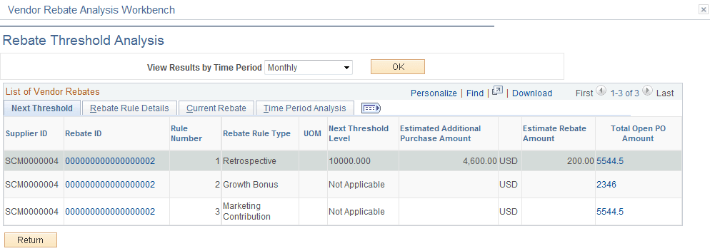

Use the Vendor Rebate Analysis Workbench - Rebate Threshold Analysis page (VRBT_THRSHLD_ANLY) to perform threshold analysis for a rebate agreement.
Threshold analysis assists rebate managers in analyzing the extent of additional purchases that are required to optimize the rebate amount.
Navigation:
This example illustrates the fields and controls on the Vendor Rebate Analysis Workbench - Rebate Threshold Analysis page. You can find definitions for the fields and controls later on this page.
Select a time period, and then click the OK button to have the system redisplay the rebate threshold analysis information for that time period.
Next Threshold
Rebate ID
Click a rebate ID link to access the Rebate Agreement - Rebate Agreement page. Use this page to view all the details of this vendor rebate agreement.
Next Threshold Level
Displays the next threshold level amount or quantity depending on the rebate agreement rule definition. This threshold level is determined based on either the current rebateable amount or current rebateable quantity.
Note: This field is applicable only for retrospective rebate rule types.
Estimated Additional Purchase Amount
Displays the estimated amount of purchases that are required to reach the next threshold level for the vendor rebate.
Estimated Additional Purchase Amount = (Next Threshold Level − Current Rebateable Amount)
Note: This field is applicable only for retrospective rebate rule types and amount based rules.
Estimated Additional Purchase Quantity
Displays the estimated quantity of purchases that are required to reach the next threshold level for the vendor rebate.
Estimated Additional Purchase Quantity = (Next Threshold Level − Current Rebateable Quantity)
Note: This field is applicable only for retrospective rebate rule types and quantity based rules.
Estimate Rebate Amount
Displays the estimated rebate amount if the next threshold is reached for the vendor rebate. This amount is based on the rebate agreement rule and the rule details.
If the rebate factor qualifier is percentage and the rebate tier basis equals amount, then Estimate Rebate Amount = (Next Threshold Level (lower) Amount × Rebate Factor).
If the rebate factor qualifier is percentage and the rebate tier basis equals quantity, then the estimated rebate amount cannot be determined because purchase amount cannot be determined.
If the rebate factor qualifier is amount and the rebate tier basis equals amount or quantity, then Estimate Rebate Amount = (Rebate Factor of the Next Threshold Level + the sum of the rebate factor for all the lower threshold levels).
Total Open PO Amount (total open purchase order amount)
Click this linked value to access the Vendor Rebate Analysis Workbench - PO Not Received Analysis page. Use this page to view purchase order schedules that are associated with the vendor rebate that have not been received or vouchered.
Click this link to access the Vendor Rebate Analysis Workbench - Accrued Rebate Details page. Use this page to view accrued rebate details for the vendor rebate agreement rule.
Use the Vendor Rebate Analysis Workbench - PO Not Received Analysis page (VRBT_PO_NRCVD) to view purchase orders that are still open that are associated with the vendor rebate agreements.
Navigation:
This example illustrates the fields and controls on the Vendor Rebate Analysis Workbench - PO Not Received Analysis page. You can find definitions for the fields and controls later on this page.
Total Purchases to Date
Displays the total purchases to date amount for this vendor rebate.
Displays the total open purchase order amount for this vendor rebate agreement rule.
Total Open PO Qty (total open purchase order quantity)
Displays the total open purchase order quantity for this vendor rebate agreement rule. The total open purchase order quantity is not relevant to the amount based rule.
Purchase Order
Click this link to access the Purchase Order Inquiry - Purchase Order page. Use this page to view the details for this purchase order.
