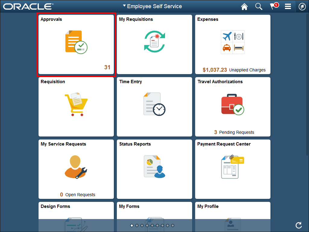

Using the Approvals tile on the Employee Self Service page, you can manage approvals for supplier user registration. These are requests from existing suppliers to access the supplier portal.
Approvals tile in the Fluid User Interface
Approvals tile

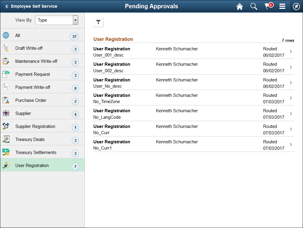

Use the Pending Approvals - User Registration page (EOAWMA_MAIN_FL) to review a list of all supplier user registrations that are pending your approval.
Navigation:
Approvals (tile), and then Select User Registration in the approval list panel on the left side of the page.
This example illustrates the fields and controls on the Pending Approvals - User Registration page.
Pending Approvals - User Registration Page
Select the Filter button to access the Filters page. Use the filter to refine the results displayed in the pending approvals list.

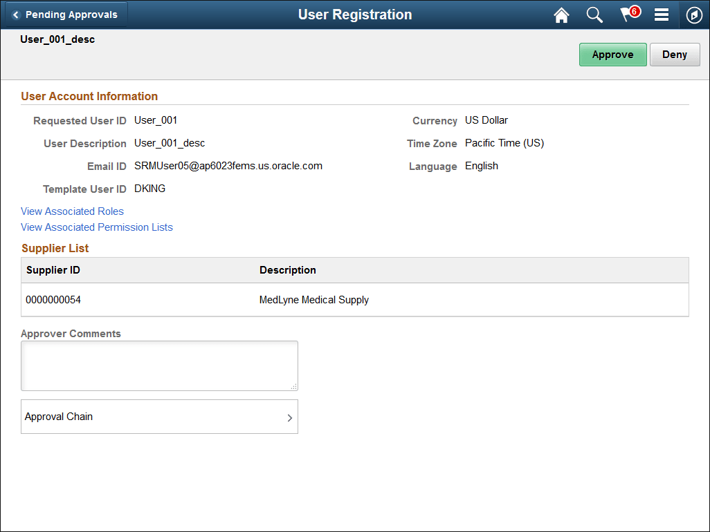

Select an individual User Registration row to access the User Registration - Approval Header Detail page and review supplier user account and supplier information. You can also approve or deny the supplier user registration from the page.

Use the User Registration - Approval Header Detail page (EOAWMA_TXNHDTL_FL) to review supplier user account and supplier information, and approve or deny the user registration.
Navigation:
Select an individual User Registration row from the Pending Approvals - User Registration page.
This example illustrates the fields and controls on the User Registration - Approval Header Detail page.
User Registration - Approval Header Detail Page
Review supplier user account and supplier information.

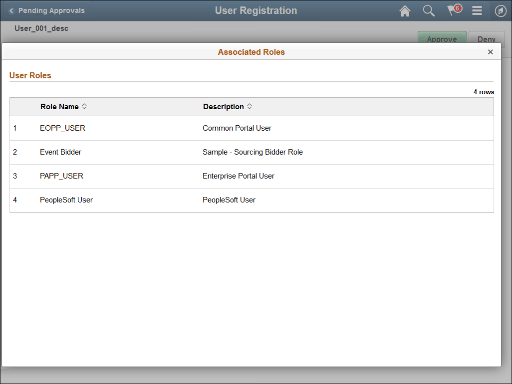

Click View Associated Roles to access the Associated Roles pagelet and view roles associated with the user.

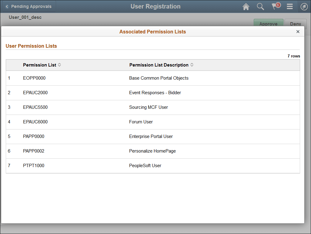

Click View Associated Permission Lists to access the Associated Permission Lists pagelet and view permission lists associated with the user.
Click Approval Chain to access the Approval Chain pagelet and view the approval hierarchy.
Click Approve to approve the transaction. The system prompts you to provide comments and submit the approval. This action routes the approval to the next approver in the chain. The final approval triggers the creation of the supplier user account. In addition, the supplier receives a notification that confirms their new supplier user account information.
Click Deny to deny the transaction. The system prompts you to provide a denial reason (Reason Code) and comments, and submit the denial. When you deny a transaction, the supplier user account is not created, the status changes to Denied, and the transaction is removed from the approval queue.

Use the Associated Roles page (SUP_USR_ROLES_FL) to view roles associated with a specific user.
Navigation:
Click the View Associated Roles link on the User Registration - Approval Header Detail page.
This example illustrates the fields and controls on the Associated Roles page.
Associated Roles Page

Use the Associated Permission Lists page (SUP_USR_PERMLST_FL) to view permission lists associated with a specific user.
Navigation:
Click the View Associated Permission Lists link on the User Registration - Approval Header Detail page.
This example illustrates the fields and controls on the Associated Permission Lists page.
Associated Permission Lists Page
