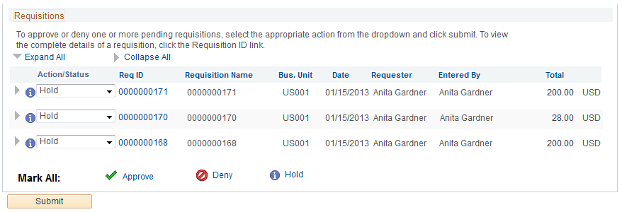

  • Approve, deny, or hold multiple requisitions at one time using the mass approval feature on the Manage Requisition Approvals page.
  • Approve, deny, or hold requisitions at the header level using the Manage Requisition Approvals page.
  • Approve, deny, or hold requisition lines using the Manage Requisition Approvals page.
  • Approve, deny, or hold requisition lines using the Requisition Approval page where you can view more details and add ad hoc approver and reviewers.

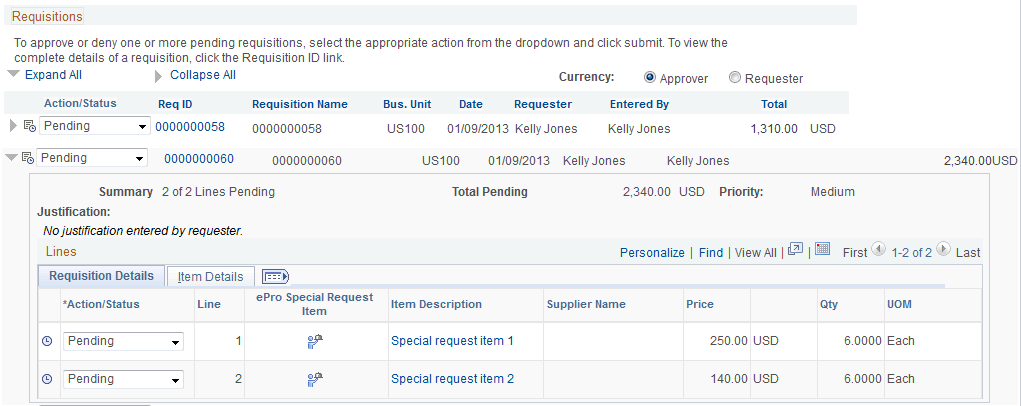

To approve, deny, or hold multiple requisitions using the mass approval feature:
  1. Go to the Manage Requisition Approvals page.
  2. Select the Approve, Deny, or Hold button on the Mark All row. All displayed requisitions are marked with this action in the Action/Status field.
  3. Change the Action/Status field for any requisitions that you do not want included in the mass approval action.
  4. Click the Submit button.

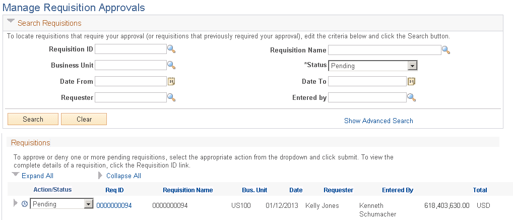

Use the Manage Requisition Approvals page (PV_APP_MAN_PG) to view and take action on requisitions that require your approval or requisitions that previously required your approval.
Navigation:
Purchasing, and then Requisitions, and then Manage Requisition Approvals
This example illustrates the fields and controls on the Manage Requisition Approvals page (partial page). You can find definitions for the fields and controls later on this page.
To approve, deny, or hold requisitions (header level) using the Manage Requisition Approvals page:
  1. Select a requisition that is in pending status.
  2. Select the Approve, Deny, or Hold option in the Action/Status field.
  3. Click the Submit button at the bottom of the page.

To approve, deny, or hold one or more requisition lines from the Manage Requisition Approvals page:
  1. Expand a requisition in the Requisitions group box so that the lines are displayed. You can only approve, deny, or hold lines that are in a pending status.
  2. Using the Action/Status field at the requisition line level, select an option for each requisition line that you want to approve, deny or put on hold.
This example illustrates the fields and controls on the The Requisitions group box within the Manage Requisition Approvals page (partial page). You can find definitions for the fields and controls later on this page.

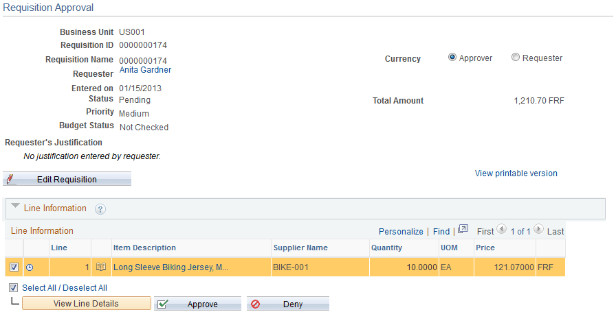

To approve, deny, or hold requisition lines using the Requisition Approval page:
  1. On the Manage Requisition Approvals page, select the Requisition ID link to access the Requisition Approval page. This page displays the lines within one requisition that are pending an approval action.
  2. In the Line Information group box, select one or more requisition lines by selecting the check box next to the line. You can also use the Select All option. You can only take action on lines that are in the pending status.

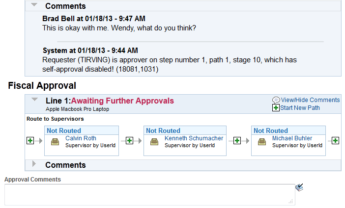

  3. Enter comments in the Enter Approver Comments section at the bottom of the page. A comment is required before you can deny or hold a requisition line. Only one comment is allowed per save.
  4. Click the Approve, Deny, or Hold button.
This example illustrates the fields and controls on the The Requisition Approval page (partial page). You can find definitions for the fields and controls later on this page.

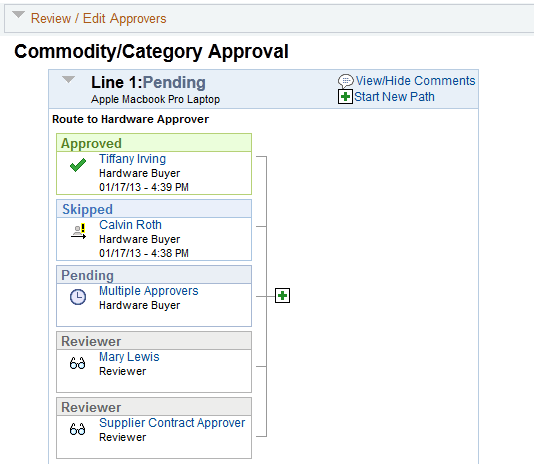

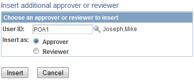

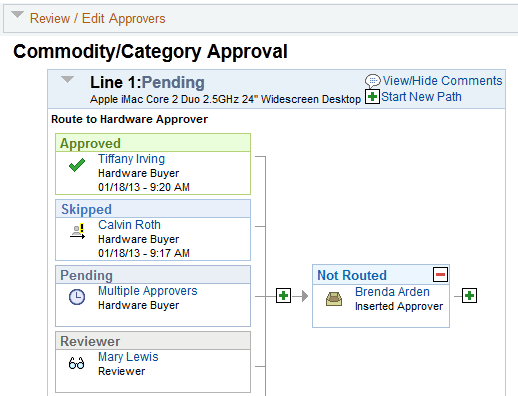

Insert Ad Hoc Approvers
To insert ad hoc approvers and reviewers, go to the Requisition Approval page and click the plus + icon for a pending requisition line. The Insert additional approver or reviewer window appears for you to select the user ID and to indicate whether the person is an ad hoc approver or reviewer for this line.
You cannot change ad hoc approvers or reviewers; however, you can delete and add them again to indicate whether they are approvers or reviewers. To delete an approver or reviewer, click the minus – icon. To add multiple approvers or reviewers, click + at the point where you want the additional approver or reviewer to receive the approval.
Use the Ad Hoc User List field on the Configure Transactions page to limit the users that can be added as ad hoc approvers and reviewers. If this field is left blank, then any active user can be added as an ad hoc approver or reviewer.
When you click the + icon on the Review/Edit Approvers section of the Requisition Approval page, the following window appears:
This example illustrates the fields and controls on the Insert additional approver or reviewer page. You can find definitions for the fields and controls later on this page.
Insert additional Approver or Reviewer page
This example illustrates the fields and controls on the Review/Edit Approvals section after an ad hoc approver has been added (partial page). You can find definitions for the fields and controls later on this page.

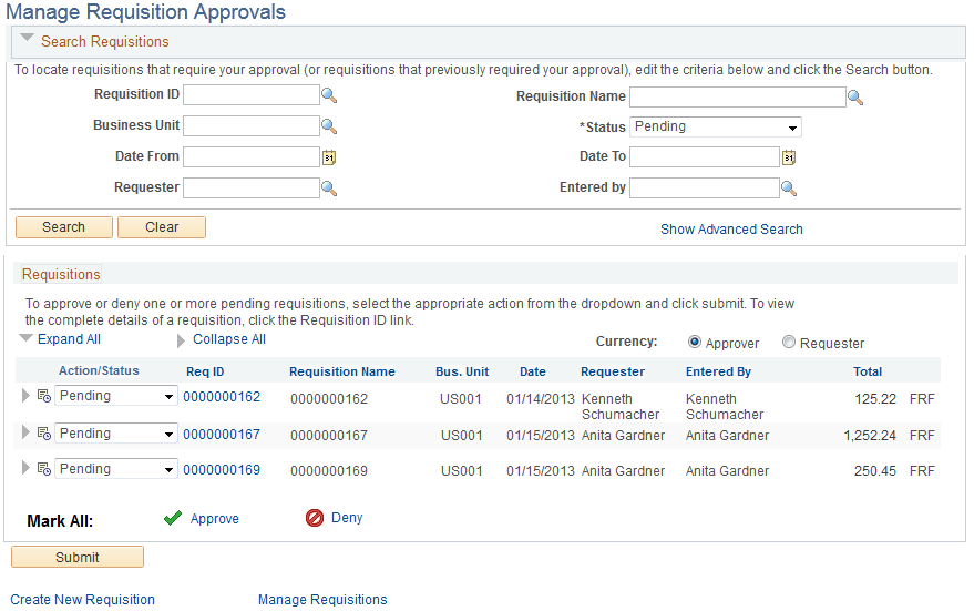

Manage Requisition Approvals Page
Use the Manage Requisition Approvals page (PV_APP_MAN_PG ) to view and take action on requisitions that require your approval or requisitions that previously required your approval
Navigation:
This example illustrates the fields and controls on the Manage Requisition Approvals page. You can find definitions for the fields and controls later on this page.
The Manage Requisition Approvals page enables you to view and take action on requisitions that require your approval or view requisitions that previously required your approval.
Use the Search Requisitions group box to search for requisitions needing your approval. Requisitions displayed are based on the user ID of the person accessing this page. You can limit the scope and number of requisitions that appear on the page. For example, you can limit the search results to a specific business unit, requester, or approval status. After displaying the requisitions, you can select individual requisitions to review and update.

Mark All
Use the Mark All row to perform a mass approval action on several requisitions at one time. After using the Mark All row, you must save (submit) the page to perform this action. Possible actions are:
  • Click Approve to mark all displayed requisitions as Approve in the Action/Status field.
  • Click Deny to mark all displayed requisitions as Deny in the Action/Status field.
  • Click Hold to mark all displayed requisitions as Hold in the Action/Status field.
Requisition Approval Page
Use the Requisition Approval page (PV_REQ_APPROVAL) to .perform approval tasks on one individual requisition. You can view requisition details, enter comments, add ad hoc approvers and reviewer, as well as approve, deny, or hold a requisition line.
Navigation:
  • Purchasing, and then Requisitions, and then Manage Requisition Approvals. Click the Requisition ID link.
  • Worklist, and then Worklist. For the work item, and then Approval Routing, and then click the requisition link on the row.
This example illustrates the fields and controls on the Requisition Approval page (1 of 3). You can find definitions for the fields and controls later on this page.
This example illustrates the fields and controls on the Requisition Approval page (2 of 3). You can find definitions for the fields and controls later on this page.
This example illustrates the fields and controls on the Requisition Approval page (3 of 3). You can find definitions for the fields and controls later on this page.
Use the Requisition Approval page to perform your approval tasks on a single requisition, including:
  • Approving one or more requisition lines. The line-level approval can be used only if the process ID is configured for line-level approval on the Register Transactions page.
  • Denying one or more requisition lines.
  • Placing one or more requisition lines on hold. This action inserts the requester as an ad hoc reviewer and requires you to enter comments to be sent to the requester.
  • Pushing back one or more requisition lines. A pushback returns the line to the previous approval step.
  • Adding or removing ad hoc approvers or reviewers.

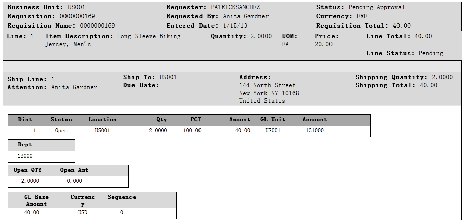

  • Reviewing an online requisition that shows the layout of the printed version.
  • Making comments to be viewed by other approvers or reviewers.
The page displays details about the requisition, such as the requester, the date it was entered, the requisition name and ID, and the requisition priority. Also appearing is the total monetary value of the requisition and the currency used.
If you select a line that does not require action, you receive a message telling you to select a line that is pending an approval.

Line Information
Use this section of the Requisition Approval page to review requisition line details and perform approval tasks. Line items that are awaiting approval are highlighted and selected as default values when you access the page.
Field or Control Description
pending approval
The Awaiting Approval icon displays with a requisition line to indicate the line is pending approval.
Item Description
Click this link to view details about an item contained on a requisition. As you review approvals, you can see the item details and an image of the item.
Requester's Comments
Click to review comments made by the requester about a requisition line item.
Select All/Deselect All
Click to either select all line items or to clear all line item check boxes. You can select this check box to approve, deny, or hold all lines or select individual check boxes to for single lines.
View Line Details
Click to access the Requisition Line Details page where you can view details about the requisition line items that you selected.
Approve
Click to approve the selected requisition line items. When you approve a line- or header-level item, the system routes the requisition line to the next approver and updates the approval status for the line.
Deny
Click to deny the selected requisition line items. Before the system accepts a denial, you must enter comments indicating why you did not approve the lines.
Hold
Click to put the selected requisition lines on hold. You must enter a comment that is sent to the requester. The requester is added as an ad hoc reviewer to this approval step.
Pushback
Select Pushback to return an approved requisition back to the previous approver or the requester with comments. This is possible only if there was a previous approver in the same path. You cannot push back a requisition across stages.
Use this section of the Requisition Approval page to review the approval flow, such as who approved the requisition before you and who will approve it after you. Click the plus + symbol to insert ad hoc approvers and reviewers. If you want to remove an ad hoc approver or reviewer click the minus — symbol.
All qualified ad hoc approvers or reviewers must be defined as part of the Ad Hoc User List on the Configure Transactions page.
Use this section to enter comments about the requisition. If you deny a requisition, the system requires that you enter a comment.
Requisition Line Details Page
Use the Requisition Line Details page (None) to view details about requisition line items.
Navigation:
Select one or more lines.
Click the View Line Details button on the Requisition Approval page.
This example illustrates the fields and controls on the Requisition Line Details page. You can find definitions for the fields and controls later on this page.
Use this page to review shipping and accounting details for line items that you selected to review using the Requisition Approval page.
