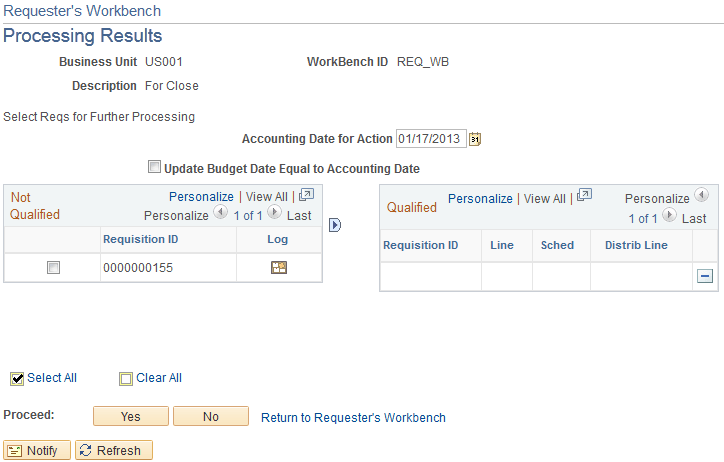

Requester's Workbench - Processing Results Page
REQ_RC_WB_RSLT
View processing results returned when you take an action on selected requisitions.

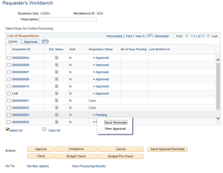

Use the Requester's Workbench page (REQ_RC_WB) to use the Requester's Workbench to analyze, approve, unapprove, cancel, and close requisitions.
Navigation:
Click the Search button on the Requester's Workbench - Filter Options page.
This example illustrates the fields and controls on the Requester's Workbench page. You can find definitions for the fields and controls later on this page.
Requesters Workbench page
You use the Requester's Workbench to maintain requisitions that were returned using the search criteria that you entered. You can select a single or multiple requisitions to maintain. After selecting the requisition, click an action to start processing the requisitions. The system displays the Processing Results page, where you can select to proceed with the action.

Approval
Select the Approval tab.
Field or Control Description
Requisition Status
Displays a Related action drop down for pending requisitions. The drop down will have the following values:
  • Send Reminder – Select to send reminders to all the Approvers with whom the Requisition is pending. Reminders will be sent in the form of email, worklist or both, depending on the set up in transaction configuration. This action displays when the Can Send Approval Reminder checkbox is selected in the User preference and the requisition status is Pending.
    Note: The Send Reminder option in the drop down is available when using PeopleTools 8.54. Select lines and click on the button Send Approval Reminder when drop down option is unavailable.
  • View Approval — Displays requisitions and approval workflow information. If the requisition is pending at line level, List of Lines Pending will also be shown in addition to Approver information. The user can select lines for which he wants to send reminder and click Send Approval Reminder in the Requisitions List page. This action displays when Approval Framework is enabled for the business unit and the requisition status is Pending or Approved.
No of Days Pending
Displays the number of days the Requisition has been pending with the current Approver. When the approval is pending at header level, the number of days pending will display. When multiple lines are pending approval and each line has the same number of days pending, the No of Days Pending will show the value. If any of the lines have a different number of days pending, (Multiple Values) will display.
Last Notified on
Displays when the last notification was issued to the user. In case of escalations the latest notified date time will be displayed either through NEM or through Requester’s workbench, whichever is recent.
If the last notified date is available, it will be displayed if Approvals are pending at the Header level. If notified date is not available, the field remains blank. In case if approval is pending at the Line level and last notified dates are not same, it will be displayed as (Multiple values). This field will be blank if no notification is sent for the lines.

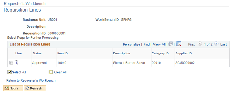

Requester's Workbench - Requisition Lines Page
Use the Requester's Workbench - Requisition Lines page (REQ_RC_WB_LN) to view requisition lines that are associated with the selected requisition.
Navigation:
Click the Lines button for a requisition on the Requester's Workbench page.
Use this page to select or clear requisition lines. You can also select Select All or Clear All to make updates. Click Return to Requester's Workbench to include the selected requisition lines in further processing.
This example illustrates the fields and controls on the Requester's Workbench - Requisition Lines page. You can find definitions for the fields and controls later on this page.
Requesters Workbench - Requisition Lines Page
List of Requisition Lines
Line
Click the Line Number link to access the schedule for the line.
When the approval is pending at the line level, the user will have to select from the List of Requisition Lines, and then click Send Approval Reminder in Requester's Workbench page to send reminder approvals.
You can select or clear Requisition lines, and then select the Return to Requester's Workbench link to select requisition for further processing.
Use the Requester's Workbench - Processing Results page (REQ_RC_WB_RSLT) to view processing results returned when you take an action on selected requisitions.
Navigation:
  • Click an Action button on the Requester's Workbench.
  • Click the View Processing Results link on the Requester's Workbench.
This example illustrates the fields and controls on the Requester's Workbench - Processing Results page. You can find definitions for the fields and controls later on this page.
The system reviews the documents for the action taken on the Requester's Workbench page and determines whether the requisitions are qualified for that action.
Override
When you close the requisition, click the Override button to move not qualified requisitions in the Not Qualified group box to be qualified for the action in the Qualified group box.
When closing the requisition, the system displays this button, which you can click to override the edits on selected lines that are not qualified if you have the authority to do so. This makes the lines available for closing and moves the lines to the qualified side.
To give a user authority to override nonqualified requisitions, click the Override Non-Qualified Requisitions for Close check box on the User Preferences - Procurement: Requisition Authorizations page.
Note: This button will only be available if the user has the authority to override nonqualified purchase orders for close.
See Application Fundamentals: User Preferences – Requisition Authorizations Page.
Accounting Date for Action and Update Budget Date Equal to Accounting Date
Displays the accounting date for action, which is used to determine the open period or allowable open date range for budget checking a requisition when you are using commitment control. The system updates the accounting dates with this date for the requisitions being closed or canceled by using the Requester's Workbench.
Log button
Click the Log icon to access the Requester's Workbench - Processing Log page. This page is a log for the selected nonqualified requisition that states why the requisition was not qualified for the previous processing action.
Yes
Click this button to proceed with the processing of the qualified requisitions. The system prompts you to confirm this selection.
Delete
Click this button to cancel the processing.
