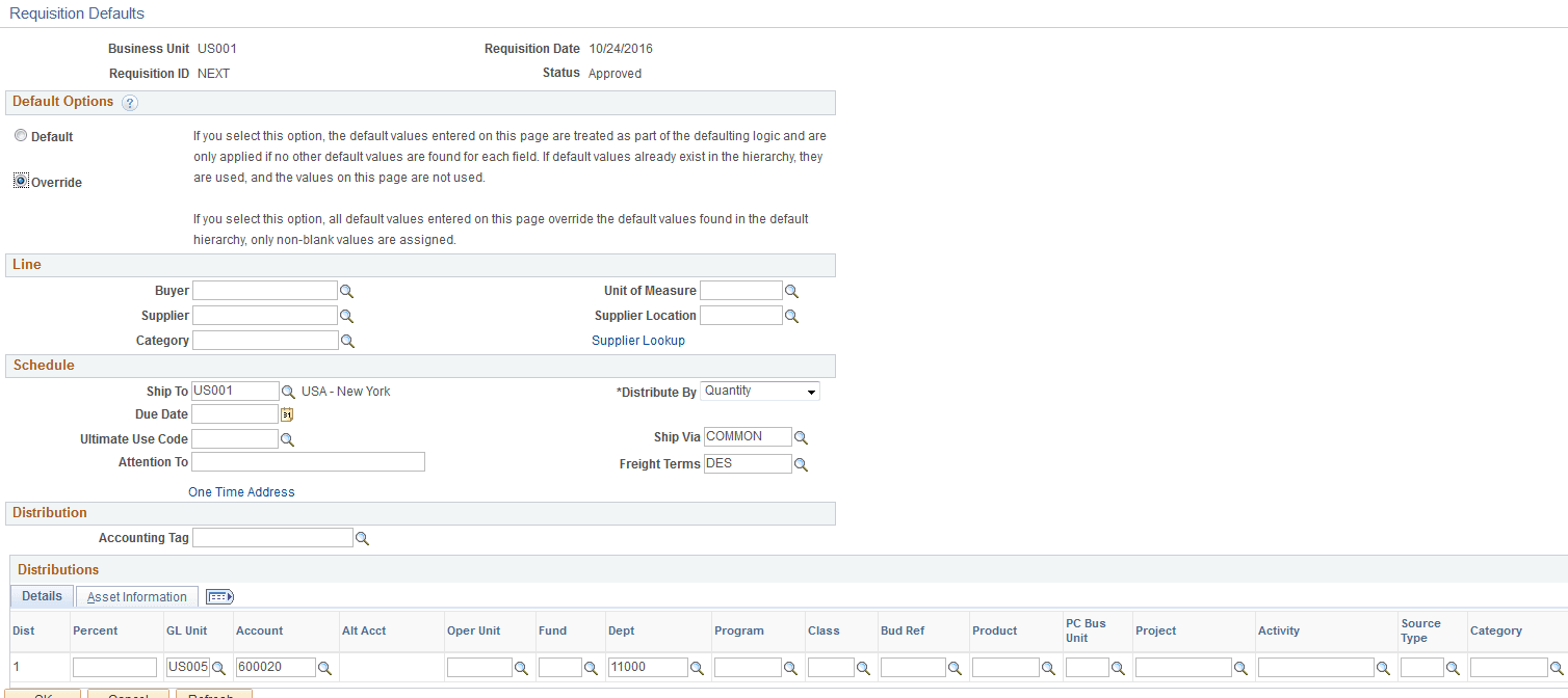

Requisition Defaults Page
Use the Requisition Defaults page (REQ_HDR_DEFAULTS) to enter defaults that apply to the entire requisition.
You can override defaults at the line, schedule, and distribution levels.
Navigation:
Click the Requisition Defaults link on the Maintain Requisitions - Requisition page.
This example illustrates the fields and controls on the Requisition Defaults page. You can find definitions for the fields and controls later on this page.
When you change the default requisition header information and exit this page, whether you use the Default or Override option, the system prompts you with the Retrofit Field Changes to All Existing Requisition Lines/Schedule/Distributions page.
Default Options
| Field or Control | Description |
Default |
If you select this option, the new default value that you enter on this page is assigned to the given field if no other value is assigned from prior defaults. |
Override |
If you select this option, the new value that you enter on this page overrides any value that is assigned from prior defaults. Only nonblank values are assigned. Note: If you are maintaining a requisition that is associated with a PeopleSoft Maintenance Management work order, the system does not override the changes that you make on this page for PeopleSoft Project Costing information (PC Business Unit, Project, and Activity fields) and asset information (AM Business Unit and Profile ID). The system does not apply project changes to the distribution rows because the work order is linked with projects information and you cannot change these values in PeopleSoft Purchasing. Plus, the asset information changes are not applied because distributions linked with a work order noninventory cannot be received as assets. |
Line
Buyer |
Select a default buyer for this line. |
Unit of Measure |
Select a default unit of measure for the requisition. Selecting a default value here can help enable you to request ad hoc (description-only) items. |
Supplier |
Select a supplier. |
Supplier Location |
Select a supplier location. |
Category |
Select a default category code for the requisition. Selecting a default value here can facilitate the ability to request ad hoc (description-only) items. |
Supplier Lookup |
Click to search for a supplier. |
Schedule
Ship To |
Select the default location where the supplier will ship the order. |
Due Date |
Enter the default shipment due date to populate the requisition schedule. If you don't specify a due date here, when you source the requisition to a purchase order, the system derives the due date by incrementing the purchase order date by the number of lead time days defined for the item. If the item is not defined in the system, or if ordering by description-only, the due date becomes the purchase order due date by default. Note: If the PeopleSoft Inventory business unit associated with the ship to location requires closure calendar validation and processing for receiving activities as defined on the Closure Calendar page and the due date that you enter here falls on a defined closure date, the system issues a warning. You can choose to keep the invalid date, or use the next valid date on the calendar. |
Ultimate Use Code |
Select an ultimate use code to override the default tax rate for a location. In most cases, sales tax is computed as a use tax based on the tax code applicable to the ship to or usage destination. However, how merchandise is ultimately used may also result in a different tax rate within the same ship to or usage destination. |
Distribute by |
Select to distribute by either amount or quantity. When you select the Override option on this page, you can set up multiple distribution lines. You then enter the percentage for each distribution in the distribution details. The sum of the line distribution percentages must equal 100 percent. |
Attention To |
Enter the person to whom, or place to where the services or goods are to be delivered. You can enter a new value or override the existing value. The system includes this field value on outbound purchase orders to the Marketplace. |
Ship Via |
Select the Ship Via Code. |
Freight Terms |
Select the Freight Terms Code. Note: The Ship Via and Freight Terms codes displayed as default are copied from the Purchasing Options page. |
Liquidate by |
Liquidate the outstanding pre-encumbrance and encumbrance balances by amount or quantity. Note: This field is available only if commitment control is enabled and you choose the Liquidate by Quantity option on the Purchasing Definition - Business Unit Options page. If commitment controlled is not installed, or you do not choose the option to liquidate by quantity on the purchase order business unit page, the budget processor balance will liquidate by amount only. |
One Time Address |
Click to access the Req One Time Address Default page, where you can temporarily assign a supplier address. |
