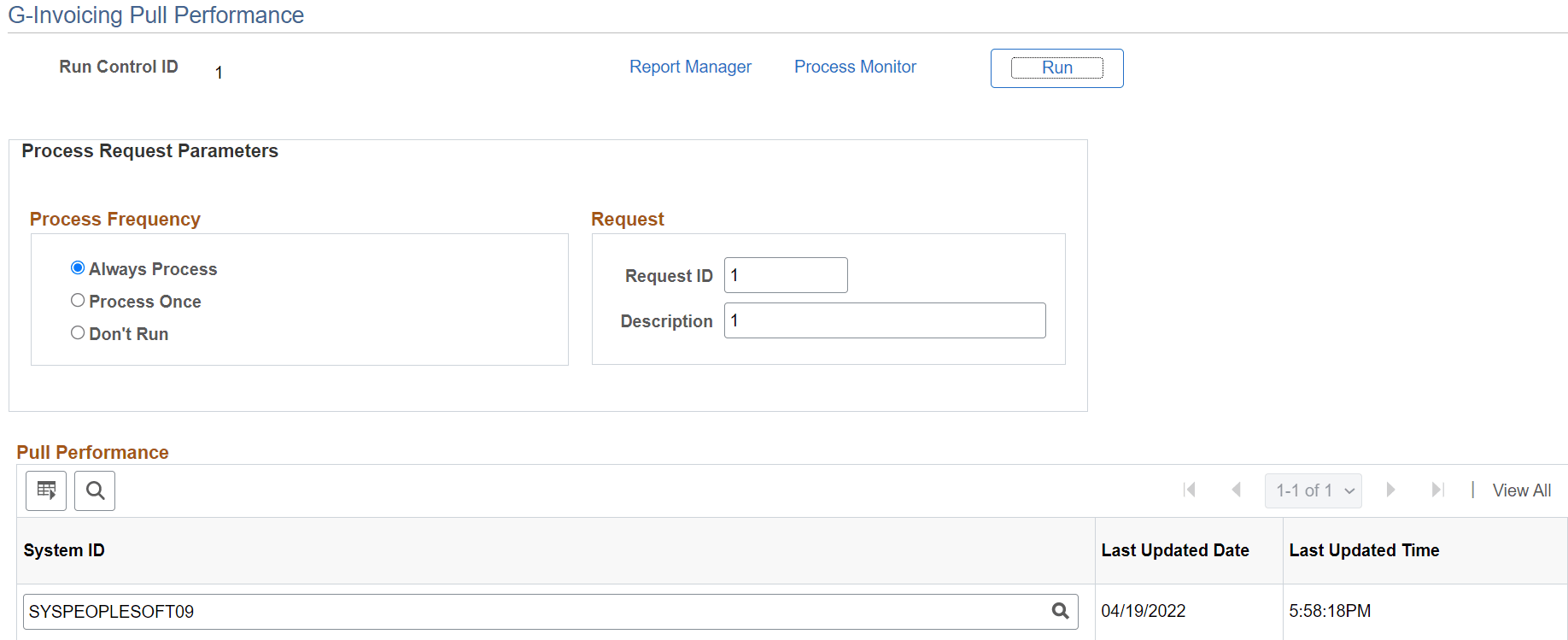

G-Invoicing Pull Performance Page
PO_GINV_PFM_PROC
To run the Pull Performance transactions which populates the View Performance grid.

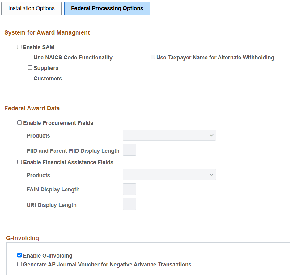

Federal Processing Options Page
Use the Federal Processing Options page (INSTALLATION_FD) to enable PeopleSoft G-Invoicing to run the APIs and view the G-Invoicing specific fields on the purchase order and receipt.
Navigation:
Setup Financials/Supply Chain , and then Install, and then Installation Options, and then Federal Processing
This example illustrates the fields and controls on the Federal Processing Options page. You can find definitions for the fields and controls later on this page.
Field or Control Description
Enable G-Invoicing
Select to enable G-Invoicing fields and functionality.
Generate AP Journal Voucher for Negative Advance Transactions
Select to automatically create Journal Vouchers for negative advance adjustment performance transactions received from G-Invoicing. This field is visible only when Enable G-Invoicing is selected.

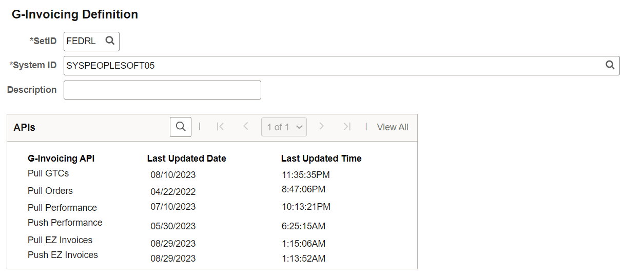

G-Invoicing Definition Page
The G-Invoicing Definition page (PO_GINV_DEFN) captures fields required by G-Invoicing for messaging. Additionally, this page stores the last date and time that each API ran for the selected G-Invoicing System ID. All G-Invoicing System IDs must be defined on this page. System IDs are used for security in G-Invoicing.
Navigation:
Purchasing, and then G-Invoicing , and then G-Invoicing Definition
This example illustrates the fields and controls on the G-Invoicing Definition page. You can find definitions for the fields and controls later on this page.
SetID
Enter the Set ID associated with the System ID definition.
System ID
Enter the G-Invoicing System ID.
Description
Enter a description of the entry.
G-Invoicing API
Displays the available APIs.
Last Updated Date (read only)
Displays the date FROM which transactions are selected by the pull APIs.
Last Updated Time (read only)
Displays the time FROM which transactions are selected by the pull APIs.

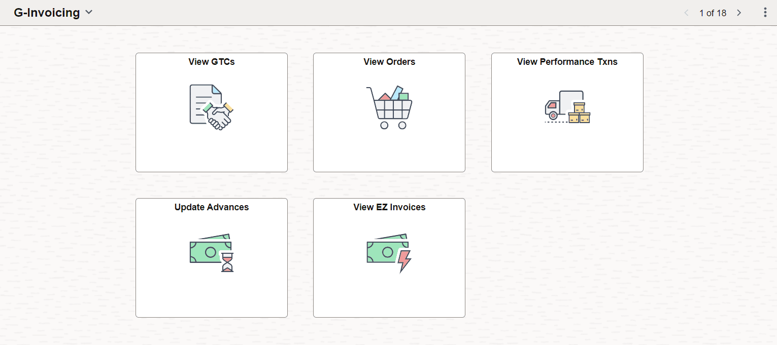

G-Invoicing navigation collection page is used to group the G-Invoicing inquiry pages together allowing a user to easily navigate from one component to another.
This example illustrates the fields and controls on the G-Invoicing page.
G-Invoicing

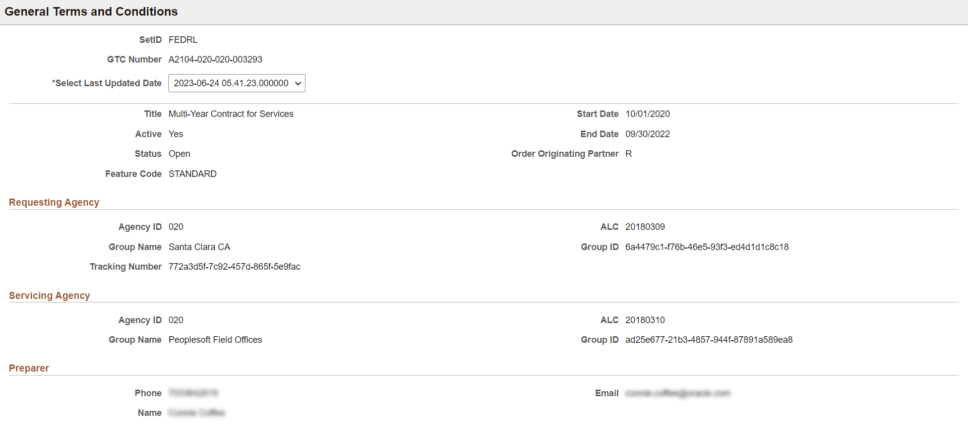

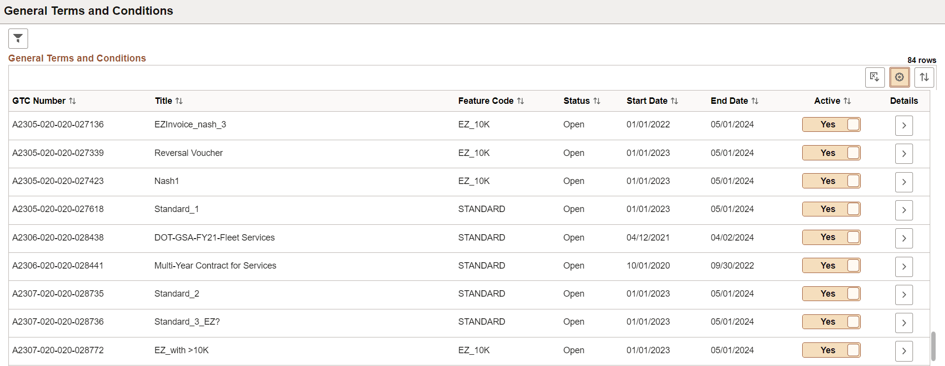

General Terms and Conditions Page
Use the GTCs (General Terms and Conditions) page (PO_GNV_GTC_FL) to view G-Invoicing General Terms and Conditions that have been pulled using the Pull GTCs API.
Navigation:
G-Invoicing, and then View GTCs
This example illustrates the fields and controls on the General Terms and Conditions page. You can find definitions for the fields and controls later on this page.
SetID
Displays the derived set ID associated with the G-Invoicing System ID on the G-Invoicing Definition page.
GTC Number
Displays the GT&C number assigned in G-Invoicing.
Title
Displays the GT&C Title entered in G-Invoicing.
Feature Code
Displays the G-Invoicing type:
  • Standard
  • EZ_10K: For 7600EZ G-Invoicing
Status
Displays the GT&C Status received from G-Invoicing.
Start Date
Displays the GT&C Start Date entered in G-Invoicing.
End Date
Displays the GT&C End Date entered in G-Invoicing.
Active
Indicates whether the GT&C is available for selection on Purchase Orders.
GTC Details icon
Click to view the GT&C Detail page. Click the Select Last Updated Date drop down to see the GT&C changes that have occurred in G-Invoicing for a specific date/time.
This example illustrates the fields and controls on the GT&C Detail page.
General Terms and Conditions Details

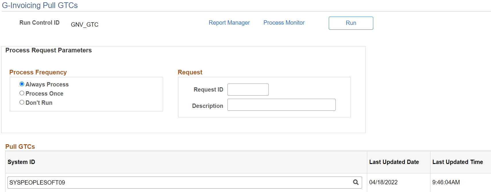

G-Invoicing Pull GTCs Page
Use the G-Invoicing Pull GTCs page (PO_RUN_GINV_PROC) to run the Pull GT&Cs API which populates the View General Terms and Conditions grid. Only G-Invoice GTCs with a status of Open (REC) or Closed (CLZ) are pulled.
Navigation:
Purchasing, and then G-Invoicing, and then G-Invoicing Pull GTCs
GT&Cs are entered directly into G-Invoicing and a subset of fields is pulled into PeopleSoft using this API. The GT&C Number is used for reference on purchase orders.
This example illustrates the fields and controls on the G-Invoicing Pull GTCs page. You can find definitions for the fields and controls later on this page.
Run Control ID
Enter a run control ID.
Process Frequency
Select how often the process should run. The available options are:
  • Always Process.
  • Process Once.
  • Don’t Run.
System ID
Enter the System ID to use when pulling transactions from G-Invoicing.
Last Updated Date and Last Updated Time
Displays the last run date and time for the API.

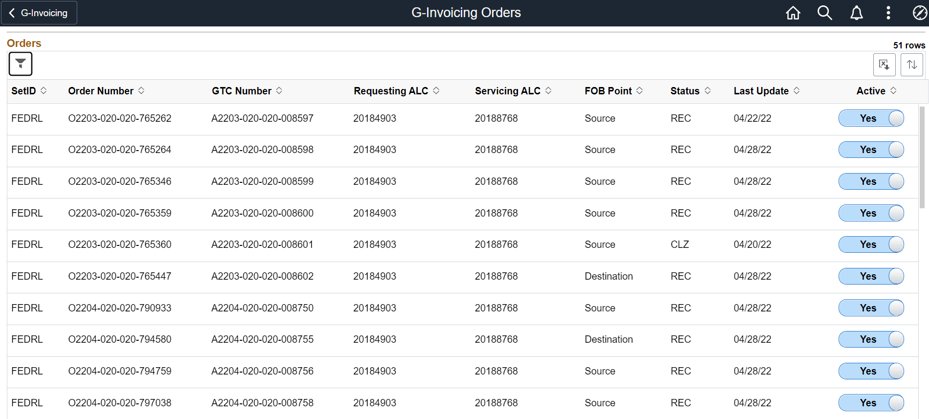

Orders Page
Use the Orders page (PO_GNV_ORD_FL) to view a list of G-Invoicing orders that have been pulled using the Pull Orders API.
Navigation:
G-Invoicing, and then View Orders
This example illustrates the fields and controls on the Orders page. You can find definitions for the fields and controls later on this page.
Orders Page
SetID
Order Number
Displays the Order Number assigned in G-Invoicing.
GTC Number
Displays the associated GT&C in G-Invoicing.
Requesting ALC
Displays the Requester’s Agency Location Code (ALC) from G-Invoicing.
Servicing ALC
Displays the Seller’s Agency Location Code from G-Invoicing.
FOB Point
Indicates whether the Order originated from the Requestor or Seller in G-Invoicing.
Status
Displays the Order Status in G-Invoicing.
Last Update
Displays the last date that the Order was updated by the API.
Active
Indicates whether the Order is available for selection on Purchase Orders.

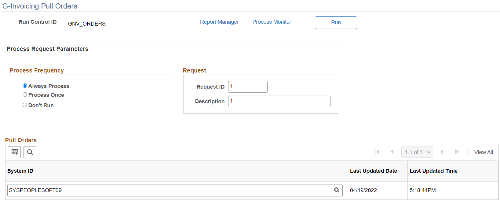

G-Invoicing Pull Orders Page
Use the G-Invoicing Pull Orders page (PO_GINV_ORD_PROC) to run the Pull Orders API which populates the View Orders grid. Only G-Invoice Orders with a status of Open (REC) or Closed (CLZ) are pulled.
Navigation:
Purchasing, and then G-Invoicing, and then G-Invoicing Pull Orders
This example illustrates the fields and controls on the G-Invoicing Pull Orders page. You can find definitions for the fields and controls later on this page.
Orders are entered directly into G-Invoicing and a list of orders is pulled into PeopleSoft using this API. The Order Number is used for reference on Purchase Orders.
Run Control ID
Process Frequency
  • Always Process.
  • Process Once.
  • Don’t Run.
System ID

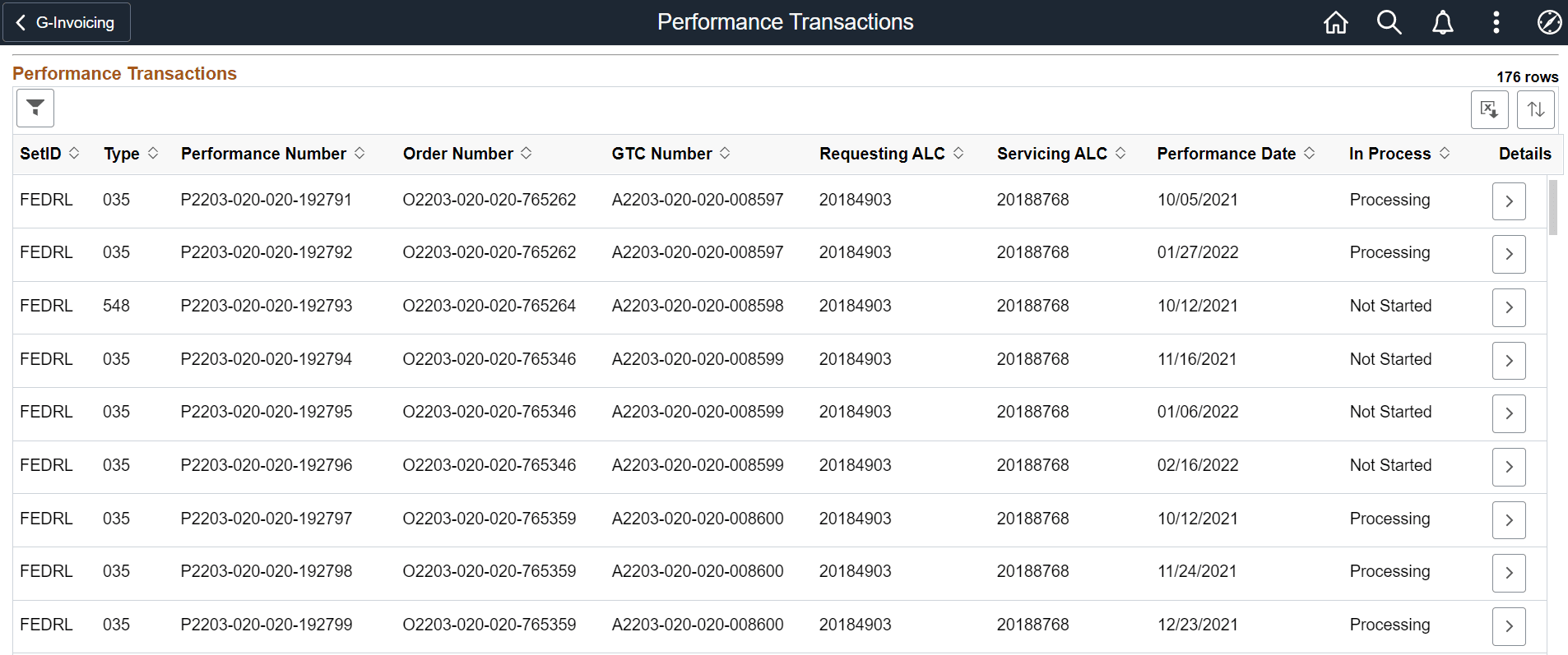

Performance Transactions Page
Use the Performance Transactions page (PO_GNV_PER_HDR_FL) to view G-Invoicing Performance Transactions that have been pulled using the Pull Performance API.
Navigation:
G-Invoicing, and then View Performance Transactions
This example illustrates the fields and controls on the Performance Transactions page. You can find definitions for the fields and controls later on this page.
SetID
Type
Identifies the nature of the performance in the reported transaction:
  • ‘035’ Delivered/Performed
  • ‘050’ Received/Accepted
  • ‘548’ Advance
  • '014’ Deferred Payment (for informational purposes only)
Performance Number
Displays the Performance Number assigned to the transaction in G-Invoicing.
Order Number
Displays the associated Order Number in G-Invoicing.
GTC Number
Requesting ALC
Displays the Requester’s ALC from G-Invoicing.
Servicing ALC
Displays the Seller’s ALC from G-Invoicing.
Performance Date
Displays the date of the performance transaction in G-Invoicing.
In Process
Identifies whether the transaction has one or more receipts created:
  • N (Not Started): no receipts created against this transaction.
  • P (Processing): at least one receipt is created against this transaction but there is still an outstanding balance.
  • C (Complete): receipts have been created against this transaction and it is fully received.

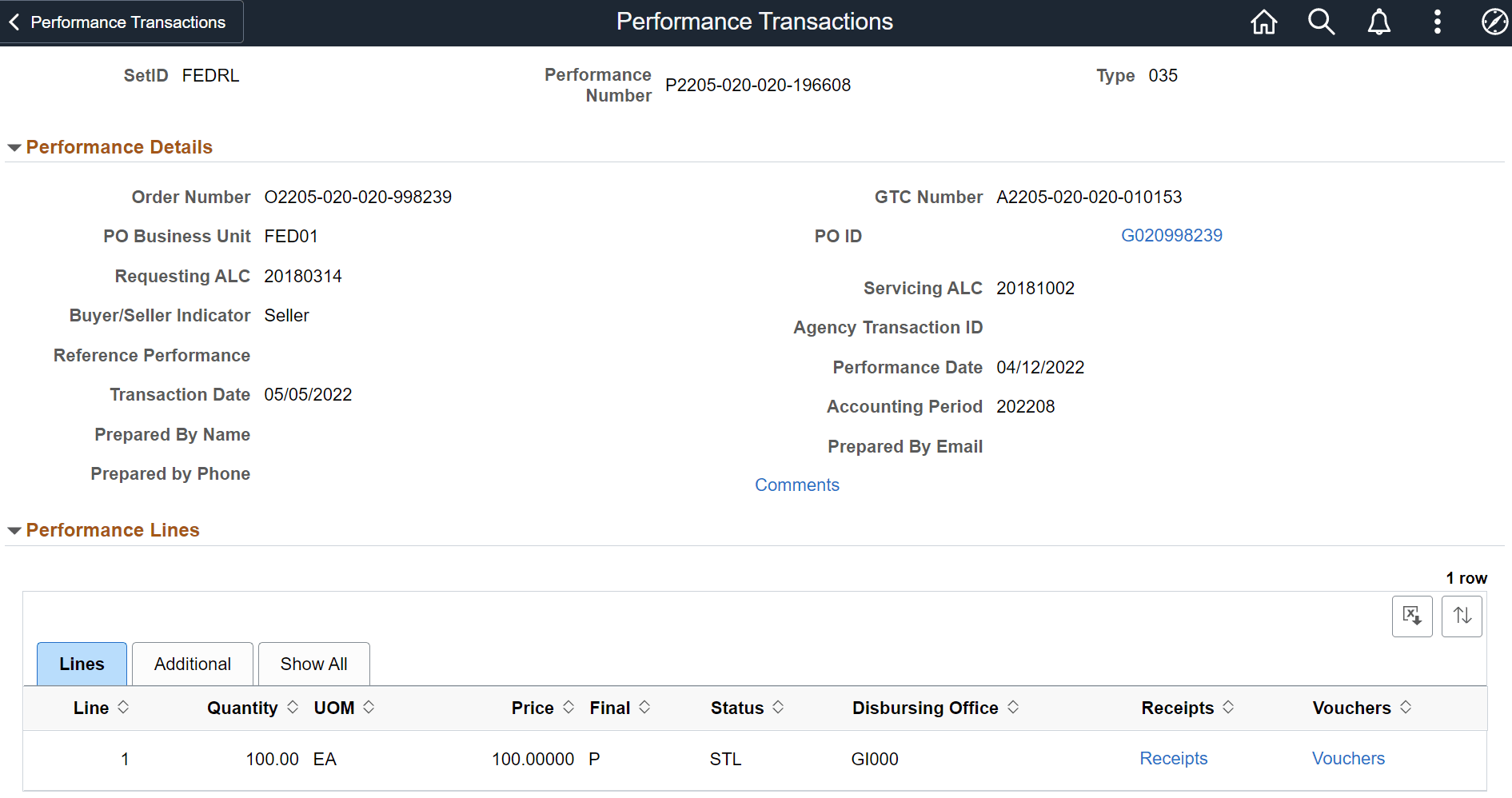

Performance Details icon
Click to view the Performance Detail page. This page contains header and line data associated with the performance transaction.
This example illustrates the fields and controls on the Performance Details page. You can find definitions for the fields and controls later on this page.
Performance Details Page
SetID
Type
  • ‘548’ Advance
Performance Number
Order Number
GTC Number
PO Business Unit
Displays the PO Business Unit from the set ID associated with the G-Invoicing System ID on the G-Invoicing Definition page.
PO ID
Click to view the Purchase Order in the PO Inquiry page.
Buyer/Seller Indicator
Indicates whether the performance transaction originated from the Requestor or Seller in G-Invoicing.
Agency Transaction ID
Displays the Agency Transaction ID from G-Invoicing.
Reference Performance
Links a new Performance Transaction to an existing one.
Transaction Date
Displays the date and time the performance transaction was enterred into G-Invoicing.
Performance Date
Displays the date and time of the performance transaction in G-Invoicing.
Prepared By Name/Email/ Phone
Displays the name, email address, and phone number for the preparer in G-Invoicing.
Comments
Click the Comments link to view Comments associated with the transaction.

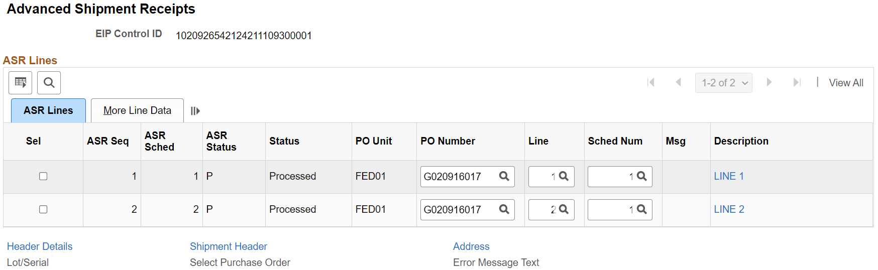

Line
Displays the G-Invoicing performance line number.
Quantity
Displays the number of units pertaining to the type of performance being reported.
UOM
Displays the units in which a quantity is being expressed.
Price
Displays the price of the G-Invoicing line.
Final
Specifies from one partner to another that no more performance (of this type) is expected against the Order Schedule.
This is a G-Invoicing field, not to be confused with the PeopleSoft partial/final flag.
Status
Displays the G-Invoicing status of the payment with IPAC.
Disbursing Office
Identifier assigned to the agency which is disbursing funds.
Receipts
Click to view Receipts created for this performance transaction.
Vouchers
Click to view Vouchers created for this performance transaction.
Reference Line
G-Invoicing reference line number that links a new Performance Detail to an existing one.
Order Line
G-Invoicing identifier of a specific line item within the order.
Schedule Number
G-Invoicing identifier of a specific schedule within the line item, containing the detailed financial and shipping information.
Payment Transfer Date
G-Invoicing date when the funds settled in IPAC.
It is possible that GT&C number could be blank on the Performance Inquiry table, if Pull Performance runs before Pull Orders. The GT&C Number is derived from the Orders data. To correct this issue, run Pull Orders and then Pull Performance again to populate GT&C Number.
Use the G-Invoicing Pull Performance page (PO_GINV_PFM_PROC) to run the Pull Performance transactions which populates the View Performance grid.
Navigation:
Purchasing, and then G-Invoicing, and then G-Invoicing Pull Performance
This example illustrates the fields and controls on the G-Invoicing Pull Performance page. You can find definitions for the fields and controls later on this page.
Performance transactions include:
  • Advance payments ('548’)
  • Adjustments to advances (negative ‘548’)
  • Delivered/performed transactions (‘035’)
  • Adjustments to delivered/performed transactions (negative ‘035’). These transactions are for informational purposes only and no transactions are automatically created. Since the specific reason for the adjustment is unknown, these transactions need to be reviewed and determine manual correction in Purchasing as necessary.
  • Received/accepted transactions (‘050’)
  • Adjustments to received/accepted transactions (negative ‘050’)
  • Deferred payment transactions (‘014’). For informational purposes.
Run Control ID
Process Frequency
  • Always Process.
  • Process Once.
  • Don’t Run.
System ID

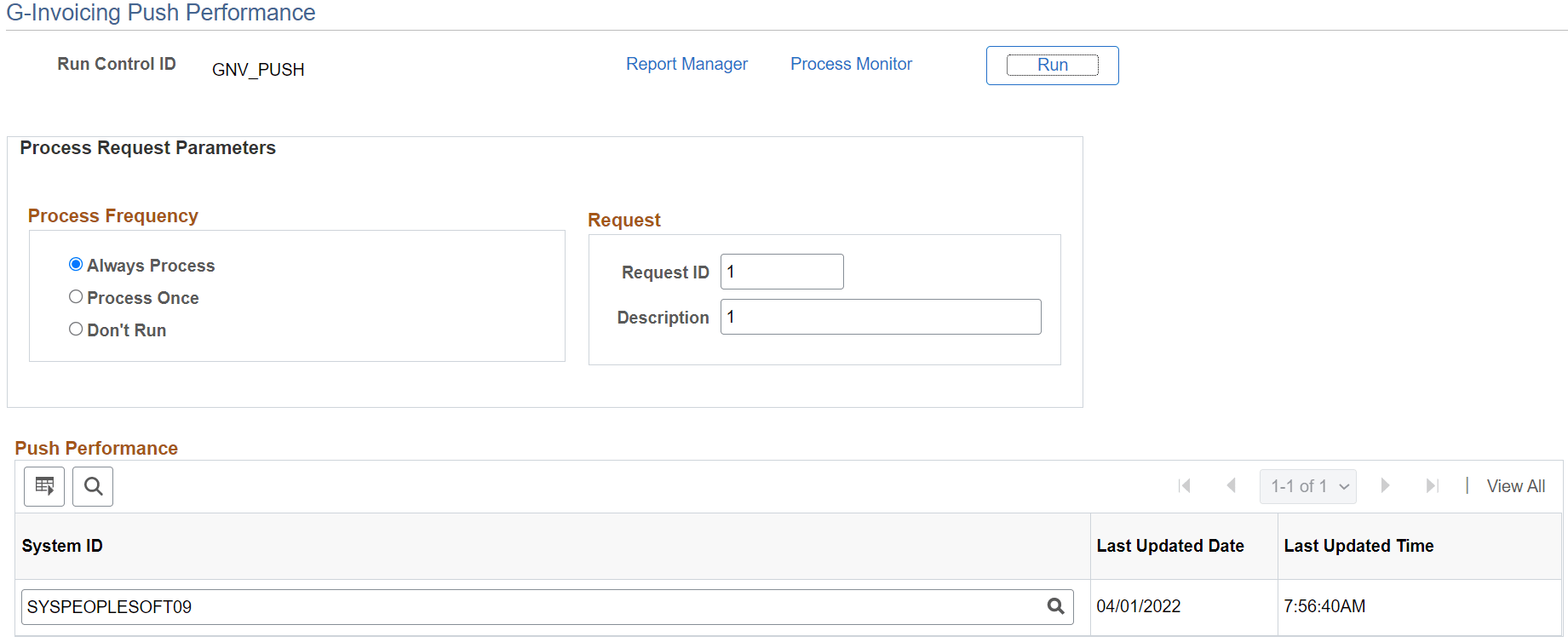

G-Invoicing Push Performance Page
Use the G-Invoicing Push Performance page (PO_GINV_PFM_PUSH) to run the Push Performance transactions API which sends Received/Accepted transactions and adjustments to G-Invoicing.
Navigation:
Purchasing, and then G-Invoicing, and then G-Invoicing Push Performance
This example illustrates the fields and controls on the G-Invoicing Push Performance page. You can find definitions for the fields and controls later on this page.
The following transactions are pushed back to G-Invoicing:
  • Received/accepted transactions (‘050’). These transactions originate from Receipts.
  • Adjustments to received/accepted transactions (negative ‘050’). These transactions originate from adjustments to Receipts and Return to Vendor transactions.
Run Control ID
Process Frequency
  • Always Process.
  • Process Once.
  • Don’t Run.
System ID
Pull Performance must be run prior to pushing RTV and receipt adjustment transactions so that the Reference Performance Number can be populated on the ‘050’ adjustment transaction. All ‘050’ adjustments must reference the Received/Accepted transaction (‘050’) they are adjusting. G-Invoicing assigns a performance number to a ‘050’ transaction after it is pushed using the API. This performance number becomes the reference performance number for the ‘050’ adjustment.

Use Advanced Shipment Receipts page (Purchasing> Receipts> Review Receipt Information> Advanced Shipment Receipts) to view the staged shipments. Use Load Purchase Order Receipts page (Purchasing> Receipts> Load Receipts) to create Receipts from the staged ASR transactions.
For additional information, see Loading Receipts Received Using EIPs and EDC
Creating G-Invoicing Receipts Manually
It is possible to bypass the ASN/ASR process and create G-Invoicing receipts manually.
Pull Performance will create ASNs for all eligible ‘035’ transactions. These transactions can either be ignored or canceled. Processing them in addition to creating a receipt manually will cause duplicate entries.
This example illustrates the fields and controls on the Advanced Shipment Receipts page
Advanced Shipment Receipts Page
To designate the receipt as G-Invoicing so that the Push Performance API generates a ‘050’ transaction, the following fields are required to be entered:
  • Referenced PO ID is required and the selected PO must be designated as G-Invoicing.
  • Shipment Number must be entered with the exact G-Invoicing Performance Number from the Seller agency.
  • Invoice Number must be entered.
  • Ship and Receipt Date must be entered as the G-Invoicing Performance Date.
