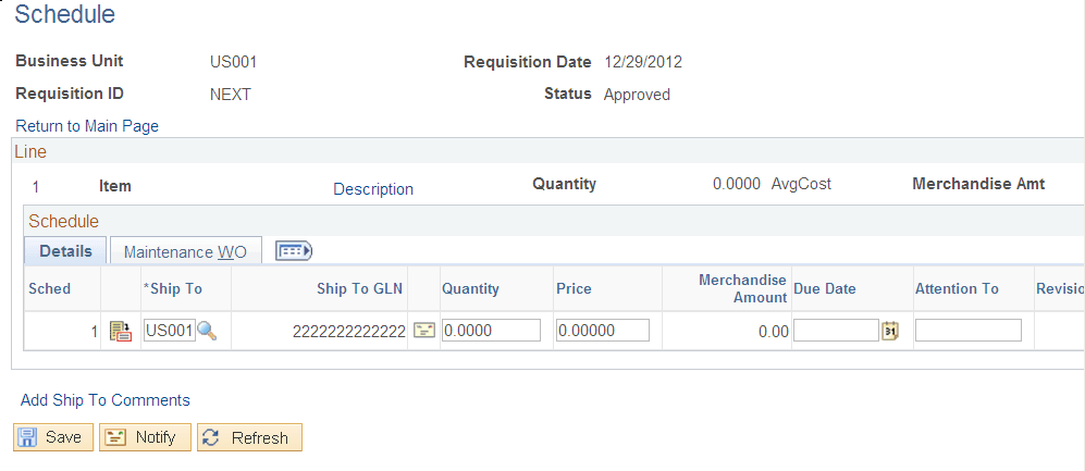

Maintain Requisitions - Schedule Page
Use the Maintain Requisitions - Schedule page (REQ_SCHEDULE) to specify multiple shipping schedules for each line and define multiple distributions for each schedule.
Navigation:
Purchasing, and then Requisitions, and then Add/Update Requisitions, and then Maintain Requisitions - Requisition
Click the Schedule button on the Maintain Requisitions - Requisition page.
This example illustrates the fields and controls on the Maintain Requisitions - Schedule page. You can find definitions for the fields and controls later on this page.
Maintain Requisition - Schedule Page
Details
Use the Details tab to define schedule information. You can specify multiple shipping schedules for each line and multiple distributions for each schedule.
Field or Control Description
Ship To
Select the location to which the supplier will ship the order. You can update this value for each schedule that you define.
Note: If you change the ship to location to a PeopleSoft Inventory business unit that requires closure calendar validation and processing for receiving activities as defined on the Closure Calendar page, the system validates the due date as a valid date for receiving. If it encounters an exception date, it uses the next valid future date as the due date.
Ship to Address
Click the Ship To Address button to access the Requisition Ship To Address page. Use this page to view the ship to address or to define a one-time address for the requisition.
Note: This button is unavailable for direct shipment requisitions created from sales orders in PeopleSoft Order Management.
Ship to GLN
Displays the GLN values on the Schedule Page
Note: The ShipTo GLN value be displayed based on the Location defined in the setup.
Quantity
Supplied from the requisition line. If you update this quantity on either the line or schedule, the other quantity is also updated. The sum of the active schedules for a line must equal the line quantity. This linkage prevents you from scheduling a different quantity than you have requisitioned.
Price
Enter the unit price of the item.
If you are using commitment control, the price field is unavailable for modification when a requisition schedule that is distributed by quantity has been partially or fully sourced to a purchase order. This field is also unavailable for modification when you create a change order for a requisition (that is distributed by quantity) that has been partially or fully sourced to a purchase order.
Amount
Displays the total price of the items on the requisition schedule. This is the unit price multiplied by the schedule quantity.
Due Date
(Optional) Select the requisition schedule due date. The date that you enter becomes the default purchase order due date. If you don't specify a due date here, when you source the requisition to a purchase order, the system derives the due date by incrementing the purchase order date by the number of lead-time days defined for the item. If the item is not defined in the system, or if you are ordering by description-only, the due date becomes the purchase order due date by default.
Note: If the PeopleSoft Inventory business unit associated with the ship to location requires closure calendar validation and processing for receiving activities as defined on the Closure Calendar page, and the due date that you enter falls on a defined closure date, the system issues a warning. You can choose to keep the invalid date, or use the next valid date on the calendar.
Attention To
Enter the person to whom or place where the services or goods are to be delivered. The system uses values for this field from PeopleSoft eProcurement requisitions. You can override the value or enter a value.
Revision
Enter the manufacturer's product revision number of the item ordered. If the ship to is a PeopleSoft Inventory business unit and the item is under revision control in that business unit, the revision number by default becomes the one that is effective on the due date.
Schedule Direct shipment
Click the Schedule Direct Shipment button to access the Maintain Requisitions - Direct Ship page. Use this page to view the sales order information for the direct shipment requisition.
Pegging Workbench
Click the Pegging Workbench button to access the Pegging Workbench page. Use this page to view and maintain the pegging information associated with this requisition.
See Using Pegging with Requisitions in PeopleSoft Purchasing.
Pegging Inquiry
Click the Pegging Inquiry button to access the Pegging Inquiry page. Use this page to view the demand for this requisition.
Status
Displays the status of the schedule.
change order
Click to create a change request or change order for the requisition. When a requisition is eligible for change order tracking, the system makes the Create Schedule Change button available for use. All eligible change request and change order fields are disabled prior to selecting this button. The Cancel buttons are also enabled. Inserting a new line or schedule or canceling an existing line or schedule creates a change order. You can't delete a line or schedule if it is eligible for change order processing.
When you click the button, the system checks whether this is the first change for this requisition. If so, the system inserts change order fields with the batch number and sequence number of 0. This stores the original values of the schedule.
Changing the quantity field on the schedule level causes both line and schedule quantity fields to be tracked if they are define as change request or change order fields.

Additional Details Page
Use the Additional Details page (REQ_SCHED_DTL2) to enter time due, ultimate use, and sales and use tax destination information.
Navigation:
Click the Additional Detail icon on the Maintain Requisitions - Schedule page.
Details
Tax Destination
Displays the location code on which the sales and use tax calculation for the schedule should be based. This is also known as the tax basis.
Ultimate Use Code
Displays the ultimate use code for the item. The ultimate use of an item can alter the SUT amount that a business unit pays. The SUT amount can be calculated based on the SUT authority and the ultimate use code established on the Ultimate Use Code page.
Ship Via
Select the Ship Via Code.
Freight Terms
Select the Freight Terms Code.
Note: The Ship Via and Freight Terms values are copied directly from the requisition if the Override Suggested Supplier check box is not selected on the Requisition page.
Requisition Ship To Address Page
Use the Requisition ShipTo Address page (REQ_ONETIME_ADDR) to view address details for the location relevant to the page from which this page is accessed.
You can also set up a one-time ship to address for the selected requisition.
Navigation:
Click the Ship To Address button on the Maintain Requisitions - Schedule page.
The fields on this page are identical to those on the Supplier Information - Address page. However, no effective date or status fields are on this page because the address information on this page is used only for a one-time shipping address and is not retained by the system.
This page is unavailable for direct shipment requisitions that originated from PeopleSoft Order Management. To change the address on a direct ship requisition, you must change the address associated with the sales order in PeopleSoft Order Management.
