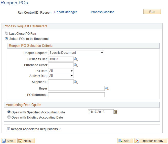

Reopen POs Page
Use the Reopen POs page (RUN_PO_REOPEN) to initiate the Purchase Order Reopen process.
Navigation:
Purchasing, and then Purchase Orders, and then Reconcile POs, and then Reopen POs
This example illustrates the fields and controls on the Reopen POs page. You can find definitions for the fields and controls later on this page.
Reopen POs page
When a purchase order has an authored contract document associated to it, certain changes that occur when reopening the purchase order could affect the authored document. You should contact the contract specialist or the buyer in case they need to update the authored document.
Field or Control Description
Last Close PO Run
Select this option if you want to reopen the purchase orders that were closed during the last run of the Close Purchase Orders process. When you select this option, the Reopen PO Selection Criteria group box is not available.
Select POs to be Reopened (select purchase orders to be reopened)
Select this option if you want to reopen any purchase order that has already been closed. After you select this option, enter the purchase order or purchase orders you would like to reopen in the Reopen PO Selection Criteria group box.
Reopen Request
Select the reopen request option. Values are:
  • Range of Documents: Select if you want to reopen a range of purchase orders. After you select this option, select the purchase order range using the Purchase Order and To fields.
  • Specific Business Unit: Select if you want to reopen the purchase orders associated with a specific business unit. After you select this option, select the business unit using the Business Unit field.
  • Specific Document: Select if you want to reopen a specific purchase order. After you select this option, select the purchase order using the Purchase Order field.
PO Date
Select a purchase order date option. Values are:
  • All: Select if you want to reopen purchase orders for all purchase order dates.
  • Range: Select if you want to reopen purchase order for a certain date range. After you select this option, select the date range using the From and To date fields next to this field.
  • Value: Select if you want to reopen purchase orders for a specific date. After you select this option, select the date using the date field next to this field.
Activity Date
Select an activity date option. Values are:
  • All: Select if you want to reopen purchase orders for all activity dates.
Supplier ID
Select the supplier ID. Purchase orders associated with that supplier will be reopened.
Buyer
Select the buyer. Purchase orders associated with that buyer will be reopened.
PO Reference
Enter the purchase order reference. Purchase orders associated with that purchase order reference will be reopened.
Accounting Date Options
Open with Specified Accounting Date
Select this option if you want to reopen the purchase orders using the accounting date you specify. The current date appears by default in the date field but you can override it if you choose. This field only appears if you are using commitment control.
Open with Existing Accounting Date
Select this option if you want to reopen the purchase orders using the existing accounting date on the purchase orders. This field only appears if you are using commitment control.
Additional Criteria
Reopen Associated Requisitions ?
Select this check box if you want the Purchase Order Reopen process to reopen the requisition lines that are associated with purchase orders you are requesting to be reopened.
For example, lets say you have a requisition that has five lines. You then create a purchase order associated to just one of the requisition lines. Then you close the purchase order. When you reopen the purchase order and if this check box is selected, the system will reopen just the one requisition line associated with the purchase order not the other requisition lines.
If you are using commitment control, this check box must be selected.
