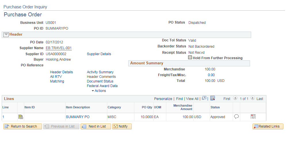

Purchase Order Inquiry Page
Use the Purchase Order Inquiry page (PO_LINE_INQ) to view purchase order information.
This is an inquiry version of the Maintain Purchase Order - Purchase Order page. The page displays purchase order header and line information and whether an authored document exists for the purchase order.
Navigation:
Purchasing, and then Purchase Orders, and then Review PO Information , and then Purchase Orders , and then Purchase Order Inquiry
This example illustrates the fields and controls on the Purchase Order Inquiry page. You can find definitions for the fields and controls later on this page.
PO Inquiry page
Refer to Federal Award Data page for descriptions on the Federal Award Data page.
Use Header, Line, and Ship to comment to view or add respective comments and upload one or more supporting documents. The system displays an error message if you try to load more than the number of attachments specified on the Application Fundamentals: Installation Options - Multiple Attachments Page for Purchasing product.

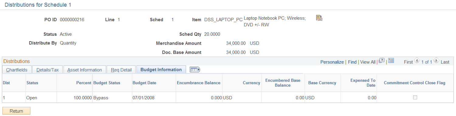

Purchase Order Inquiry - Distributions for Schedule Page
Use the Purchase Order Inquiry - Distributions for Schedule page (PO_SCHED_DIST_INQ) to view purchase order distribution information.
Navigation:
Click the Distributions/ChartFields button on the Purchase Order Inquiry - Schedules page.
This example illustrates the fields and controls on the Purchase Order Inquiry - Distributions for Schedule page: Budget Information tab. You can find definitions for the fields and controls later on this page.
This page displays distribution information for a purchase order line, schedule, and item.
Field or Control Description
Line Detail
Click the Item Description button to view complete descriptions for items when descriptions have been added.
Sched Qty (schedule quantity)
Displays the quantity of items on this schedule.
Distribute By
Displays the method used to allocate or charge the expense account distribution. Values are:
Amount: Used when the sum of all distribution amounts must equal the schedule amount (merchandise amount). Inventory items cannot be distributed by amount.
Quantity: Used when the sum of all distribution quantities must equal the schedule quantity.
Merchandise Amount
Displays the merchandise amount according to the quantities and prices of the items on the purchase order.
Doc. Base Amount (document base amount)
Displays the document base amount. This is the Amount value converted to the base currency of the purchase order. The base currency is the currency of the PeopleSoft General Ledger business unit for this PeopleSoft Purchasing business unit.
Select a tab to view additional information about a schedule's distribution.
See Maintain Purchase Order - Distributions for Schedule Page.
Budget Information
Select the Budget Information tab.
Dist (distribution line number)
Displays the distribution line number.
Status
Distribution line status. Values are:
Complete: The distribution line is closed.
Open: The distribution line is open.
Processed: The distribution line has been processed and is unavailable for sourcing.
Canceled: The distribution line has been canceled.
Percent
Displays the percentage of either the quantity or the amount that is to be distributed on this distribution line. The system calculates other distribution values based on the percentage value.
Budget Status
When commitment control is on, the system displays whether this distribution has been budget checked. Values for the field include Not Chekd and Valid.
Budget Date
Displays the date used by commitment control to determine the budget period to which this item cost belongs.
Encumbrance Balance
Displays the encumbrance balance when commitment control is installed. When you create a purchase order, commitment control liquidates the pre-encumbrance balance from the requisition and establishes an encumbrance for the purchase order.
You can view budget details for the purchase order. Click the Encumbrance Balance link to access the PO Accounting Entries Inquiry where you can select a General Ledger business unit and commitment control ledger group to use as a budget inquiry.
See PeopleSoft Commitment Control: Viewing Budget Details and Transaction Activity.
Currency
Displays the currency code for the encumbrance amount at the distribution level of the purchase order. The code is in the currency of the default commitment control ledger group for the distribution level General Ledger business unit.
Encumbered Base Balance
Displays the initial value of the encumbered balance.
Base Currency
Expensed To Date
Displays the amount reflects the total expensed to date, not the remaining expense balance. This creates a relationship to the encumbrance balance.
Commitment Control Close Flag
Displays as selected when the purchase order associated with the requisition has been fully liquidated, thus indicating that the outstanding pre-encumbrance has also been fully liquidated. This option can also display as selected when the distribution has been canceled.
