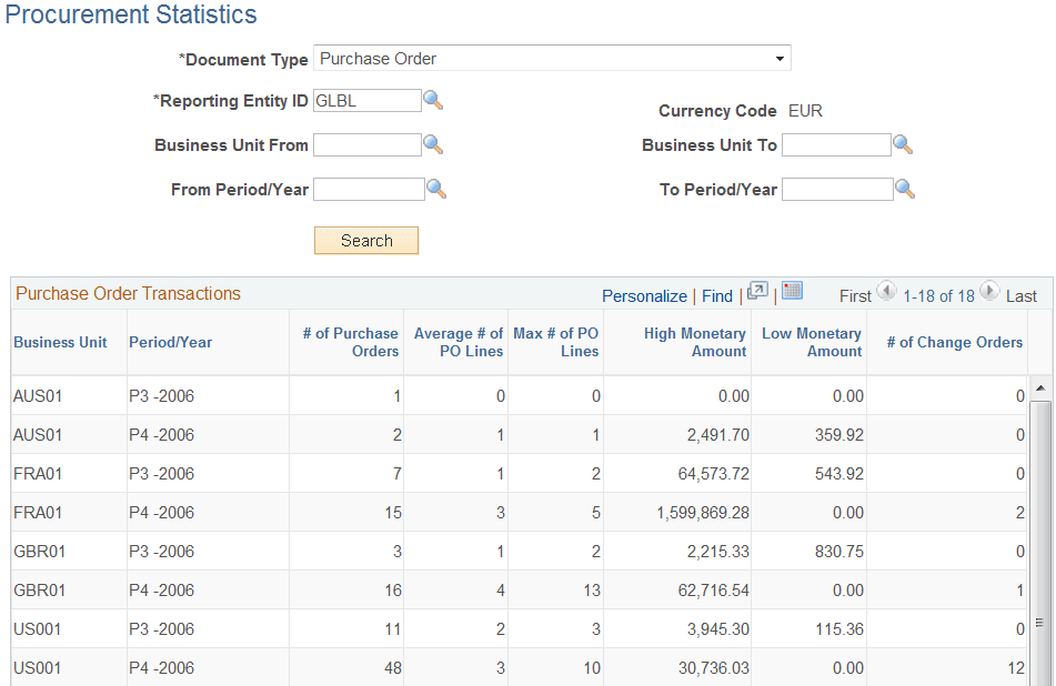

Use the Procurement Statistics inquiry page (PRCR_TXN_HISTORY) to view requisition, purchase order, and receipt statistical information.
Navigation:
Purchasing, Analyze Procurement, Review Procurement Information, Procurement Statistics
This example illustrates the fields and controls on the Procurement Statistics inquiry page. You can find definitions for the fields and controls later on this page.
You must run the Procurement Statistics process (PRCR_TXN_HIST) before data will appear on this inquiry page.

Purchase Order Transactions
| Field or Control | Description |
Average # of PO Lines (average number of purchase order lines) |
Displays the average number of purchase order lines for the period. For each business unit, all the purchase order lines associated with the purchase orders in the period are counted. That number is then divided by the total number of purchase orders in the period to give you the average number of purchase order lines. |
Max # of PO Lines (maximum number of purchase order lines) |
Displays the maximum number of purchase order lines for the period. For the time period, this is the most number of purchase order lines contained on one purchase order. |
High Monetary Amount |
Displays the highest monetary amount of one purchase order for the period. Each purchase order is converted into the currency specified on the reporting entity ID, using the rate indicated. The highest amount associated with one purchase order displays. |
Low Monetary Amount |
Displays the lowest monetary amount of one purchase order for the period. Each purchase order is converted into the currency specified on the reporting entity ID, using the rate indicated. The lowest amount associated with one purchase order displays. |
