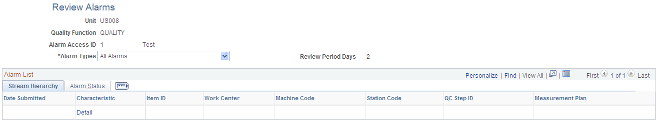

Review Alarms Page
Use the Review Alarms page (QS_ALM_RVW_INQ) to view alarms that match the selection criteria that you specified on the alarm access profile.
Navigation:
Quality, and then Analyze Quality Results, and then Review Alarm Conditions, and then Review Alarms, and then Review Alarms
This example illustrates the fields and controls on the Review Alarms page: Stream Hierarchy tab. You can find definitions for the fields and controls later on this page.
Make sure that an alarm access profile has been defined and alarms have been generated against control plans to populate the page.
To enhance security, the Alarm Access ID field does not provide a prompt list.
The first columns to appear depend on the quality function that you select. The columns are the hierarchy fields associated with the quality function.
Field or Control Description
Date Submitted
Displays the date and time that the alarm occurred.
Characteristic
Displays the characteristic where the alarm was generated. Click the Characteristic (Display Detail) link to access the Alarm Detail page.
Summary Analysis
Click this link to view a Pareto chart of various alarm-related attributes.

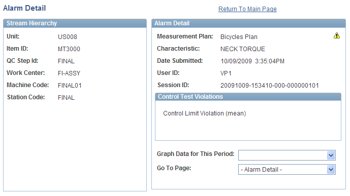

Alarm Detail Page
Use the Alarm Detail page (QS_ALM_RVW_DET) to view the detailed information associated with the alarm.
From this page you can access other pages, where you can review a chart, enter probable causes for the alarms, or log corrective actions.
Navigation:
Click a Characteristic (Display Detail) link on the Review Alarms page.
This example illustrates the fields and controls on the Alarm Detail page. You can find definitions for the fields and controls later on this page.
Alarm Detail page
This page displays all the relevant subgroup information associated with a specific alarm.
Stream Hierarchy
The system displays the hierarchy fields associated with the quality function.
Alarm Detail
The system displays the basic information about the alarm, including the session ID associated with the alarm.
Graph Data for This Period
Select the type of graph that you want. Values are Control Chart, Histogram, Pareto of Alarms, Pareto of Comments, Pareto of Corrective Actions, Pareto of Defects, and Pareto of Probable Causes.
Control Test Violations
Displays the control-test violations associated with the alarm. There can be up to three test violations per alarm.
Additional Links
You can link to other pages using the Go To Page field to enter corrective and probable cause actions and sample details.

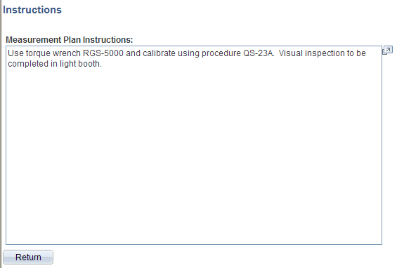

Instructions Page
Use the Instructions page (QS_INSTRUCT_PNL) to view the control plan instructions where an alarm occurred.
Navigation:
Select the View Instruction option for the Go To Page field on the Alarm Detail page.
This example illustrates the fields and controls on the Instructions page. You can find definitions for the fields and controls later on this page.
Instructions page
The system displays the measurement plan instructions that are associated with the control plan.

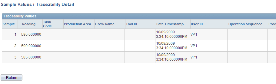

Sample Values / Traceability Detail Page
Use the Sample Values / Traceability Detail page (QS_TRCDET_PNL) to view the actual sample values for the subgroup and trace fields that were entered for the subgroup.
Navigation:
Select the Sample Detail option for the Go To Page field on the Alarm Detail page.
This example illustrates the fields and controls on the Sample Values / Traceability Detail page. You can find definitions for the fields and controls later on this page.
The page displays the sample details and trace field information associated with the subgroup when the alarm occurred.
Sample
Displays the sample number.
Reading
Displays the sample or measurement value.
User ID
Displays the user ID of the operator who performed the data collection (applies only to manual data entry).
Any/all traceable fields
Displays the trace field values that are tagged to samples for this subgroup.
