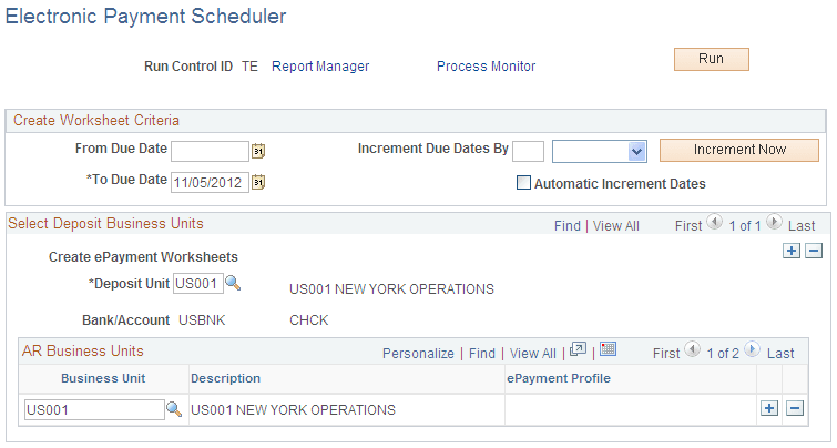

Electronic Payment Scheduler Page
Use the Electronic Payment Scheduler page (AR_EPAY_RQST) to create ePayment worksheets and automatically settle electronic check and PayPal transactions from eBill Payment.

This example illustrates the fields and controls on the Electronic Payment Scheduler page. You can find definitions for the fields and controls later on this page.
Field or Control Description
From Due Date
Specify the beginning due date to use when the ePayment processor selects items.
Increment Due Dates By
Enter the amount of time to increment the From Due Date and the To Due Date fields. Enter the numerical value and the time scale in days, weeks, or months that you want the due dates to change. These values are used when you click the Increment Now button or select the Automatic Increment Dates check box.
Increment Now
Click this button to increment the From Due Date and To Due Date based on the Increment Due Dates By fields.
To Due Date
Specify the last due date to use when the ePayment processor selects items.
Select this check box so that the From Due Date and To Due Date fields automatically increment each time you run the ePayment processor. This option enables you to reuse a run control without having to change the dates.
Deposit Unit
Enter the deposit business unit. This value controls the bank account from which the credit card payment is made. The system processes each specified deposit unit separately.
AR Business Units
Enter AR business units to enable electronic check and PayPal settlements for the specified deposit business unit. All ePayment worksheets in the defined deposit business unit that have an ePayment status of Unprocessed are selected.
