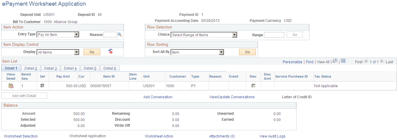

ePayment Worksheet Application Page
Use the ePayment Worksheet Application page (PAYMENT_WS_EP) to view the electronic check and PayPal payments entered by customers in eBill Payment.
These payments appear in the worksheet after you run the Electronic Payment Scheduler Application Engine process (AR_EPY_PRCS). See the Electronic Payment Scheduler Page for more information.
Navigation:
Accounts Receivable, and then Payments, and then Electronic Payments, and then Apply Electronic Payments, and then Update ePayment Worksheet, and then ePayment Worksheet Application
This example illustrates the fields and controls on the ePayment Worksheet Application page.

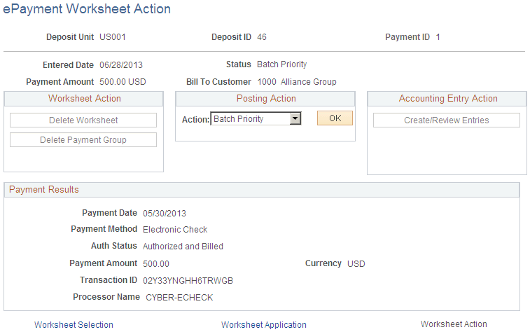

ePayment Worksheet Action Page
Use the ePayment Worksheet Action page (PAYMENT_ACTION_EP) to select the posting action for the payment applied on the ePayment Worksheet.
Navigation:
Accounts Receivable, and then Payments, and then Electronic Payments, and then Apply Electronic Payments, and then Finalize ePayment Worksheet, and then ePayment Worksheet Action
This example illustrates the fields and controls on the ePayment Worksheet Action page.
Worksheet Action and Accounting Entry Action fields cannot be edited.
Field or Control Description
Posting Action
Defaults to the Batch Priority action so that the user does not need to set the Posting Action for each payment individually. After you run ePayment processing (AR_EPAY_RQST), all electronic check and PayPal payments post the next time that Receivables Update runs.
Payment Results
Payment Date
Displays the date when the ePayment transactions were entered and paid.
Payment Method
Displays the payment method. The only possible ePayment methods in this component are Electronic Check and PayPal.
To enable the PayPal and Electronic Check payment methods, you must set up electronic payment options. See Application Fundamentals: Setting Up Electronic Payment Options for more information.
Auth Status
Displays the Authorized and Billed status for ePayments.
Payment Amount and Currency
Displays the item amount and USD currency.
Transaction ID
Displays an identification number for the transaction.
Processor Name
Displays the payment processor name as set up in the system.
See Integration Interfaces: Setting Up Credit Card Interface Elements and Application Fundamentals: Setting Up Electronic Payment Options.

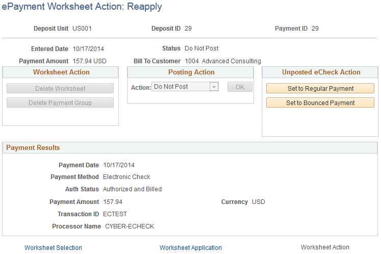

Unposting Electronic Payments
You can unpost electronic payments in case the payment was applied to the wrong item, or it was applied to an item but for some reason the funds were not deposited in the bank account. In these situations, upon selecting an unposted PayPal or Electronic Check payment in the Update ePayment Worksheet, the component offers these Accounting Entry Actions to complete accounting processing:
  • Set to Regular Payment
  • Set to Bounced Payment
This example illustrates the fields and controls on the ePayment Worksheet Action: Reapply page.
Converting an Electronic Check to a Regular Payment
If the electronic payment has been applied to the wrong item, but the funds have been deposited to the Receivables bank account, you can convert the electronic check to a regular payment. Upon clicking the Set to Regular Payment button, the electronic check payment becomes a regular payment, allowing the user to do the following:
  • Apply the payment to another item.
  • Post the payment on-account, and refund the on-account in a maintenance worksheet to refund the funds.
  • Direct journal the payment.
  • Make the payment amount available to Payment Predictor for automatic application against items.
Stopping Payment for Bounced Electronic Checks
If the electronic check payment has been applied to an item, but for some reason the funds haven’t been deposited in the bank account, you can unpost the payment and make the payment unavailable for further processing. Upon clicking the Set to Bounced Payment button, the electronic check payment won’t be available anymore. Users won’t be able to apply, direct journal, or create on-account for it. No further accounting entries will be created, because the balance of the cash account in Receivables and the Bank Account balance are in sync.
