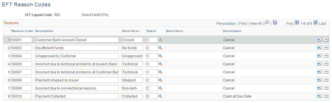

This example illustrates the fields and controls on the EFT Reason Codes page. You can find definitions for the fields and controls later on this page.
