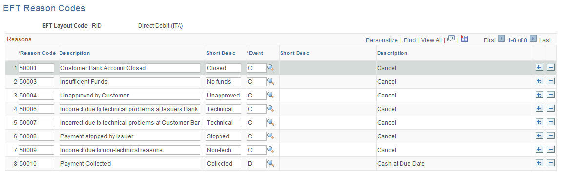

This example illustrates the fields and controls on the EFT Reason Codes page. You can find definitions for the fields and controls later on this page.

Set up the following reason codes for the RID files that are used in Italy. Other countries can use this as an example to set up their reason codes.
Reason Code Description Action
50001
Customer bank account closed.
Cancel direct debit.
50003
Insufficient funds.
50004
Unapproved by customer.
50006
Incorrect due to technical problems at issuer bank.
50007
Incorrect due to technical problems at customer bank.
50008
Payment stopped by issuer.
50009
Incorrect due to nontechnical reasons.
50010
Payment collected.
Apply cash.
