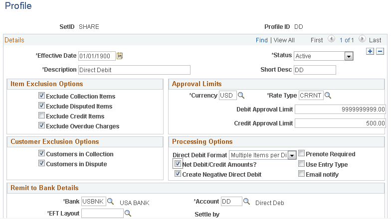

This example illustrates the fields and controls on the Direct Debit Profile - Profile page. You can find definitions for the fields and controls later on this page.
Direct Debit - Profile page
Item Exclusion Options
Use the check boxes in the Item Exclusion Options group box to prevent the Create Direct Debits process from selecting certain types of items when it creates direct debits and builds the worksheet.
Customer Exclusion Options
Use the check boxes in the Customer Exclusion Options group box to prevent the Create Direct Debits process from selecting items for customers who are in collection or dispute.
Approval Limits
The values that you enter in the Approval Limits group box determine whether the Create Direct Debits process automatically approves a direct debit or a direct credit. If the direct debit amount is within the approval limits, it assigns the status of Accepted. If the process does not approve the direct debit because it is over the approval limit, it assigns the status of Pending Approval.
Field or Control Description
Currency and Rate Type
Enter the currency and rate type for the profile. If the currency of the items in the direct debit differs from the currency in the profile, the Create Direct Debits process uses the rate type to convert the amount for comparison.
Debit Approval Limit
Enter the maximum amount that a direct debit can be for the Create Direct Debits process to approve it.
Credit Approval Limit
Enter the maximum amount that a direct credit can be for the Create Direct Debits process to approve it.
Processing Options
Direct Debit Format
Select a format option. Values are:
  • Multiple Item Lines / DD: Creates a separate direct debit for each item, regardless of the number of items that are specified in settings on the EFT layout. However, if an item has multiple item lines, the item and all item lines are entered as a single direct debit.
  • Multiple Items / DD: Creates one direct debit for all items that have a matching business unit, customer, due date, and currency.
  • One Item / Direct Debit: Creates a separate direct debit for each item, regardless of the number of items that are specified in settings on the EFT layout.
Prenote Required
Select this check box to enable you to create, transmit, and receive confirmation of direct debit prenotes. The PeopleSoft Receivables Direct Debit Application Engine (AR_DIRDEBIT) processes these prenotes, which help to eliminate additional processing or handling fees due to the transmission of incorrect customer account information to the customer's bank. Prenotes also reduce any delays in receivable collections.
Note: If this check box is selected, the system verifies that the selected EFT Layout that you select can be used to transmit prenotes.
See Understanding Direct Debit Processing.
Net Debit/Credit Amounts?
Select to have the Create Direct Debits process create one direct debit that corresponds to the net of all debit and credit open items for the selected business unit, customer, due date, and currency.
This field is not available if the Exclude Credit Items field is selected.
Use Entry Type
Select to use the direct debit profile that you assigned to the entry type for the item on the Entry Type page instead of the direct debit profile that you assigned to the bill to customer. The Create Direct Debits process selects only items for which the entry type matches the direct debit profile that you select on the run control page and the process uses that profile to determine the processing options.
Note: If you do not assign a direct debit profile to an entry type, the system uses the direct debit profile that you assigned to the bill to customer.
Create Negative Direct Debit
Select to indicate that the Create Direct Debit process (AR_DIRDEBIT) creates negative direct debits.
For this field to appear, you must select the Net Debit/Credit Amounts? field.
For more information about the Create Direct Debit process:
See Creating and Working with Direct Debits.
Email Notify
Select to indicate that the Bill To customer should receive a remittance advice through e-mail. This applies to all Bill To customers who are associated with this direct debit profile
Also enables the delivery of Direct Debit (DD) remittance advice information to a customer contact using e-mail. You must select this check box in the Direct Debit profile and set up a customer contact in order to notify the assigned customer contact that the customer's bank has been instructed to withdraw money from the customer's account in their bank.
Note: An e-mail is also sent when a canceled direct debit is reprocessed. However, the system does not send an e-mail when a direct debit payment cancellation occurs.
