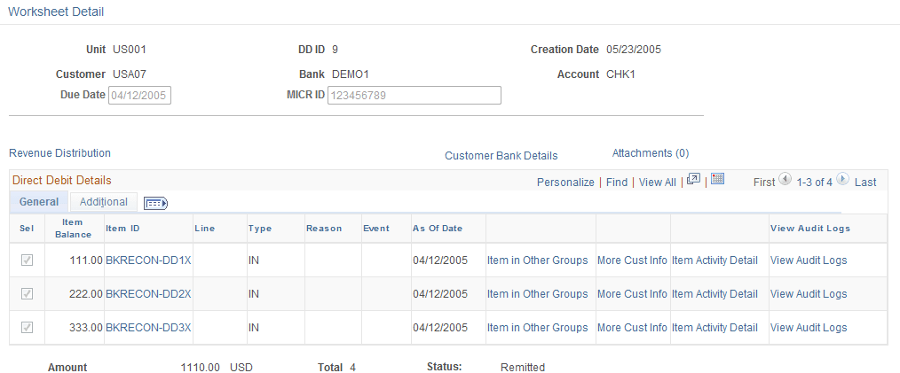

Worksheet Detail Page
DD_WORKSHEET_SEC
View or change details about a direct debit, such as the bank account or individual items.

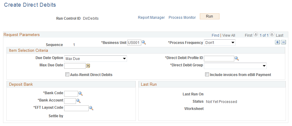

Create Direct Debits Page
Use the Create Direct Debits page (DD_REQUEST) to create direct debits by running the Create Direct Debits process.
Navigation:
Accounts Receivable, and then Direct Debits, and then Administer Direct Debits, and then Create Direct Debits, and then Create Direct Debits
This example illustrates the fields and controls on the Create Direct Debits page. You can find definitions for the fields and controls later on this page.
Item Selection Criteria
Field or Control Description
Due Date Option
Select Max Due (maximum due date) to process open items with due dates that are the same as or earlier than the date that you enter. When you select this option, the field that follows becomes Max Due Date (maximum due date).
Select Days Prior to process items before the due date. For example, if you enter 10 in the Days Prior to Due Date field, the process selects all items that are due within 10 days from the current date.
Note: If the Direct Debit Group field is Direct Debit, then the calculation of the direct debit due date must be less than, or equal to, the Receivables Update process (ARUPDATE) run date to close the direct debit. The calculation of the direct debit due date results from the option selected in the Due Date Option field of the Create Direct Debit run control page. If the direct debit due date is greater than the Receivables Update process run date, then the direct debit is not closed.
Direct Debit Profile ID
Select the profile whose processing parameters you want to use. This restricts the selection of open items to those customers who have the same profile.
Direct Debit Group
Select the direct debit group assigned to the customers whose items you want to process. This restricts the selection of open items to those customers who have the same group.
Auto-Remit Direct Debits
Select to automatically assign a Remitted status to direct debits with no exceptions. If any of the direct debits that the process creates have exceptions, their status is Pending on the direct debit worksheet. Set the default for this field on the Receivables Definition - Accounting Options 2 page.
Include Items from eBill Payment
Select to include items from PeopleSoft eBill Payment in this process run. The eBill Payment items will be selected based on the Payment Date that was set in eBill Payment.
To ensure payments are received by the Payment Date of the item, Lead Time will be considered. Lead time represents the number of business days that will be subtracted from the Payment date for an item to determine when the Direct Debit process needs to select that item for payment. You can set up Lead Time on the MICR Information - Customer Bank page (Customers, Customer Information, MICR Information, Customer Bank) or the External Accounts - Collection Methods page (Banking, Bank Accounts, External Accounts, Collection Methods).
If the Use Lead Time and Holiday List from Biller's Bank check box is deselected in MICR ID setup, then Direct Debit Lead Time Days and Holiday List ID will be read from MCIR ID setup. However, if the Use Lead Time and Holiday List from Biller's Bank check box is selected in MICR ID setup, then Direct Debit Lead Time Days and Holiday List ID will be read from the external bank account setup.
See PeopleSoft Order to Cash Common Information: MICR Information - Customer Bank Page.
See PeopleSoft Banks Setup and Processing: External Accounts - Collection Methods Page.
Deposit Bank
Bank Code and Bank Account
Enter the bank code and account number where the funds are collected. The system populates the Bank Code and Bank Account fields based on the values in the direct debit profile ID that you select. To send the funds to a different bank account, override the bank information.
EFT Layout Code (electronic file transfer code)
Enter the EFT layout code used to request the funds. The system populates the layout code from the direct debit profile ID that you select. To use a different layout, override the code.
Settle By
Displays the remittance method that you assigned to the EFT layout on the Collection Methods page for the bank account. Values are:
01 Financial Gateway: Sends the settlement request to PeopleSoft Cash Management Financial Gateway. Financial Gateway creates the EFT files and submits them to the bank. You receive acknowledgement statuses from Financial Gateway.
02 Format EFT: Generates an EFT file in PeopleSoft Receivables, which you send to the bank manually or through a third-party integration.
The Create Direct Debits process assigns the remittance method to each direct debit that it creates. When you run the other direct debit processes, each process checks the Settle By field for the direct debit to determine whether to process the direct debit.
See Understanding the Direct Debit Remit Process.
Prenotes may be required, which are processed using the Create Direct Debit process.
See the Understanding the Set Up and Processing of Direct Debits with Prenotes section in this topic.
Last Run
Direct Debits icon
When the process is complete, click the Direct Debits icon to display the direct debit worksheet number, Last Run On date and time, and status information for the process that was just run.

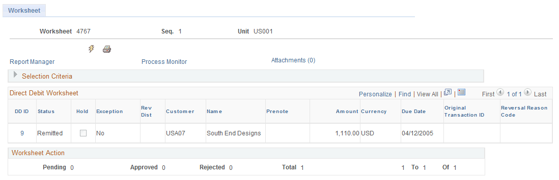

Update Direct Debits - Worksheet Page
Use the Update Direct Debits - Worksheet page (DD_WORKLIST) to approve, hold, or reject direct debits.
Mark the direct debits as ready for remittance to the bank.
Create an EFT file for the direct debits on the worksheet.
Navigation:
  • Accounts Receivable, and then Direct Debits, and then Administer Direct Debits, and then Update Direct Debits, and then Worksheet
  • Click the Direct Debit button on the Create Direct Debits page.
This example illustrates the fields and controls on the Update Direct Debits - Worksheet page. You can find definitions for the fields and controls later on this page.
Accounting Date
The accounting date is set to the current date if you leave the field blank. This field is available only when the worksheet can be remitted; that is, when the status of each direct debit in the worksheet is set to the Accepted value or the No Action value. The system edits the accounting date to ensure it is in an open accounting period.
Entering Selection Criteria
In the Selection Criteria group box, select the direct debits that you want to display.
Status
Select the status for the direct debits. Options are: Accepted, Complete, No Action, Pending, Rejected, or Remitted.
Exception
Select all the direct debits or only those that have the specified exception condition.
See Worksheet Detail Page.
DR/CR (debit or credit)
Select :
  • All to display both direct debit debits and credits in the Direct Debits grid.
  • Debits to display only direct debit debits in the Direct Debits grid.
  • Credits to display only direct debit credits in the Direct Debit grid.
Direct Debit Amounts >= (direct debit amounts greater than or equal to)
Enter a direct debit amount value. When you click the Change Criteria icon, the system displays the direct debits that have an amount greater than or equal to this specified amount.
Click the Change Criteria icon to update the list of direct debits based on your new selection criteria.
Working with Direct Debits
Use the following icons to act on individual direct debits.
Select All icon
Click the Select All icon to select all displayed direct debits on the worksheet (select all check boxes). If you prefer, you can select individual direct debits by selecting the check box to the right of each direct debit. This option works only in conjunction with the Approve and Reject buttons.
Approve icon
Click the Approve icon to approve all selected direct debits. The system changes their status to Accepted.
Reject icon
Click the Reject icon to reject all selected directs debits. The system changes their status to No Action. This means that the associated items will be available for selection the next time you create direct debits. After the direct debit has been rejected, you can also change the item from direct debit to another payment method on the item details page (ITEM_MAINTAIN).
Use the following icons to act on the entire worksheet. You cannot use these icons to work on individual direct debits.
Remit to Bank icon
Click the Remit to Bank icon to mark all approved direct debits with a Remitted status. This means that the direct debits are ready to be posted and remitted to the bank. This icon is available only when the status of all the direct debits in the worksheet is either Accepted or No Action. None of the direct debits can have a Pending Acceptance status.
Note: You must run Receivables Update before you can create the EFT file and remit it to the bank.
Generate EFT File icon
Click the EFT icon to generate an EFT file.
See Update Direct Debits - Worksheet Page.
Print icon
Click the Print icon to generate the Direct Debit Remittance Advice (ARX37501) to send to the bank.
None of the options on the worksheet are available while the Receivables Update process is processing the direct debits. To determine whether it is processing the direct debits, view the DD Control (direct debit control) page for the direct debit group. It displays the message, In Progress if the Receivables Update process is currently processing the group.
Use the Worksheet Detail page (DD_WORKSHEET_SEC) to view or change details about a direct debit, such as the bank account or individual items.
Navigation:
Click the DD ID (direct debit ID) link for the direct debit on the Update Direct Debits - Worksheet page.
This example illustrates the fields and controls on the Worksheet Detail page. You can find definitions for the fields and controls later on this page.
Use the information at the top of the page to view or change details about the direct debit.
Bank and Account
Displays the bank account where the funds are deposited.
Due Date
Displays the date that the funds should be deposited in your organization's bank account. Override the date if needed.
MICR ID (magnetic ink character recognition ID)
Displays the MICR ID associated with the customers bank account from which the funds are withdrawn. Change the ID to another account if needed.
Revenue Distribution
Click to access the Multiple Revenue Line Distribution page (AR_MLR_SEC) where you distribute revenue to control budgets for partial payments when an item has multiple revenue lines.
See Distributing Amounts for Multiple Revenue Lines for Control Budgets.
Document Sequencing
Click to view document sequencing information.
Customer Bank Details
Click to view or change information about the customer's bank account (identified by the MICR ID) on the Customer Bank Account Details page (CUST_BANKINFO_SEC).
Edit icon
Click the Edit icon to change information for the direct debit. The status on the Worksheet page changes to Pending. The fields on the Worksheet Detail page become available to edit.
Sel (select)
Remove items from the direct debit by clearing their check boxes. When you deselect an item, the total amount of the direct debit decreases and the item is available for selection in another direct debit request.
Item Balance
To partially pay for an item, change the amount to the amount you want to pay. This decreases the amount of the direct debit. The Receivables Update process adjusts the balance for the item when you post the direct debit group, and the remaining balance of the item will be available for selection in another direct debit request.
Event
Enter the entry event code to generate the appropriate supplemental accounting entries for the item activities. Federal financial systems require supplemental accounting entries.
After you make changes, select another action by clicking one of the following icons. This changes the status of the direct debit on the Worksheet page.
Approve icon
Click the Approve icon to change the direct debit's status to Accepted.
Reject icon
Click the Reject icon to reject the direct debit and change its status to No Action. The items in the direct debit will be available for selection in another direct debit request. Or you can click the Item ID to change from direct debit to another payment method on the item details page (ITEM_MAINTAIN).
Hold icon
Click the Hold icon to put the direct debit On Hold. The status on the Worksheet page remains Pending. If you put a direct debit on hold, you cannot change the status to Remitted. You must first approve the direct debit.
