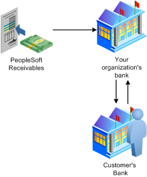

When you run the Format EFT File process to generate the EFT file in PeopleSoft Receivables, you must either manually submit the EFT file to the bank or use a third-party integration to submit it. You can optionally generate a cover letter for each EFT file if one is required by the customer's bank.
This diagram shows the process flow when you generate the EFT file in PeopleSoft Receivables and submit it to your organization's bank, which sends it to your customer's bank who sends the payment back to the bank again.
Process for EFT files generated in Receivables

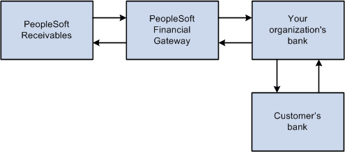

Create EFT Through FG System Process
When you run the Create EFT through FG System (create electronic file through Financial Gateway process) process, PeopleSoft Cash Management Financial Gateway generates the EFT file and sends the file to the bank. The Create EFT through FG System process triggers the Payment Request message (PAYMENT_REQUEST) and sends a message containing direct debits to Financial Gateway. Financial Gateway generates the EFT file and submits it to the bank the next time you run the Payment Dispatch process (PMT_DISPATCH or PMT_DISP_BT).
This diagram shows the flow of the direct debit transaction if you select PeopleSoft Cash Management Financial Gateway to remit direct debits. PeopleSoft Receivables sends the direct debit transaction to PeopleSoft Financial Gateway, which sends it to your organization's bank, which sends it to the customer's bank. The customer's bank sends a payment to your organization's bank which sends it to Financial Gateway, which updates PeopleSoft Receivables.
The customer's bank sends a payment to your organization's bank which sends it to the Financial Gateway module in Cash Management, which updates PeopleSoft Receivables.
Process for EFT files generated in Financial Gateway

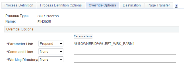

Override Options Page
Use the Override Options page (PRCSDEFNOVRD) to enter override options for the Format EFT File process.
Navigation:
PeopleTools, and then Process Scheduler, and then Processes, and then Override Options
This example illustrates the fields and controls on the Override Options page. You can find definitions for the fields and controls later on this page.
If you run PeopleSoft Receivables on a DB2 database on a Windows or OS390 server, you must manually insert an owner ID parameter in the list of parameters for the process definition before you can run the Format EFT Files process.
Field or Control Description
Parameters List
Enter Prepend.
Parameters
In the Parameters field next to the Parameters List field, enter %%OWNERID%% :EFT_WRK_PARM1 as shown in the example above. Note that there is a space between the owner ID parameter ( %%OWNERID%%) and :EFT_WRK_PARM1.
