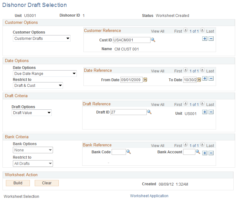

Dishonor Draft Selection Page
Use the Dishonor Draft Selection page (DRAFT_DISH_SEL_IC) to build a dishonor draft worksheet.
Navigation:
Accounts Receivable, and then Drafts, and then Dishonor Drafts, and then Dishonor Drafts Worksheet, and then Dishonor Draft Selection
This example illustrates the fields and controls on the Dishonor Draft Selection page. You can find definitions for the fields and controls later on this page.
Worksheets are cumulative. As long as you do not clear the worksheet, you can keep expanding it by selecting additional criteria. Each time you build a worksheet, the drafts you previously selected remain, and the system adds drafts that meet the new criteria to the worksheet.
The Restrict To field works basically the same for all selection criteria. They determine how reference information should be combined with other selection options to determine which drafts appear in the worksheet. The values vary based on the selection criteria you enter. Values include:

Customer Options
You can use the customer options to build a worksheet for a specific customer ID.
Field or Control Description
Customer Options
Select None if you fill in the fields under Date Options, Draft Criteria, or Bank Criteria.
Cust ID (customer ID)
Enter the customer's ID or business unit. The customer's name automatically appears, and the Customer Options field changes to Customer Drafts.
Date Options
Date Options
Select an option for selecting drafts by a date. Options are: None, Due Date Range, Due Date, and Accounting Date Range.
Restrict to
Options are: All Drafts, Customer Only, Draft & Cust, and Draft Only.
From Date and To Date
Enter a date range if you want to build a worksheet for drafts using specific due dates or accounting dates.
Draft Criteria
Draft Options
Select None if you fill in the fields under Customer Options, Date Options, or Bank Criteria.
Draft ID
Enter the draft ID if you want to build a worksheet for a specific draft. The Draft Options field changes to Draft Value.
Bank Criteria
Bank Code and Bank Account
Enter bank information if you want to build a worksheet for a specific bank account. The Bank Options field changes to Bank Account.
Bank Options
Options are: None and Bank Account.
Restrict to
Options are: All Drafts, Cust & Date (customer and date), Customer Only, Date Range Only, and Draft Only.
Worksheet Action
Build
Click to build the worksheet.
Clear
Click to remove all drafts from an existing worksheet.

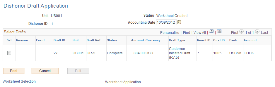

Dishonor Draft Application Page
Use the Dishonor Draft Application page (DRAFT_DISH_WORK_IC) to select drafts that you want to dishonor.
Navigation:
Accounts Receivable, and then Drafts, and then Dishonor Drafts, and then Upd Dishonor Draft Worksheet, and then Dishonor Draft Application
This example illustrates the fields and controls on the Dishonor Draft Application page. You can find definitions for the fields and controls later on this page.
Select each draft that you want to dishonor.
Reason
Enter a reason code to display on the Draft Inquiry page. You can also use that code in custom reports. If the draft type does not require a reason, you can enter a reason for an audit trail.
Post
Click to set the group to post.
Cancel
Click to cancel the worksheet. You can then include the drafts in a new worksheet.
Edit
After you click Post (and before posting), click to select or deselect more drafts. If you want to edit the worksheet after it is posted, you must unpost the group first.
