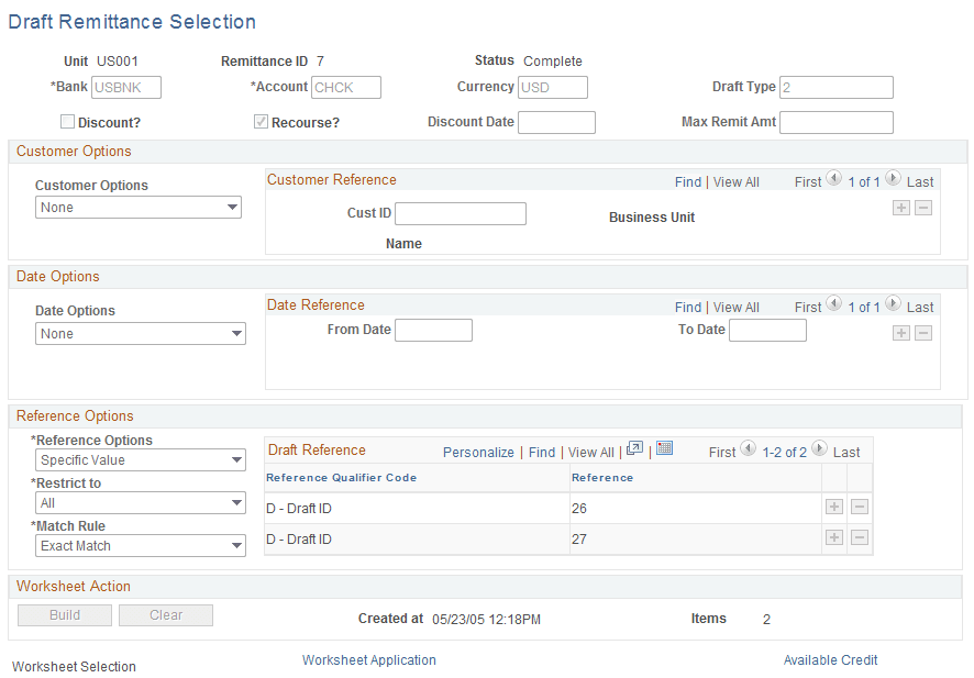

Draft Remittance Selection Page
Use the Draft Remittance Selection page (DR_REMIT_SEL_IC) to build a draft remittance worksheet.
When you build the worksheet, you have the option of discounting drafts for payment before the due date.
Navigation:
Accounts Receivable, and then Drafts, and then Remit Drafts to Bank, and then Remit Draft to Bank Worksheet, and then Draft Remittance Selection
This example illustrates the fields and controls on the Draft Remittance Selection page. You can find definitions for the fields and controls later on this page.
Worksheets are cumulative. As long as you do not clear the worksheet, you can keep expanding it by selecting additional criteria. Each time you build a worksheet, the drafts you previously selected remain and the system adds drafts that meet the new criteria to the worksheet.
Field or Control Description
Bank and Account
Enter a bank code and account number. The bank account must have a draft collection method defined on the External Accounts - Collection Method page.
Currency
Displays the default currency of the bank account. Change the currency as needed.
Draft Type
Select a draft type to limit the worksheet to specific types of drafts. If you leave this field blank, the worksheet includes only drafts that allow discounts. If you select a draft type that does not allow discounts, you cannot enter discount information in the other fields.
Discount?
Select to discount all drafts in the remittance for early payment.
Recourse?
Select if you are still responsible for the draft amount up until the original due date of the draft. In other words, the amount appears as a liability on your books until your bank receives the funds.
Discount Date
Enter a discount date after selecting the Discount? check box.
Max Remit Amt (maximum remittance amount)
Enter the maximum remittance amount that you will send to the bank. If the total of the drafts exceeds this amount, you receive a warning message when you mark the worksheet Complete. The amount displays in the currency for the bank account.
Available Credit
Click this link to access the Available Credit page (DR_REMIT_CRED_SEC), where you can determine if you have enough credit left with the bank to discount more drafts.
Customer Options
Use these options to create a worksheet with drafts for a particular customer ID. When you specify a customer, the name of the customer appears and the Customer Options field changes to Customer Drafts. The system includes all the customer's drafts in the worksheet.
Date Options
Use these options to create a worksheet with drafts that have a specific date range.
Date Options
When you specify a date range, the Date Options field changes to Due Date Range. You can change the selection to Accounting Date Range.
Reference Options
Reference Qualifier Code
Enter the type of information used to identify the drafts. Then, use the Reference and To Reference fields to fill in the details. Options are:
B - Customer Bank: Enter your customer's bank account and branch.
D - Draft ID: Enter a draft ID.
G - Customer Group: Enter a customer group code.
R - Draft Reference: Enter a draft document reference number.
Reference Options and Match Rule
Options are Specific Value (to match specific values) or None. If you select Specific Value, use the Match Rule field to select Exact Match or Like Match. Like Match compares the beginning characters. For example, a like match of 24% includes all items beginning with 24.
Restrict To
Select how reference information should be combined with other selection options to determine which drafts appear in the worksheet. Options are:
All: Builds a worksheet with only drafts that meet the reference criteria with no reference to the other options.
Customer Only: Builds a worksheet with drafts that match the reference criteria and belong to the specified customers.
Date Only: Builds a worksheet with drafts that match the reference criteria and are in the specified date range.
Customer and Date: Builds a worksheet with drafts that match the reference criteria, belong to the specified customers, and are in the specified date range.
Worksheet Action
Build
Click to build a draft remittance worksheet.
Clear
Click to remove all drafts from an existing worksheet.

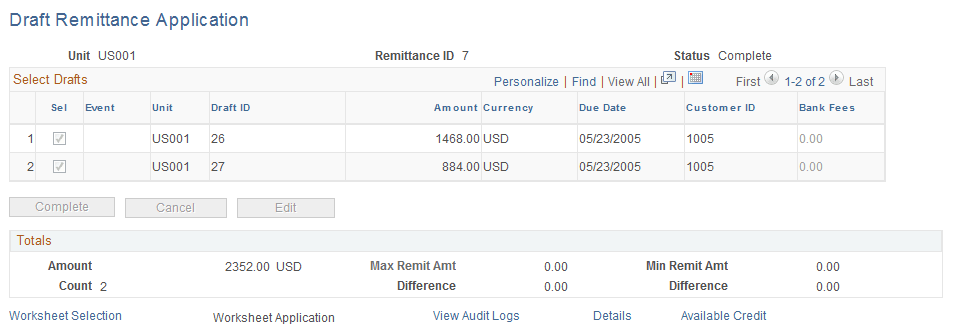

Draft Remittance Application Page
Use the Draft Remittance Application page (DR_REMIT_WORKS_IC) to select drafts that are ready for remittance.
Navigation:
This example illustrates the fields and controls on the Draft Remittance Application page. You can find definitions for the fields and controls later on this page.
By default, the check box next to each draft is selected. If you do not want to remit a draft, deselect its check box.
Due Date
Displays the date that you expect the bank to receive payment. If the draft is a discounted draft, the bank deposits the funds in the account on the discount date.
Bank Fees
Click to open a page where you can enter bank fees for discounted drafts.
Complete
Click to approve all selected drafts for remittance and to mark the worksheet as complete.
Cancel
Click to cancel the remittance. You can then include the drafts in a new worksheet.
Edit
After you click Complete (and before posting), click to edit drafts. Then, click Complete again to mark the worksheet complete.
Amount and Count
Displays the total amount and count of the drafts that you selected.
Displays the maximum remittance amount that you can send to the bank. You indicate this number when you build the worksheet.
Difference
Displays the difference between the maximum remittance amount and the amount of the selected drafts.
Min Remit Amt (minimum remittance amount)
Displays the minimum amount the bank will let you remit if the drafts are discounted. You specify this amount on the Collection Methods page.
Difference
Displays the difference between the amount of the selected drafts and the minimum remittance amount.
Details
Click to access the Remittance Details page (DR_REMIT_WS_SEC_IC), where you can change remittance details for a draft.

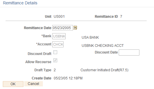

Remittance Details Page
Use the Remittance Details page (DR_REMIT_WS_SEC_IC) to view or change remittance information for the drafts.
Navigation:
Click the Details link on the Draft Remittance Application page.
This example illustrates the fields and controls on the Remittance Details page. You can find definitions for the fields and controls later on this page.
Remittance Date
Enter the date that you remit the draft to the bank for payment. Override today's date, if needed.
Bank and Account
Change the bank account to which you submit the draft, if needed.
Discount Draft
If this check box is selected, you can change the discount date for discounted drafts.
Allow Recourse
If selected, you are still responsible for the draft amount up until the original due date of the draft. In other words, the amount appears as a liability on your books until your bank receives the funds.
