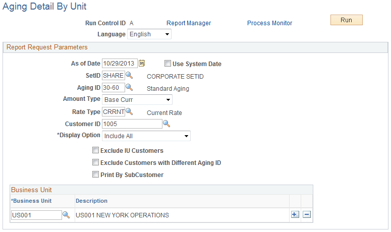

Aging Detail By Unit Page
Use the Aging Detail By Unit page (RUN_AR30003) to define the run parameters for the Aging Detail by Unit report (AR30003).
Use the report to see aged open balances for all items in a business unit in either the base currency or the entry currency. Option to include subcustomers. (SQL)
If the Aging Setup has more than six columns, the AR30003 report prints the first five columns and then automatically prints a sixth column labeled Other. The Other column summarizes all additional amounts that would go into columns six, seven, eight, and so forth.
Navigation:
Accounts Receivable, and then Receivables Analysis, and then Aging, and then Aging Detail by Unit Rpt, and then Aging Detail by Unit
This example illustrates the fields and controls on the Aging Detail By Unit page.

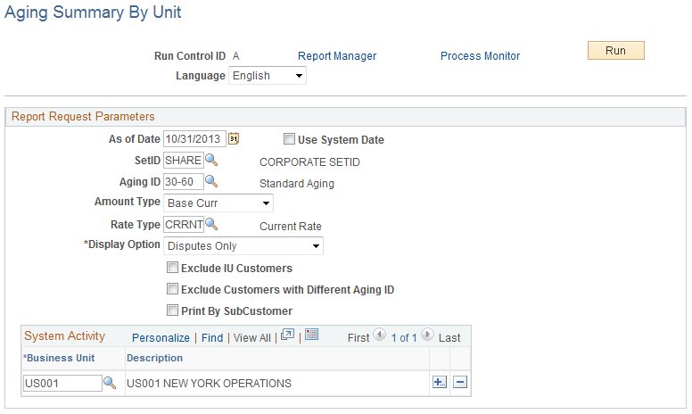

Aging Summary By Unit Page
Use the Aging Summary by Unit page (RUN_AR30004) to define the run parameters for the Aging Summary by Unit report (AR30004).
Use the report to see aged open balances for every customer in a business unit in either the base currency or the entry currency of the unit. Select the entry currency to show subtotals by currency. Option to include subcustomers. (SQL)
If the aging setup includes more than six columns, the report prints the first five individual columns and includes a sixth summarized column labeled ‘Other.’ The Other column summarizes all additional amounts that would go into columns six, seven, eight, and so forth.
Navigation:
Accounts Receivable, and then Receivables Analysis, and then Aging, and then Aging Summary by Unit Rpt, and then Aging Summary by Unit
This example illustrates the fields and controls on the Aging Summary By Unit page.

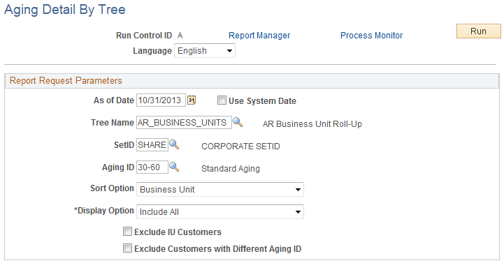

Aging Detail By Tree Page
Use the Aging Detail by Tree page (RUN_AR30001) to define the run parameters for the Aging Detail by Tree report (AR30001).
Use the report to see aged open balances for all items associated with a tree structure in the base currency of the business unit. You can run the report using these trees in the sample database or using trees with a structure similar to these trees: AR_CORP_CUST, AR_BUSINESS_UNITS, COLLECTOR, CR_ANALYST, and SALES_PERSON. (SQL)
Navigation:
Accounts Receivable, and then Receivables Analysis, and then Aging, and then Aging Detail by Tree Rpt, and then Aging Detail by Tree
This example illustrates the fields and controls on the Aging Detail By Tree page.

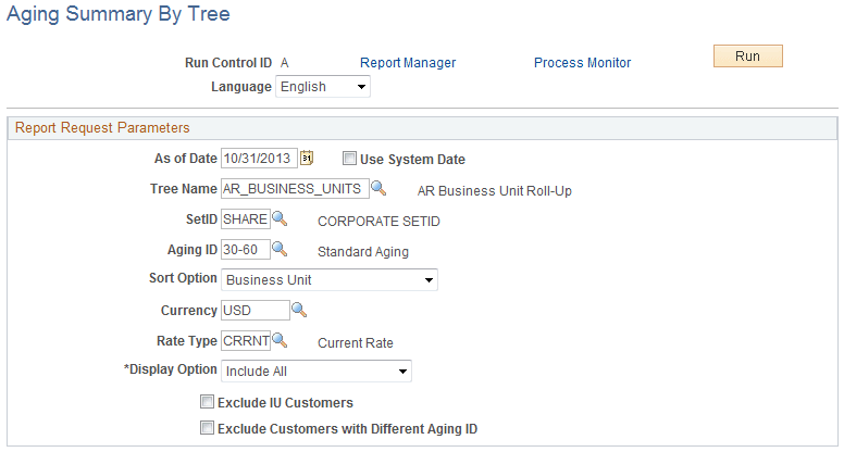

Aging Summary By Tree Page
Use the Aging Summary by Tree page (RUN_AR30002) to define the run parameters for the Aging Summary by Tree report (AR30002).
Use the report to see aged open balances for a tree structure in the base currency of the business unit. You can run the report for these trees: AR_CORP_CUST, AR_BUSINESS_UNITS, COLLECTOR, CR_ANALYST, and SALES_PERSON. (SQL)
Navigation:
Accounts Receivable, and then Receivables Analysis, and then Aging, and then Aging Summary by Tree Rpt, and then Aging Summary by Tree
This example illustrates the fields and controls on the Aging Summary By Tree page.

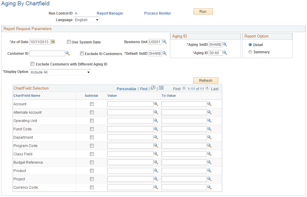

Aging By ChartField Page
Use the Aging By Chartfield page (RUN_AR30006) to define the run parameters for the Aging By ChartField report (AR30006).
Choose from Detail or Summary report options. Use this report to see aged receivables by customer, item, and ChartField selection. (SQL)
Navigation:
Accounts Receivable, and then Receivables Analysis, and then Aging, and then Aging by Chartfield Rpt, and then Aging By Chartfield
This example illustrates the fields and controls on the Aging By Chartfield page.
Field or Control Description
Report Option
Select the level of report detail. Values are:
Detail: Includes the individual item detail within a customer.
Summary: Summarizes information by customer.
Refresh
Click to display a list of ChartFields in the Field Long Name column.
Exclude IU Customers (exclude interunit customers)
Select to exclude interunit customers from the report. Customers are designated as interunit on the customer's Bill to Options page (Customer, Customer Information, General Information, Bill to Options).
ChartField Selection
Use the ChartField Selection group box to determine which items are included in the aging totals. The process ages items that have distribution lines that include the ChartField values that you entered.
ChartField Name
Displays a list of ChartFields.
Subtotal
Select the ChartField for which you want to subtotal amounts.
Value and To Value
Select the range of ChartField values for each ChartField for the items that you want to age. If you do not enter any values, the system automatically ages all items that have any AR account value in the distribution lines.

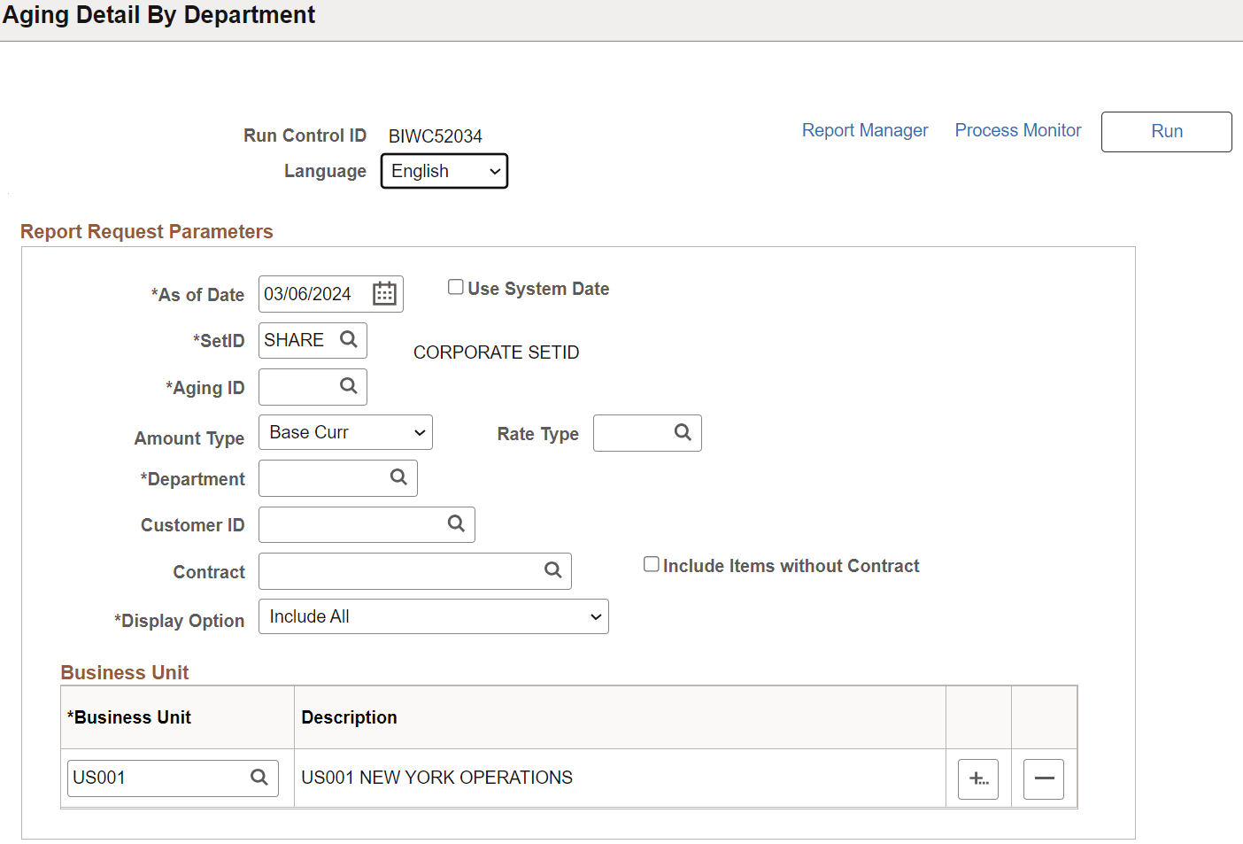

Aging Detail By Department Page
Use the Aging Detail By Department run control page (RUN_AR30009) to define run parameters for the Aging Detail by Department report (AR30009).
Use the report to see the age of open balances for all items in a given department, totaled by contract number and grouped by customer ID and business unit. Select the entry currency to show subtotals by currency. (SQL)
Navigation:
Accounts Receivable, and then Receivables Analysis, and then Aging, and then Aging by Department Report, and then Aging Detail By Department
This example illustrates the fields and controls on the Aging Detail By Department page.
Aging ID
Enter an aging ID defined in the system.
Amount Type
Select from Base Curr (base currency) or Entry Curr (entry currency).
Rate Type
Enter a rate type.
Department
Enter a department ID. Enter ALL_DEPTS to run the report for all departments.
Customer ID
Enter a customer ID.
Contract
Enter a contract ID or a wildcard (%) for all contracts for the selected department and customer.
Include Items without Contract
Select the check box to include items without contract on the report.
Display Option
Select an option from the drop-down list:
  • Collections Only
  • Deductions Only
  • Disputes Only
  • Include All
