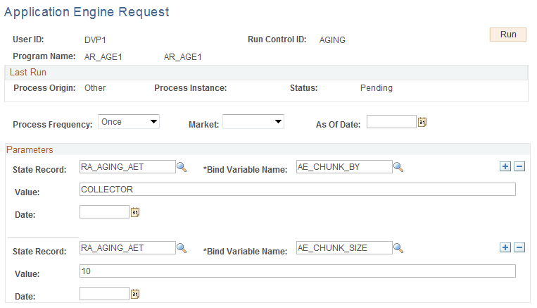

This example illustrates the fields and controls on the Application Engine Request page. You can find definitions for the fields and controls later on this page.
Use the State Record, Bind Variable Name, and Value fields to define exactly what data you want to age. Parameters enable you to process smaller units of data. Add as many rows as needed.

Age customers by associated collector and chunk collectors in groups of 10.
First row:
State Record: RA_AGING_AET
Bind Variable Name: AE_CHUNK_BY
Value: COLLECTOR
Second row:
Bind Variable Name: AE_CHUNK_SIZE
Value: 10
