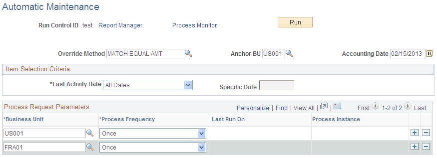

Use the Automatic Maintenance page (AUTOMNT_REQUEST) to run the PS/AR Automatic Maintenance Application Engine process (AR_AUTOMNT) and/or reports.
Navigation:
Accounts Receivable, and then Receivables Maintenance, and then Automatic Maintenance, and then Request Automatic Maintenance, and then Automatic Maintenance
This example illustrates the fields and controls on the Automatic Maintenance page.
Field or Control Description
Override Method
Select an automatic maintenance method if you want to use the same method for all items instead of the method assigned to the business unit.
Select one of these methods:
  • MATCH EQUAL AMT (match equal amount)
    Select to match debits and credits for items exactly by their open amounts.
  • NO MATCH WO (no match write-off)
    Select to write off debit or credit items that were not matched by the previous steps that have an amount that is less than the tolerances that you defined.
  • OLDEST
    Select to match using the #OLDEST algorithm, which matches items by due date.
  • REFERENCE MATCH
    Select to match by reference information.
  • RETAIN BALANCE
    Select to keep items with remaining balances open.
See Setting Up Automatic Maintenance Methods.
Anchor Business Unit
Select the business unit to use for transactions that cross business units for interunit accounting entries. Leave blank to use the business unit of the first item in each group as the anchor business unit for the maintenance group.
If you enter an anchor business unit, the system uses the format currency for the business unit to convert transaction amounts to a common currency. Otherwise, it uses the format currency for the lowest-value business unit that you enter in the Process Request Parameters grid. The process assigns the same anchor currency to each Maintenance worksheet that it creates. The system displays the worksheet totals in the anchor currency.
Note: The system uses the anchor business unit to perform an automatic write-off of a remaining amount.
Accounting Date
Enter the accounting date for the process to use as the accounting date for any new items that it creates. If you leave the field blank, the process uses the date at the time of the run as the accounting date.
Last Activity Date and Specific Date
Select one of the following values for the last activity date:
  • <= Specific Date - Selects items with a last activity date that is less than or equal to a date the user selects in the Specific Date field.
  • <= Today - Selects items with a last activity date that is less than or equal to the current date at the time the process is run.
  • All Dates - Selects all items regardless of the last activity date.
Business Unit
Enter the ID of all business units for which you want to match items. If you do not want to create match groups that include items across all business units, enter only one business unit.
