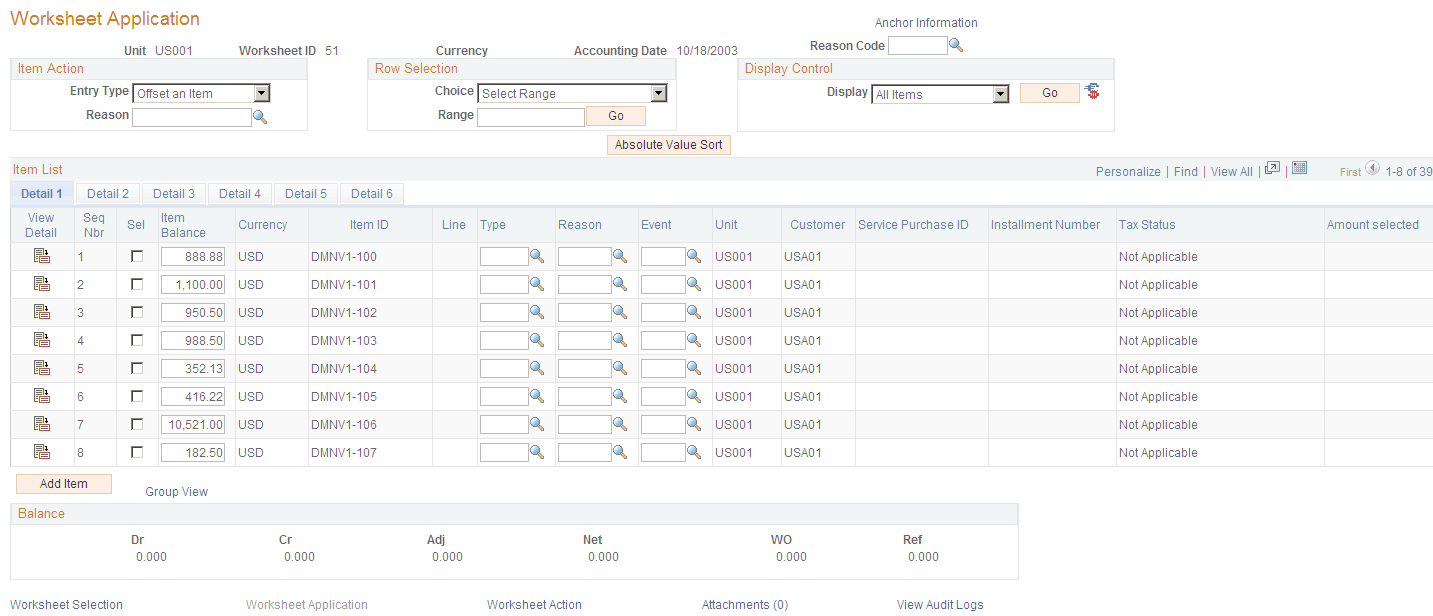

Maintenance Worksheet - Worksheet Application Page
WS_WORKSHEET_IC
Offset individual debits and credits, write off items, create new items, or refund items.

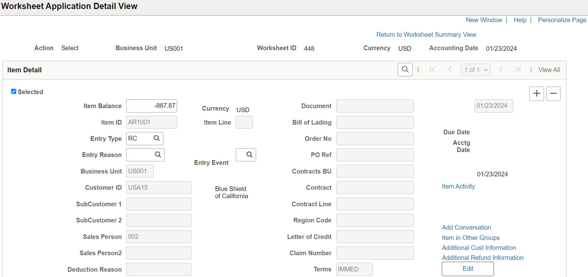

Maintenance Worksheet - Worksheet Application Detail View Page
WS_WORKSHT_IC_DTL
View or change details about a selected item on a worksheet. Write off a remaining balance for the worksheet.

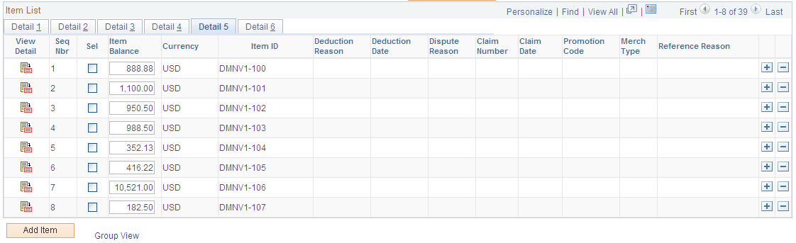

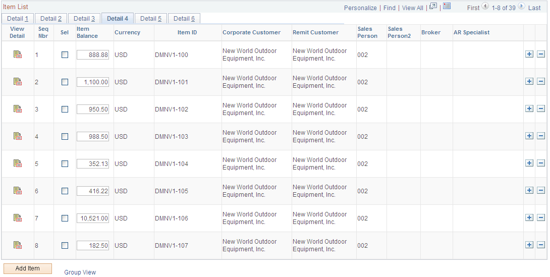

A maintenance worksheet is a workspace for offsetting, writing off, or adjusting posted items. You can also use maintenance worksheets to refund an item with a credit balance or to create a new refund item for a credit remaining from maintenance tasks.
If you make changes to an auto maintenance created worksheet, the Created by Auto Maintenance field value will not change and the worksheet will continue to be considered as created by auto maintenance.

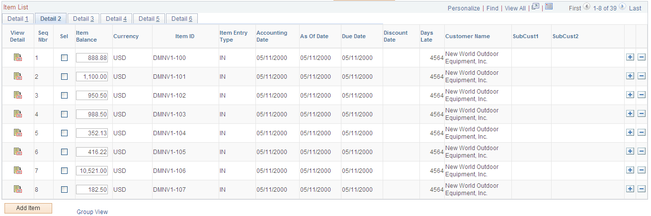

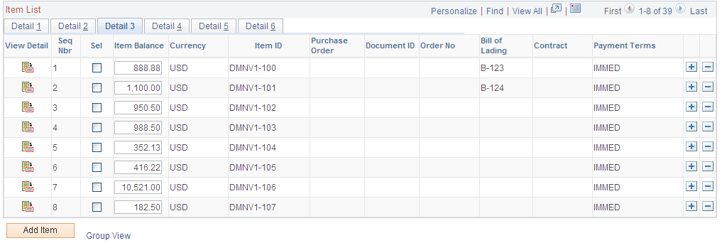

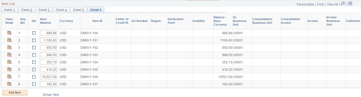

You can use two different views to work with the worksheet:
  • Use the normal view to work with items individually.
    Select the items that you want to maintain individually; however, the worksheet must have a zero balance at the end before you can post a worksheet. The amount of the debits that you selected and the amount of the credits that you selected, plus the amount of adjustments must equal zero.
  • Use the group view to work with items in match groups.
    Specify matching criteria to work with items in match groups. The total of the debit and credit items in each match group must equal zero before you can post the worksheet. You can change the amount of an item that you are matching, add and remove items in each match group, or create a write-off item for the remaining balance for a group. The system uses the anchor business unit to perform an automatic write-off of a remaining amount. This method is useful when you want to resolve deductions by matching them to offsetting credit memos.
    The Item Activity by Match Group page displays all the items in each match group for an item maintenance activity. This enables you to see all the offsetting items used to close an item.
    See Item Activity From a Match Group Page.
Because you frequently do not resolve the remaining balance for an item at one time, you can partially match a debit to a credit item or partially write off an item by changing the amount for the item on the worksheet. The system updates only the amount of the item that you specify.

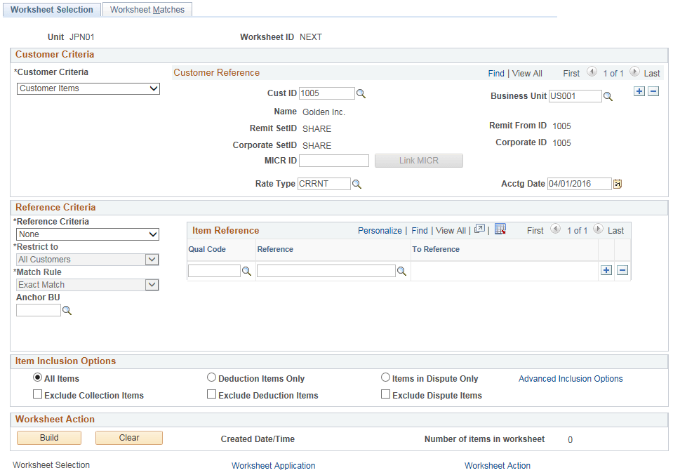

Maintenance Worksheet - Worksheet Selection Page
Use the Maintenance Worksheet - Worksheet Selection page (WS_IDENTIFY_IC) to create a new worksheet, or add and change items on an existing maintenance worksheet.
Navigation:
Accounts Receivable, and then Receivables Maintenance, and then Maintenance Worksheet, and then Create Maintenance Worksheet, and then Worksheet Selection
This example illustrates the fields and controls on the Maintenance Worksheet - Worksheet Selection page. You can find definitions for the fields and controls later on this page.
Customer Criteria
The Customer Reference fields and the Item Reference fields work together depending on how you choose the criteria. In the Customer Reference group box, you can select items based on Customer, and selection on the worksheet will be restricted to the specified Customer ID.
If you choose Customer Criteria = None, no items for the customer will be on the worksheet.
If you choose Customer Criteria = Customer Items, you only need to enter a Customer ID to build the worksheet with all items for the specified customer, regardless of business unit. If you enter a business unit, the selection is restricted to items with the Customer ID and Business Unit combination.
If you choose Customer Criteria = Corporate Items or Remit from Items, you must include a Business Unit as well as a Customer ID. The business unit will determine the SetID used in the Corporate or Remit customer part of the search. First, the selection will return all open items for the Customer ID and Business Unit specified. Second, the selection will also return any open items for all customers that are Corporate or Remit customers of the specified Customer ID and SetID combination (remember, SetID is determined by the specified Business Unit).
None of the items built onto the Worksheet from Customer Reference criteria will be automatically selected on the worksheet.
For example scenarios using multiple selection criteria, see Working with Multiple Selection Criteria on the Worksheet.
Field or Control Description
Customer Criteria
Select the type of customer that you want to include in the worksheet. Values are: Corporate Items, Customer Items, Remit From Items, and None. If you select None, the system creates a worksheet based on your other selection criteria and does not limit items to specific customers. In addition, if you select None, the Customer Reference fields are not available.
Cust ID (customer ID) and Business Unit
Enter a customer ID and business unit.
Note: If you select Corporate Items or Remit From Items in Customer Criteria, you must enter a business unit. The system needs a business unit to determine the SetID of corporate and remit from customers. The resulting worksheet displays all open items that have the specified corporate or remit from customer for the selected business unit.
Rate Type
Required if you are working with multiple currencies. The default value for the rate type comes from the value that you defined for the business unit on the Receivables Options - Payment Options page.
Note: If you do not enter a rate type and you select multicurrency items, the system returns you to the Worksheet Selection page, and you must start from the beginning. None of your work on the worksheet will be saved. To avoid accidentally losing your work, enter a rate type on the Receivables Options - Payment Options page so that you always have a default value on the Worksheet Application page.
MICR ID (magnetic ink character recognition ID)
(Optional) Enter the customer's MICR ID.
Link MICR
Link the customer's MICR ID to other customers who have the same MICR ID.
Accounting Date
For new worksheets, select the accounting date that you want to apply to all items that you select on the worksheet.
For existing worksheets, you can change the accounting date only if no items have been selected on the worksheet. If you have selected items, click the Clear button to clear the selections. Then change the accounting date.
Reference Criteria
The Item Reference grid is used to add and select items not found by the Customer Reference criteria onto the worksheet. Or, if the item is already found using the Customer Reference criteria, it will be automatically selected on the worksheet.
If you choose Reference Criteria = Specific Value or Range of References, the Restrict to field becomes active. You can restrict the Item search to the following selections:
  • Customer Only – Selects items matching the Item Reference values for only the customer(s) specified in the Customer Reference fields.
  • All Customers – Ignores any specified customer(s). The worksheet is built from items matching the Item Reference values, for all customers regardless of customers listed in the Customer Reference fields.
  • Corporate Cust Only - Selects items matching the Item Reference values for only the Customers listed in the Customer Reference fields and all Corporate Customers associated with those Customers by business unit.
  • Remit Cust Only - Selects items matching the Item Reference values for only the Customers listed in the Customer Reference fields and all Remit Customers associated with those Customers by business unit.
The only instance in which you can use reference criteria independently of customer criteria is when the Restrict to field is All Customers
Reference Criteria
Select a value that indicates how you will identify the items for the worksheet. Values are Specific Value, None, and a Range of References. If you select either Range of References or Specific Value, you work with the other two Item Reference fields.
Restrict To
Select a value to qualify items by customer. Values are All Customers, Corporate Cust Only, Customer Only, and Remit Cust Only.
Match Rule
If you selected Specific Value in the Reference Criteria field, specify whether the item information is an exact match or a like match. A like match enables you to use a percent (%) wildcard to identify the reference, as long as you provide the beginning letters or numbers. For example, if you enter a purchase order (PO) number of 24% and select Like Match, the worksheet will contain all items having PO numbers beginning with 24xx, but will not catch a PO number of x24x.
Anchor Business Unit
Select a business unit. The system uses the currency for the business unit as the anchor currency for conversion when items on the worksheet are in different currencies. The system also uses the maintenance control code (AR distribution code) that you assigned to this business unit to create offsetting accounting entries. The system uses this business unit when you perform an automatic write-off of a remaining balance.
If items are selected on the worksheet, you cannot change an anchor business unit. To change an anchor business unit, click the Clear button to clear the selections.
Currency
Enter the control currency for the worksheet. This field appears only if you enter reference values.
Reference and To Reference
If you selected Specific Value in the Reference Criteria field, enter the specific item reference. If you selected Range of References, enter the starting and ending values for the range of references.
Reference Qualifier Code
Select the type of reference, such as document, item, purchase order, or any other criteria that you set up on the Reference Qualifier page.
Note: You must enter a qualifier code before you enter a reference number if you do not have a default value assigned to the business unit.
Item Inclusion Options
All Items, Deduction Items Only, or Items in Dispute Only
Select one of these options to indicate the type of items to include in the worksheet.
Exclude Deduction Items, Exclude Collection Items, and Exclude Dispute Items
If you select All Items, you can also select one or more of the check boxes to exclude collection, deduction, and dispute items.
Advanced Inclusion Options
Click this link to access the Filter Items secondary page (WS_ITEMSRCH_SEC), where you can create, edit, and save selection criteria for items to include in the worksheet. You can filter items using values in the following categories:
  • Item Selection Criteria - Enter the owner value by type, such as AR Specialist, Credit Analyst, Broker ID, Collector, and Sales Person.
  • Reference Data - Enter order-to-cash reference values, such as Item ID, Item Entry Type, Entry Reason, Invoice, Order Number, Document ID, Proof of Delivery, Bill of Lading, Purchase Order, PO Line, Claim Number, Contract, Promotion Code, Service Purchase ID, Sold To Customer, and Ship To Customer.
  • Item Type - Enter values including Collection Code, Deduction Reason and Date, and Dispute Reason and Date.
  • Balances - Select the Balance Currency.
  • Dates - Select items for the worksheet based on Accounting or Due Dates.
Worksheet Action
Build
Click to create a new worksheet or to add items that meet your selection criteria to an existing worksheet.
Clear
Click to remove all items from an existing worksheet.

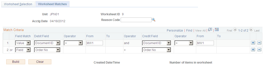

Maintenance Worksheet - Worksheet Matches Page
Use the Maintenance Worksheet - Worksheet Matches page (WS_WORKSHEET_MTCHS) to specify matching criteria to create match groups in the worksheet and build the worksheet.
Navigation:
Accounts Receivable, and then Receivables Maintenance, and then Maintenance Worksheet, and then Create Worksheet, and then Worksheet Matches
This example illustrates the fields and controls on the Maintenance Worksheet - Worksheet Matches page. You can find definitions for the fields and controls later on this page.
You specify the criteria for matching debit items to credit items in the Match Criteria group box. When you build the worksheet, the system displays groups of matching debit and credit items on the Worksheet Group View page.
Field Match
Select an option for matching the field values. Options are:
Field: Select to match any value in a specific debit item field to the exact same value in a specific credit item field. When you select this option, only the Debit Field and Credit Field are available.
Value: Select to match a specific or partial value in a specific debit field to a specific or partial value in a specific credit field.
Select the matching criteria for debits in the debit fields and the matching criteria for credit items in the credit fields.
For each line, select the field on the Item table (PS_ITEM) that you want to match. Values are Bill of Lading, Broker ID, Carrier ID, Claim Number, Class of Trade, Contract, Division, Document ID, Entry Reason, Family, Invoice, Item ID, Major Classification, Order No, Proof of Delivery, Purchase Order Ref, Sales Person, and Sales Person 2.
Operator
Select the operator for each field match:
= (equal): Matches the exact value that you enter in the From field.
BTW (in between): Matches a range of values that you enter in the From and To fields. For example, if you enter C to DZ, it matches all values that begin with C to DZ.
LIKE (like comparison): Includes references that begin or end with the same characters or numbers by entering a partial value and the percent (%) wildcard in the From field. For example, if you enter a PO number of 24%, it matches items that have PO numbers beginning with 24xx, but won't match a PO number of x24x.
Note: The To field is available only if you selected BTW for the operator. If you selected LIKE, you must enter a percent wildcard in the From field.
The system creates one match group that contains all of the items that meet your matching criteria for each line. For example, enter the following matching criteria:
Debit Field
ITEM
Operator
From
DE134
Credit Field
ITEM
Operator
LIKE
From
CR123%
If you have the debit item DE1234 and the CR1234, CR1236, and CR1239 credit items in the system, the system creates one match group containing these items:
  • DE1234
  • CR1234
  • CR1236
  • CR1239
Worksheet Action
Build

This example illustrates the fields and controls on the Maintenance Worksheet - Worksheet Application page (Detail 1 tab).

This example illustrates the fields and controls on the Maintenance Worksheet - Worksheet Application page (Detail 3 tab).
This example illustrates the fields and controls on the Maintenance Worksheet - Worksheet Application page (Detail 4 tab).
This example illustrates the fields and controls on the Maintenance Worksheet - Worksheet Application page (Detail 5 tab).
This example illustrates the fields and controls on the Maintenance Worksheet - Worksheet Application page (Detail 6 tab).
The page appears in normal view if you did not enter any matching criteria on the Worksheet Matches page or if the matching criteria did not generate any match groups.
Anchor Information
Click this link to access the Anchor Information page (AR_WS_ANCHOR_SEC), where you select an anchor business unit and anchor currency for multicurrency processing. Select a control distribution code for accounting entries. If an item is selected on the worksheet, then you are unable to change or select any of these fields.
Absolute Value Sort
Click to sort the worksheet by the absolute value of the item balance, in descending order. The default order displayed in the worksheet is by Item ID. To resort by Item ID after sorting by absolute value, you must rebuild the worksheet.
Note: The system will sort by absolute value of the item balance only on grids that have not been personalized.

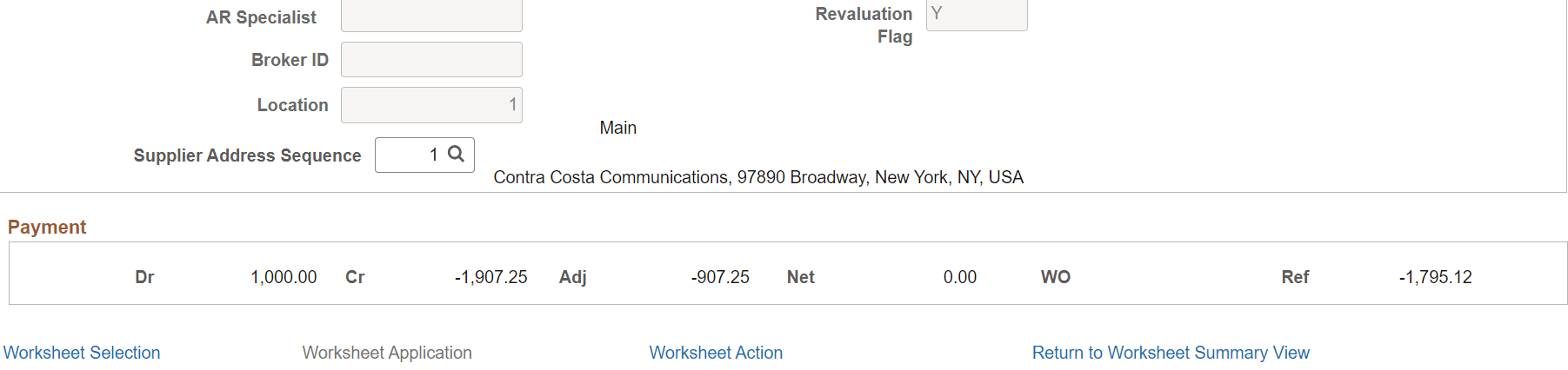

Balance
The system updates the balance information when you click Go or Refresh, or you save the worksheet. You must have a zero balance before you can post the worksheet.
Dr (debit)
Displays the total of positive amounts.
Cr (credit)
Displays the total of negative amounts.
Adj (adjustment)
Displays the amount of new debit and credit pending items that you created.
Net
Displays the remaining or unmatched amount for selected items (debits – credits + adjustments).
WO (write-off)
Displays the total of both item and remainder write-offs.
Ref (refund)
Displays the total of refunded items.
Use the Worksheet Application Detail View page (WS_WORKSHT_IC_DTL) to view or change details about a selected item on a worksheet. Write off a remaining balance for the worksheet.
Navigation:
Click the View Detail icon on the Worksheet Application page or the Worksheet Group View page.
This example illustrates the fields and controls on the Maintenance Worksheet - Worksheet Application Detail View page (1 of 2). You can find definitions for the fields and controls later on this page.
This example illustrates the fields and controls on the Maintenance Worksheet - Worksheet Application Detail View page (2 of 2). You can find definitions for the fields and controls later on this page.
Item Balance
To partially take action on an item, change the amount and click Edit to update the worksheet balance information.
Entry Type and Entry Reason
Select the entry type and reason for the activity.
Location
Enter the address sequence number for new items. You must enter a value in this field to include the item in correspondence if you selected the Item Address option for the correspondence customer on the Correspondence Options page.
Supplier Address Sequence
Displays the default remit to address from the supplier location in Payables. You can accept or override the default value. A prompt view provides a list of valid values for the supplier, from which you can choose. The valid address sequence numbers are specific to each supplier ID. The Supplier Address Sequence field is available when you use one of these actions: Refund a Credit (MT-09) or Refund Remaining Credit (MT-08). The selected Supplier Address Sequence is added to the item details and the refund process passes the value to Payables.
Document
If you are applying the payment to a vendor rebate claim item or claimback item that is derived from PeopleSoft Purchasing or PeopleSoft Order Management, you must enter a reference ID. When you run the Rebate Notification process, it sends the reference ID to PeopleSoft Purchasing and PeopleSoft Order Management to use to reconcile the claims on the claims management workbench.
This field is available for existing items only if you enter entry reasons on the AR Integration page.

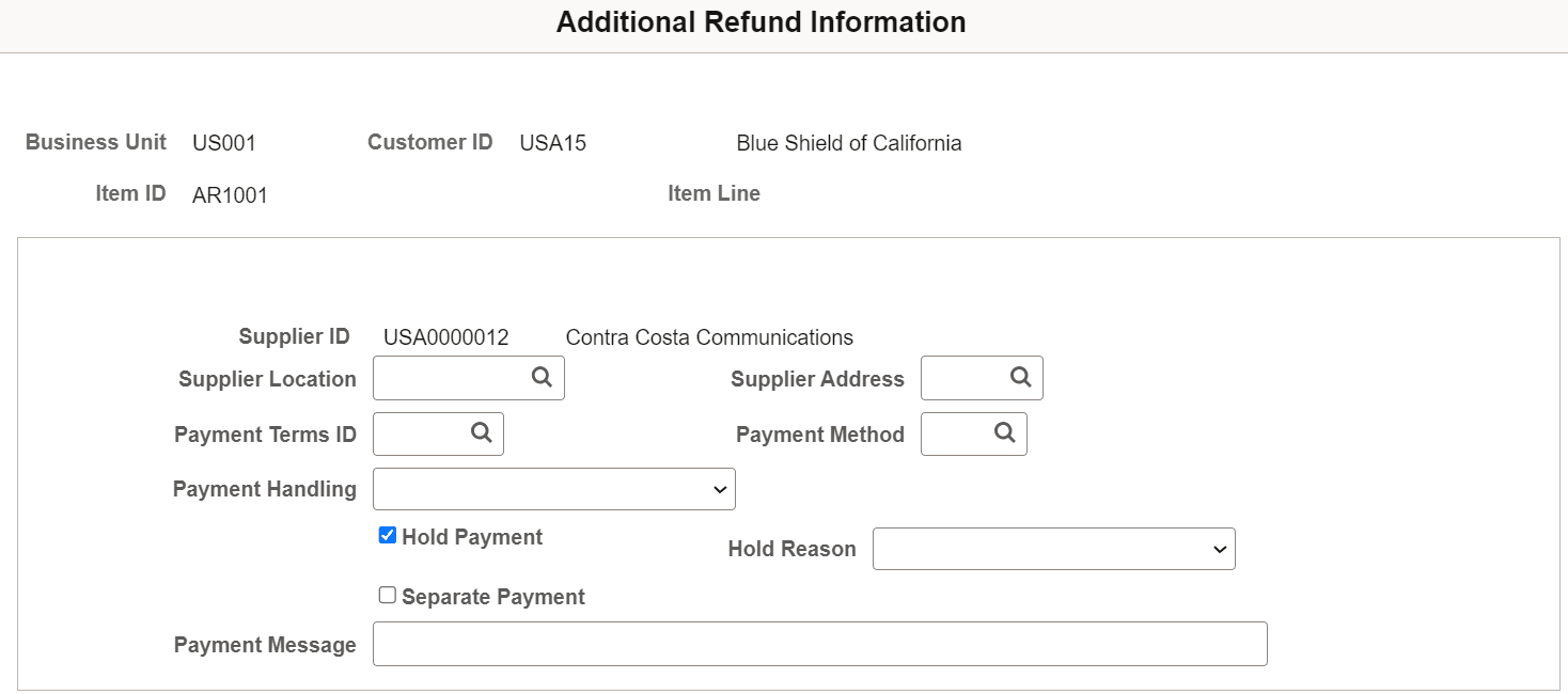

Additional Refund Information Page
Click Additional Refund Information link to update additional refund information. Additional Refund Information link is available only if Entry Type is RC (Refund a Credit) or RRC (Refund Remaining Credit). Similarly, the link is not available for single payment suppliers.
Fields or controls and descriptions for Additional Refund Information page.
Hold Payment check box is not available if Payment Method is Manual (Manual Check). An error message is displayed if any of these payment methods EFT, ACH, BEF or GE are selected, and a bank account is not set up for the supplier.
To view the additional refund information after the Maintenance group is posted, you can use the Posting Results components. The Additional Refund Information link is available on the Pending Item 1 tab for Maintenance groups with refund transactions only. For additional information, see Reviewing Posting Results.

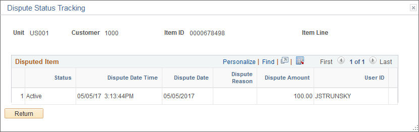

Dispute Status Tracking Page
Use the Dispute Status Tracking page (ITEM_DISP_T) to view dispute status information for an item.
Click Dispute to access the Dispute Status Tracking page and view dispute status information for an item.
This link appears only when dispute tracking data exists for the item.
This example illustrates the fields and controls on the Dispute Status Tracking page.
To save your changes, return to the Worksheet Application or Worksheet Group View page.
