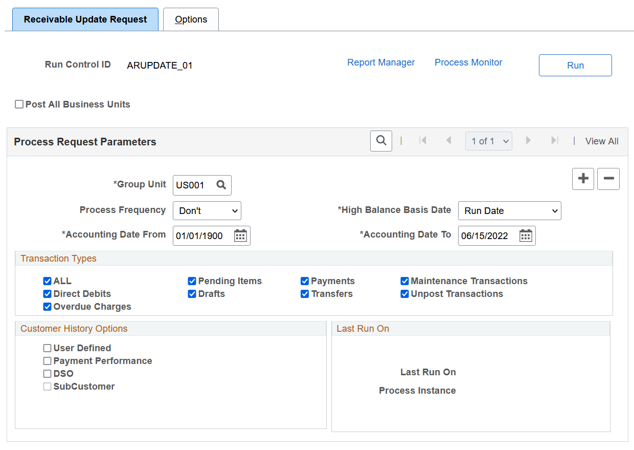

Receivable Update Request Page
Use the Receivable Update Request page (POSTING_REQUEST) to enter run parameters for the Receivables Update process for specified business units and run the process.
Navigation:
Accounts Receivable, and then Receivables Updates, and then Request Receivables Update, and then Receivable Update Request
This example illustrates the fields and controls on the Receivable Update Request page. You can find definitions for the fields and controls later on this page.
Field or Control Description
Post All Business Units
Select this check box to process all business units that have transactions to post.
When you select this check box and save, the page updates to include all the business units with transactions to post. The page automatically adds new rows for each business unit. The accounting from/to dates update to 01/01/1900 and the current date, respectively. In addition, all transaction types are selected.
Note: If you select this check box and save, existing run control values are deleted.
Group Unit
Enter the business unit of the group that you want to post.
High Balance Basis Date
Select the date to use when calculating the customer history ID of HI_BAL_AMT. Options are:
Run Date: By default, the Receivables Update process uses the run date.
Calc Date (calculation date): Select if you want HI_BAL_AMT to be calculated as of the calculation date. The Receivables Update process then uses the calendar ID on the Receivables Options - Options 1 page to determine the calculation date.
Accounting Date From and Accounting Date To
When the system scans the database, it looks at the group accounting date for each group that is set to post to determine whether it falls in the date range that you specify here. If the effective date on the General Info page for a customer is outside the range of the accounting dates, the system does not select pending items to be posted for a customer.
Transaction Types
Select All to include all transaction types in Receivables Update processing. The default setting is to process all transactions.
You can also select one or more transaction types from these options:
  • Pending Items
  • Payments
  • Maintenance Transactions
  • Direct Debits
  • Drafts
  • Transfers
  • Unpost Transactions
  • Overdue Charges
User Defined
Select to update the history elements that you established on the User Defined History page. For example, if you use the user-defined history of SALES, sales history is calculated for the year and period defined by the accounting date of the activity.
Payment Performance
Select to update the system-defined history IDs for average days late, weighted average days late, weighted average terms, and weighted average days paid.
DSO (days sales outstanding)
Select to update both DSO30 and DSO90. SALES history is also included because DSO calculations use the sales figures updated as part of user-defined history. If you run DSO without calculating SALES history, no sales figures will be available.
Calculation Year and Period
If you select DSO, these fields appear. You can change the settings on the Receivables Options - Options 1 page.
SubCustomer
If you select DSO, this field appears if you selected either Use Both or Use 1st in the SubCustomer Usage field on the Installation Options - Overall page. This option updates history at subcustomer levels for all customers in the business unit who have subcustomer history enabled.
If you do not want to use DSO30 or DSO90, use the System-Defined History page to make these customer history IDs inactive.
The run control ID that you used to access this page is linked to your user ID. When you add a Receivables Update request, the system creates an Application Engine request for you with the same user ID and run control ID combination, specifying AR_PGG1 and AR_POST1 as the processes. If you want to add options to other parallel processes, you must add them separately.

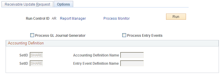

Request Receivables Update - Options Page
Use the Request Receivables Update - Options page (POSTING_OPTIONS) to select optional processes to run and specify an accounting entry definition for the Journal Generator process and an entry events definition for the Entry Events Generator process.
These options apply to all business units processed by the run control.
Navigation:
Accounts Receivable, and then Receivables Updates, and then Request Receivables Update, and then Options
This example illustrates the fields and controls on the Request Receivables Update - Options page. You can find definitions for the fields and controls later on this page.
Process GL Journal Generator
Select to run the Journal Generator process, which generates the journals for the general ledger when the Receivables Update process finishes. If errors occurred in the accounting entries, the process will not process the entries.
Process Entry Events
Select to run the Entry Events Generator process as part of the Receivables Update process. This field is available only if you selected entry events during installation.
SetID and Accounting Definition Name
Select the accounting entry definition that the system should use when it creates the journal header and lines, such as ARDEFN. These fields are available only if you selected the Process GL Journal Generator field.
SetID and Entry Event Definition Name
Select the entry event process definition for the system to use when it creates supplemental accounting lines, such as ARUPDATE. These fields are available only if you selected the Process Entry Events field.

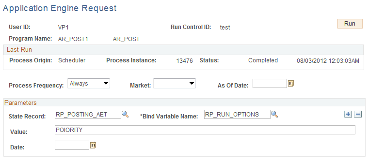

Modifying Steps for AR_POST
Use the Application Engine Request page (AE_REQUEST) to modify the steps for a run control ID for AR_POST#.
Navigation:
Accounts Receivable, and then Receivables Update, and then Request Application Engine, and then Application Engine Request
This example illustrates modifying run parameters for the AR_POST1 process on the Application Engine Request page.
Modifying run parameters for the AR_POST1 process on the Application Engine Request page
Enter the name of the appropriate AR_POST# program, such as AR_POST1.
Use the State Record, Bind Variable Name, and Value fields to define exactly what data to post. This enables you to process smaller units of data. Add as many rows as needed.
Setting PRIORITY Parameters
Enter PRIORITY in the Value field to give priority to groups whose posting action is Batch Priority. PRIORITY is designed to run on a recurrence definition that directs the system to run periodically throughout the day to pick up only new priority groups. You define recurrence definitions by using the Process Scheduler when you indicate how often to run the Receivables Update process (for example, hourly, or daily).
The following table describes PRIORITY and provides sample field values.
Description Sample Field Values
Run PRIORITY as needed.
Suppose that you have 10 business units and 5 different run control IDs, each specifying different combinations of business units by user ID. During the day, you want to post groups set to PRIORITY for any of the 10 business units.
To do this, add a Receivables Update request with a new run control ID (for example, URGENT) that specifies all 10 business units. Add the PRIORITY run option as a parameter on the Application Engine request for the run control ID you created by adding an additional line.
Program name: AR_POST#, such as AR_POST1
State record: RP_POSTING_AET
Bind variable name: RP_RUN_OPTIONS
Value: PRIORITY
Note: After you enter the run parameters, assign the Receivables Update request to a Process Scheduler job with a scheduled run recurrence that runs every hour (for example, HOURLY). By selecting the hourly recurrence and initiating this job, direct the system to process all PRIORITY groups each hour for each of the specified business units.
You can set up multiple PRIORITY server jobs to run at different intervals, processing a few business units in each job or processing only certain group types.
You do not need to set up an RP_RUN_OPTIONS for a Batch Standard run control. With standard processing, the system processes groups with either a Batch Priority or Batch Standard posting action. A standard scheduled job processes any priority groups that have not been processed since the last scheduled PRIORITY run.

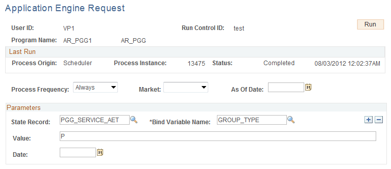

Modifying Steps for AR_PGG
Use the Application Engine Request page (AE_REQUEST) to modify the steps for a run control ID for AR_PGG#.
Navigation:
This example illustrates run parameters for AR_PGG1 on the Application Engine Request page.
Viewing run parameters for AR_PGG1 on the Application Engine Request page
Enter the name of the appropriate AR_PGG# program, such as AR_PGG1.
You use the State Record, Bind Variable Name, and Value fields to define exactly what data to process. Add as many rows as needed.
This table shows how you can narrow the scope of what the process posts.
To generate accounting entries for only group type P.
State record: PGG_SERVICE_AET
Bind variable name: GROUP_TYPE
Value: P
Add a parameter to specify the chunking method. You are limited to chunking by one field only, but you are not limited to specific values.
Bind variable name: AE_CHUNK_BY
Value:
  • BU: One business unit at a time.
  • TYPE: One group type at a time across all business units requested.
  • BU_AND_TYPE: One group type at a time, one business unit at a time.
