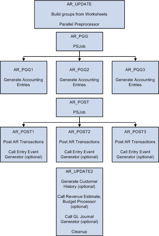

PeopleSoft Receivables enables you to break up the data that Receivables Update processes into multiple pieces (partitions) to be processed in parallel, achieving higher performance. You initiate the parallel processes by using a single run control, and the process automatically divides the work between the number of partitions that you specify in your setup.
The Receivables Update multiprocess job (ARUPDATE) includes:
  • The AR_UPDATE Application Engine process.
  • The AR_PGG multiprocess job.
  • The AR_POST multiprocess job.
  • The AR_UPDATE2 process.
The ARUPDATE multiprocess job also includes the Revenue Estimate process and the Budget Processor process. The AR_UPDATE2 process calls the Revenue Estimate and Budget Processor processes if you have enabled commitment control for PeopleSoft Receivables and the business unit. The AR_UPDATE2 process also calls the Journal Generator process if you select the Process GL Journal Generator field on the run control. You cannot divide the work for these processes into multiple partitions.
This diagram illustrates how the Receivables Update (AR_UPDATE) process works if you have three partitions. The process builds groups from worksheets and the parallel preprocessor partitions one job into three jobs to create accounting entries. AR_POST runs and posts the transactions for each job and calls the Entry Event Generator, if applicable. Receivables Update can then optionally generate customer history, call the Revenue Estimate and the Budget Processor process if Commitment Control is enabled, and call the GL Journal Generator. Finally, the Receivables Update process performs cleanup.
How the Receivables Update (AR_UPDATE) process works if you have three partitions

The AR_UPDATE process is the first process that is run within the ARUPDATE job. The AR_UPDATE process acts as a preprocessor for the actual AR_PGG and AR_POST processes and does these tasks:
  • Builds groups from all worksheets set to post.
  • Identifies all groups set to post.
  • Partitions the data between all the child parallel processes for both AR_PGG and AR_POST.
The distribution of data among the child parallel processes is based on the composition and volume of the data. The process considers which groups are eligible for Receivables Update, based on the standard Receivables Update run control, and automatically partitions the data.

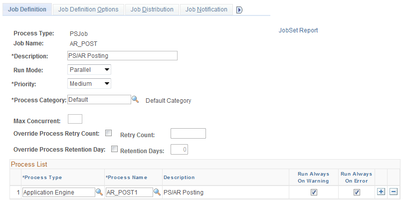

Adding More Parallel Processes to the AR_PGG and AR_POST Multiprocess Jobs
Use the Job Definition page (PRCSJOBDEFN) to add Pending Group Generator and Posting process definitions to the AR_PGG and AR_POST multiprocess jobs.
Navigation:
PeopleTools, and then Process Scheduler, and then Jobs, and then Job Definition
This example illustrates the fields and controls on the Job Definition page.
Job Definition page
Field or Control Description
Process Type and Process Name
Select Application Engine for the type and select AR_PGG or AR_POST for each separate partition or process that you want to run. The processes must be defined in the job sequentially; for example, AR_POST1, AR_POST2, AR_POST3. A job definition of AR_POST1, AR_POST2, AR_POST5 is incorrect. If you define additional process definitions, select the name of the definitions that you added.
Note: You must have the same number of rows in the process list as you enter in the Maximum Partitions field on the AR parallel Processing Options page.
Run Mode
Always select Parallel.
Run Always on Warning and Run Always on Error
You must select these check boxes.
