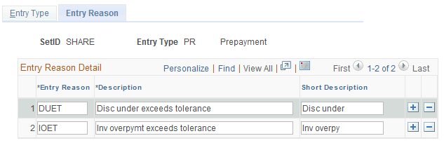

PeopleSoft delivers these entry reasons:
Term Definition
IOIT
Invoice Overage Within Tolerance.
IUIT
Invoice Underage Within Tolerance.
DOIT
Discount Overage Within Tolerance.
DUIT
Discount Underage Within Tolerance.
IOET
Invoice Overage Exceeds Tolerance.
IUET
Invoice Underage Exceeds Tolerance.
DOET
Discount Overage Exceeds Tolerance.
DUET
Discount Underage Exceeds Tolerance.

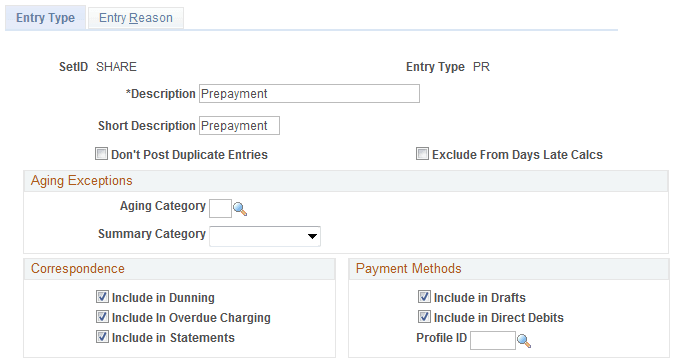

Entry Type Page
Use the Entry Type page (ENTRY_TYPE_TABLE1) to create and define entry types.
Navigation:
Set Up Financials/Supply Chain, and then Product Related, and then Receivables, and then Options, and then Entry Type, and then Entry Type
This example illustrates the fields and controls on the Entry Type page. You can find definitions for the fields and controls later on this page.
Entry Type page
Field or Control Description
Don't Post Duplicate Entries
This check box handles:
  • Timing: An adjustment to an invoice is posted before the invoice.
  • Duplication: Two entries with the same entry type attempt to update an item.
Select when you post a subsequent event—such as a debit memo or a credit memo—that has the same business unit, customer ID, item ID, and item line as the invoice before you post the invoice. This occurs if:
  • You are converting closed item detail from your previous receivables system.
  • The feeder billing systems cannot guarantee sequencing.
  • Your business often generates related transactions such as an invoice and a credit memo together.
Normally, the system creates an Item record for each new item with its entry type. Subsequent entries create item activity lines but do not alter the entry type on the Item table (PS_ITEM). If the original item is a debit or credit memo instead of an invoice, then the debit or credit memo entry type will be on the Item record. What you really want is the invoice entry type.
You need to have the appropriate entry type on the Item record, because entry types determine aging redirection, correspondence inclusion, and weighted average days late calculations. If a prepayment or credit memo posts first and the invoice posts second, you need to update the Item record with the entry type and date of the invoice.
Selecting the Don't Post Duplicate Entries check box for an entry type means that:
  • The entry type takes precedence over whatever entry type exists on the Item record (unless the entry type on the Item record also has the option selected).
    Selecting this check box enables you to use the invoice entry type as the controlling entry type, even though the invoice was not posted first. Select only for those entry types that represent an invoice.
  • After you post a pending item, other pending items with this selected option are not posted against this item, because any given item can have only one dominant pending item.
  • The system catches duplicate invoices for a particular business unit or customer combination.
    The Receivables Update process does not post a second pending item that also has the option selected against the same business unit, customer ID, item ID, and item line combination.
Note: Be sure that you select this check box only for invoice type or dominant transaction types and that only dominant entry types can be posted against an item.
Exclude From Days Late Calcs (exclude from days late calculations)
Select to exclude items with this entry type from history calculations for average days late and weighted average days late.
Aging Category
Enter an aging category in which to place items, rather than aging them normally.
Note: If you define a rule for aging deductions, disputes, or collections in an aging ID other than aging normally, that rule takes precedence over a category that you select here.
Summary Category
Select a summary category to place items in a different summary category from the one associated with the aging category.
Include in Dunning, Include in Overdue Charging, and Include in Statements
Select to include items with the entry type in dunning letters, on overdue charge invoices, and on statements. In the delivered system, all entry types are included; deselect the check boxes to exclude those that you do not want to appear in correspondence. This applies only to the entry type on the item itself, not to item activities.
Include in Drafts, Include in Direct Debits, and Profile ID
Select to include items of this entry type in drafts and direct debits. If you select Include Direct Debits, enter a profile ID to use a specific direct debit profile for all items using this entry type. Otherwise, leave Profile ID blank to use the profile ID assigned to the customer. If you enter a profile ID, you must select the Use Entry Type field on the Direct Debit Profile page.
Entry Reason Page
Use the Entry Reason page (ENTRY_TYPE_TABLE2) to specify the appropriate entry reasons for an entry type.
Navigation:
Set Up Financials/Supply Chain, and then Product Related, and then Receivables, and then Options, and then Entry Type, and then Entry Reason
This example illustrates the fields and controls on the Entry Reason page.
Entry Reason page
For each entry type that you define, you can set up as many valid entry reasons as needed.
