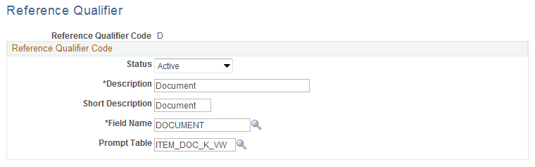

This example illustrates the fields and controls on the Reference Qualifier page. You can find definitions for the fields and controls later on this page.
Field or Control Description
Field Name
Select a field from PS_ITEM_ALL_PVN_VW that the remittance information references.
Prompt Table
Select a prompt record for the reference qualifier code, which the system uses to display an appropriate list when a user prompts on the field online.
